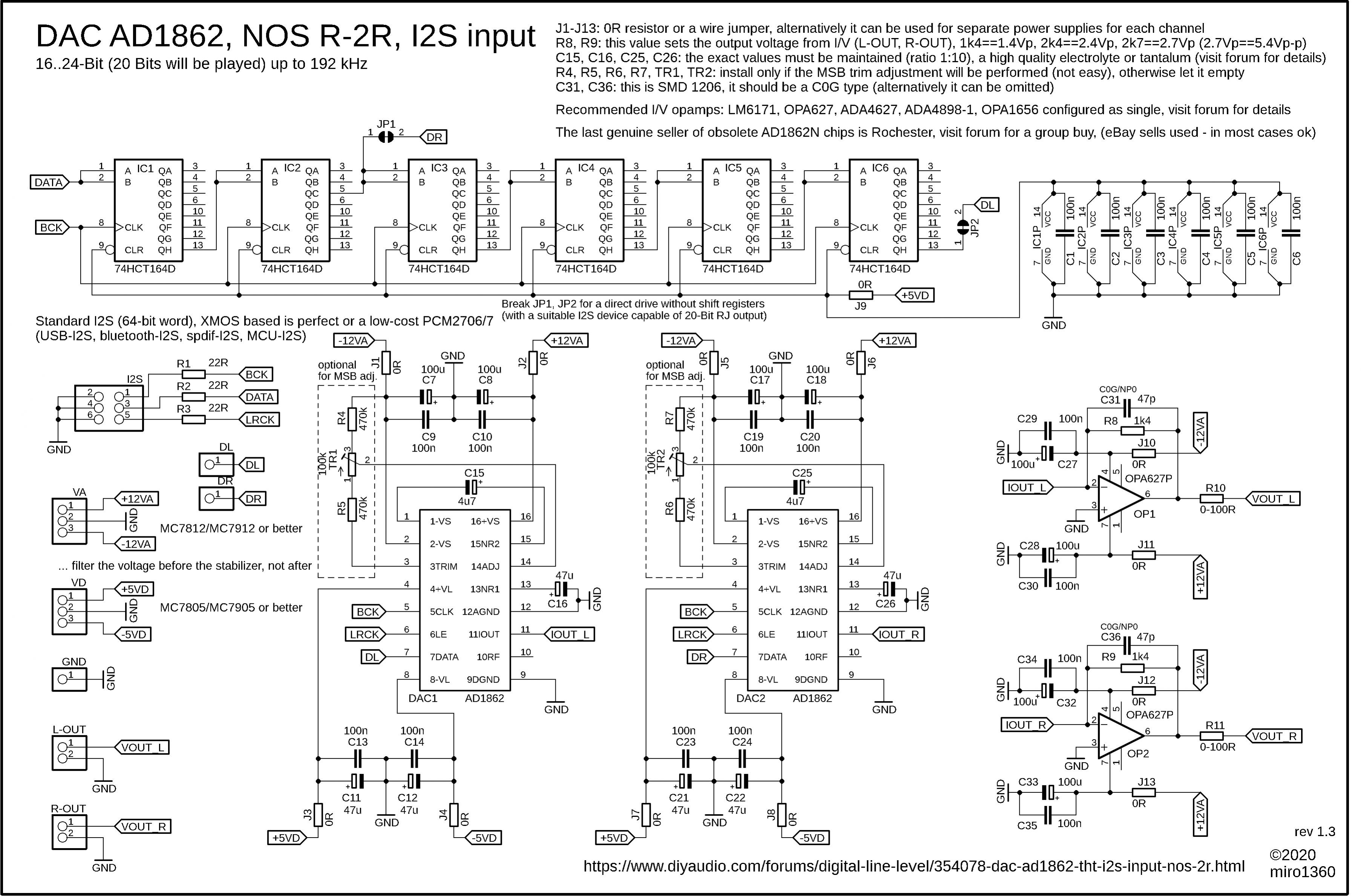

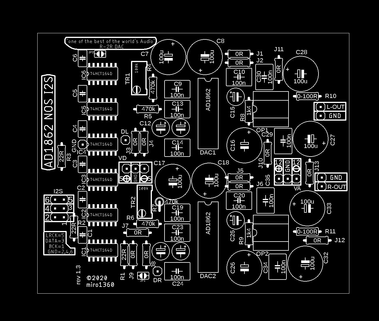

PCB v1.3 (pad)
The same as PCB v1.3 in post #1278, except:
- the Vout pin on I2S header is removed (@diyiggy)
- added pins for a direct drive without shift registers with a suitable I2S converter (break JP1, JP2) (@Vunce)

Nice, so you left connected pads so we can just scrape off if we decide to not use shift registers.... thanks
Exactly, for direct drive just break JP1,JP2 (if shift registers are mounted).
If on initial decision it will be without shift registers (no shift register is mounted) than nothing needs to be breaked because there would be no conflict 🙂
Many thanks Miro, just one ideia, it could be made with a jumper instead cutting the traces? It is easier to test both options.. what do you think?Exactly, for direct drive just break JP1,JP2 (if shift registers are mounted).
The blob of solder is good solution.
Or cut the jumper and solder a 1.27mm pin header directly on the small pads and use a 1.27mm jumper (carefully, the pad can be fragile under mechanical stress).

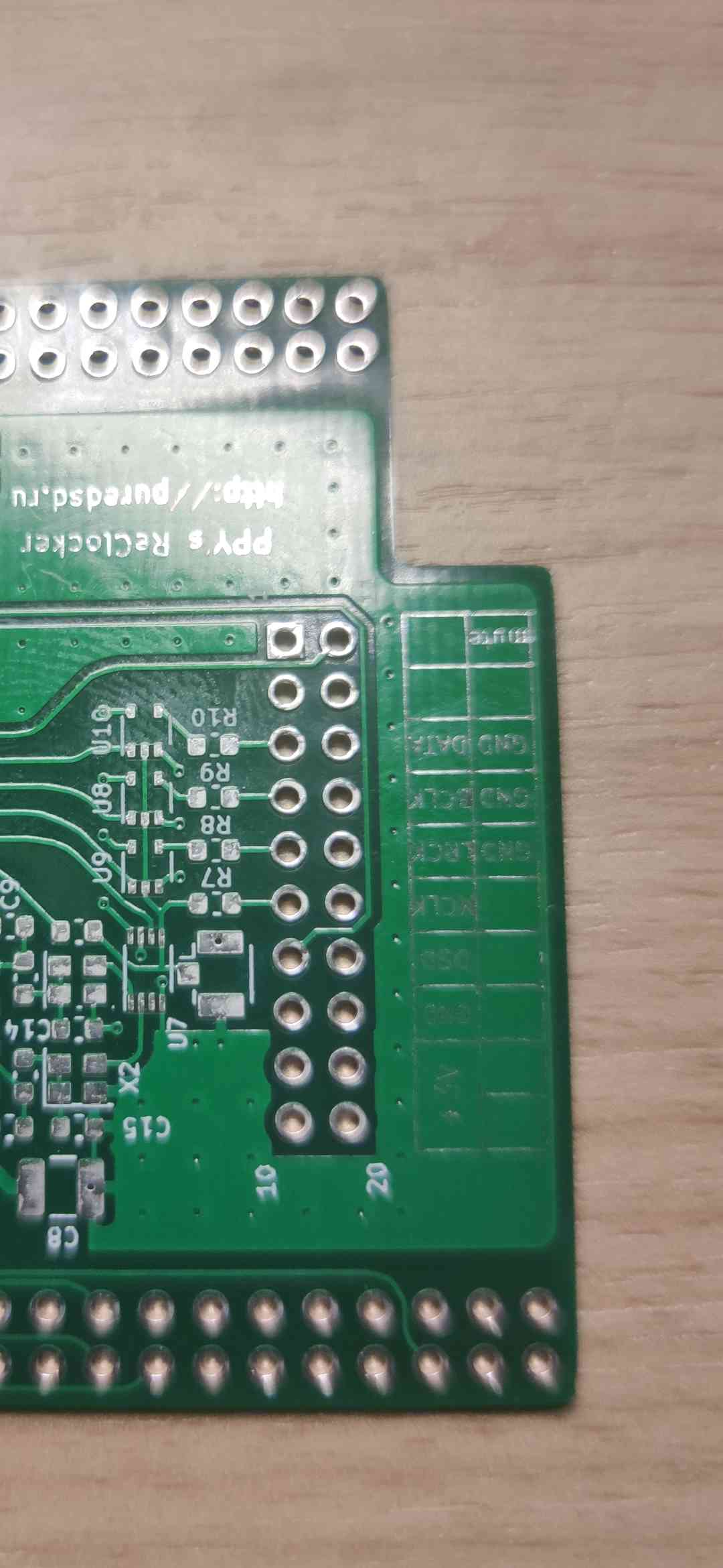

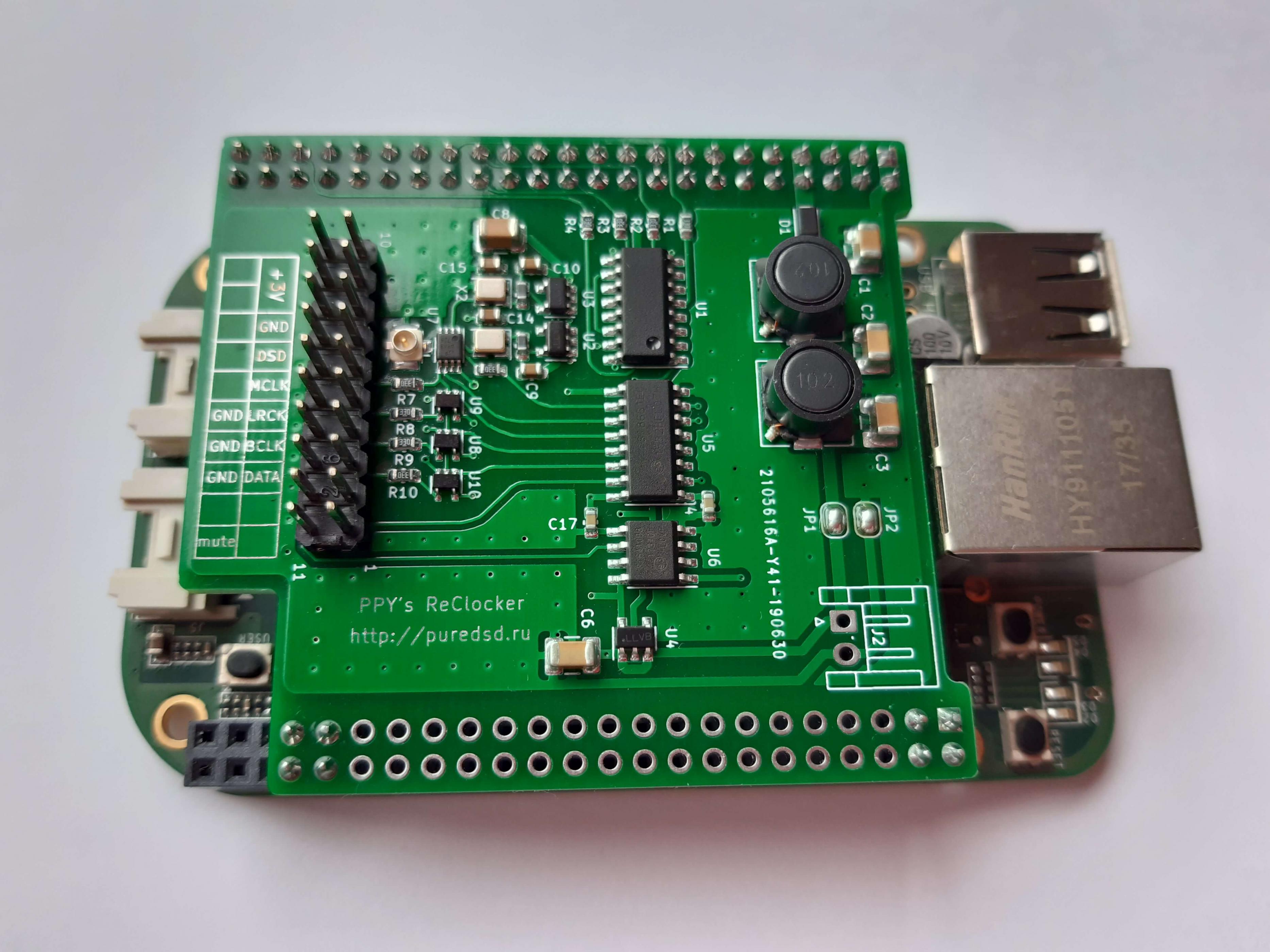

Thank you for the updated board. Sorry for being clever. Maybe there is still an opportunity for you to redo and update the post. It is not enough that the contacts are in the order DATA - BCLK - LRCK, as on the Amanero block and other transports. This implementation will give several positive points:
1. You can get rid of the wires that go from the transport to the DAC board. And clip your transport directly to the board.
2. Anyone will be able to assemble a reclocker of high quality, freely available and not expensive to manufacture.
3. This reclocker is made for and works great with BBB (Beagle Bone) minicomputer, the firmware is debugged and works very well too, the firmware works with HQP, ROON, Tidal, MPD and other network services.
It is clear that this reclocker can be hooked up with wires, but this will not be due to perfectionism).

Just move to 5 PIN - DATA
for 3 PIN BCLK
and 1 PIN LRCK
well, it is advisable to move the PIN block to the middle of the side on which it is located so that the reclocker is in the middle, although it can be adjusted in this position too.
for 3 PIN BCLK
and 1 PIN LRCK
So that something like this can be used to fasten the DAC to the reclocker
There will be a bomb! No USB, BBB is galvanically isolated from LAN and PC respectively. The firmware is cleaned up for a minimum load on the BBB, so that we feed it and we get it on the DAC.
Well, plus, people will be able to fasten Amanero, XMOS transports wirelessly.

Since your in a “giving” mood, I’ve got another idea....
If not to much of a hassle, Maybe add SOIC8 SMD pads inside the DIP8 footprint so smd opamps can be soldered directly instead of using adapter pcb and socket.
Or just file my idea in the garbage can, LOL
