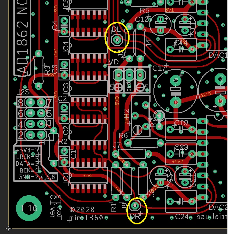

Don't install shift registers and feed chips directly (wires can be installed directly on SMD pads). #538
@diyiggy
Nice experimenting, so you finally took the solder gun 😀
There can be tons of improvements 🙂
It is voltage output pin, you can feed additional digital circuitry from it.
>>Could it be usefull to make a list of I2S streamers able of these 64 bits
>>So Xmos chips are proof ?
XMOS with good clock is perfect. A list can be created 😀 @nano35 is intensively testing the RPI, @RickRay tested a Toslink to I2S #1213
Hi Vunce, do you mean like this?

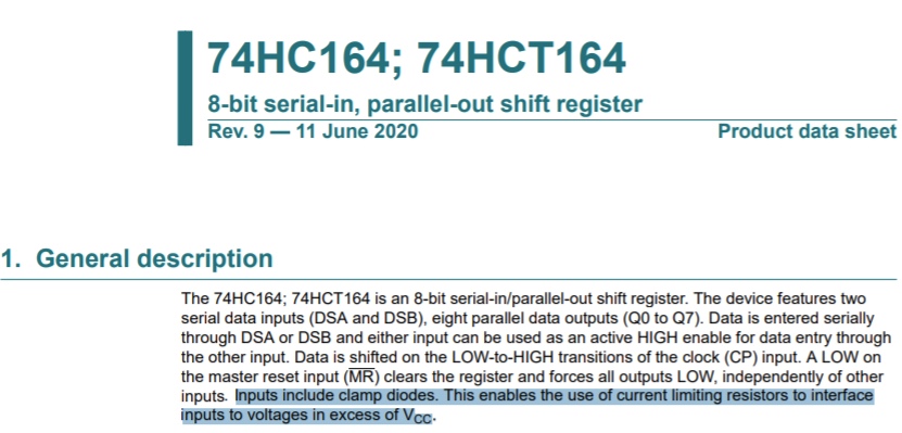

Hopefully the output of shift register can stay connected during the use of external pin 😕
edit: It can't be ... there must be a switch or break on the wire to disconnect it from shift register 😀
Yes, hopefully you will be able to keep the shift registers soldered on the board and not disturb them, if you disable the power to the shift registers and then used the direct feed through hole pads, I think that should work?
A switch could be wired in series with the jumper provisions to interrupt power.

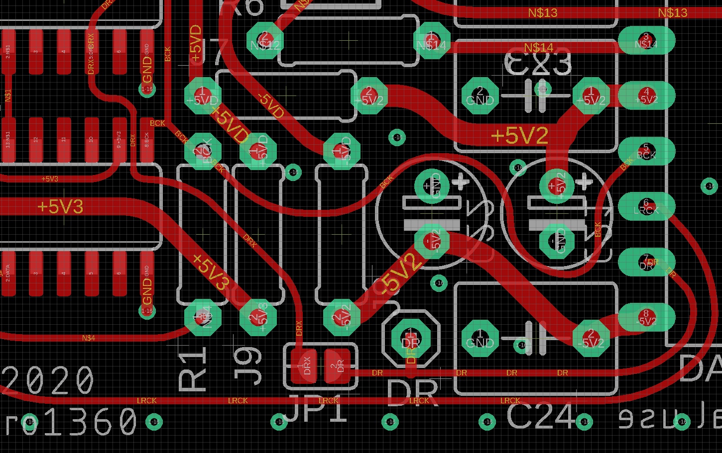

I know we ask a lot and I'm thankfull for all the sharing here, but have you considered the same little board that is already fine, but with an opa 861 transimpedance stage for the I/V (no feedback, very few parts though smd are better for the caps but not always mandatory for stability depending on the powersupply quality and a further aop, double this time and I strongly think about an opa 1656 here (there smd and vias for decoupling being important imo for tweaking-adaptation taste purpose) ? While it coul be still be 627pb with two single pads !
What soft are you using please... I really should try to draw one... but the time...
now my main concern is about the lack of I2S uf-l just cause I'm lazy and also the jumpers between the dac chips and the front-end, mainly cause the soldering problems that are more harmfull that one believes imo.
>> is it not to close of the fragile Lrck input ???
Digital portion is not so sensitive 🙂
>> have you considered ......
I would like to see someone creating a similar replica of this DAC, but on his own path - Road 861 :Pawprint:
I used Autodesk Eagle ... such a hobby toy 😱
>> now my main concern is ....
"My recommendation: Start cheap and continue with improvements later." 😀
hard to see with multiple layers design and bad eyes : so the two grounds (5V and I2S) are not shared close their gnd vias ? (it was what worried me but maybe it should not).
I remember also a Ti note about a neutral filer copper trace (not grounded) between two HF ground for avoiding lateral bouncing... while I don't know if it matters here. Example : Signal Ground Neutral then SGN then SGN in the illustration of an I2S signal (in fact to avoid lateral bouncing of two active lines on the same ground line. I assume a spacing to avoid that as well, hence my worry about seing a so close 5V signal & ground
I just should avoid two close such different grounded signals if it were sharing the same reference but it's certainly not tied on the same ground plane as you talk of underneath return path ?
It's also illustrate why I don't like 3D jumpers for HF signals (plus the soldering that is never good even on analog signals). Again 'm suspicious but perhaps it doesn't harm ?
