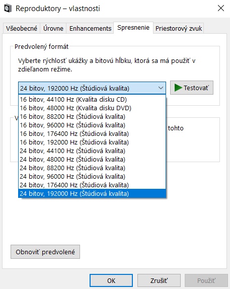

I mean, if I raise 44.100 to 192 20 bits using HQPlayer, the DAC under discussion will receive a signal? So it won't work like a NOS DAC already?

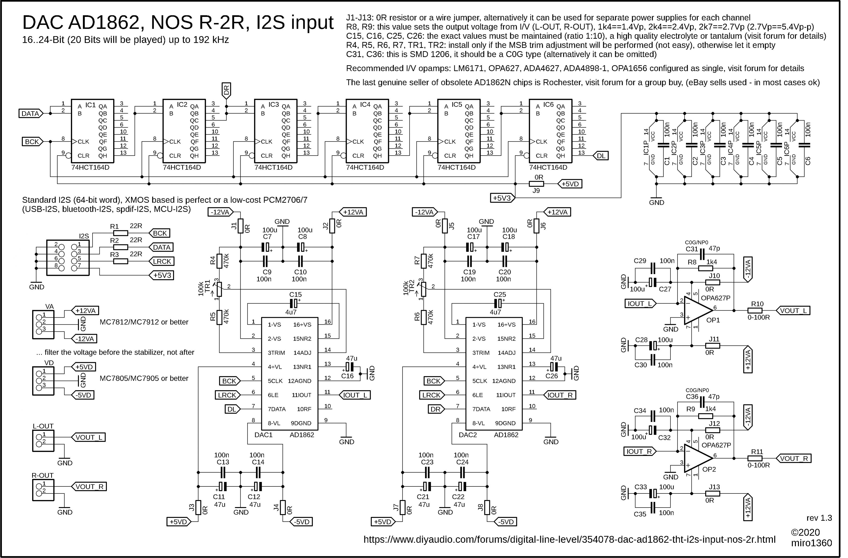

IC1 - IC6
I noticed that Mouser offers two versions of this shift register:
771-74HCT164D-T - Propagation Delay Time:20ns
771-HCT164D652 - Propagation Delay Time:36ns
I don't know anything about shift registers. What is the preferred one for this application? Thanks.
Yes. Short response.
I rephrase: You can and it can, but there is no interest in such oversampling process.
You can not create bits & samples that does not exist in the recording.. bits 17 to 20 will be filled with zero, and the up-sampling frequency of a 44.1 or 48 k hz recordings will be not improved by such process. You will have better sound with NOS or close if native in the reccordings , above 96 K Hz sampling rate I'm not sure you can hear a diference. I even really don't hear one between 44 & 88 K hz. Most difference are aware. The slower the crystal the better. Up to you to have or not the USB to I2S player that can read up to 192 K hz (all do that) or even greater up to 384 K hz . Is it usefull in term of SQ ? No, not really seing at the adc chips involved in the reccord process nowadays. (for the rare recordings and studios that makes true Hi res mixing and reccordings...)
Difference is only in the packaging (Cut tape, Tube). Both have the same Propagation Delay, only a mouser worker wrote it different
You can use 74AHCT164D,118 which is even faster.
I am currently testing if 74HCT164D can handle 192kHz on this DAC, if not then I will test with faster 74AHCT164D.
I am currently testing this DAC on 192kHz with XMOS (standard I2S) and it works flawlessly. 74HCT164D shift registers are installed.
74AHCT164D are even faster, but I have zero experience.

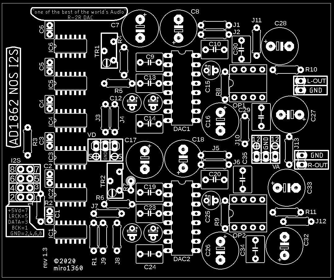

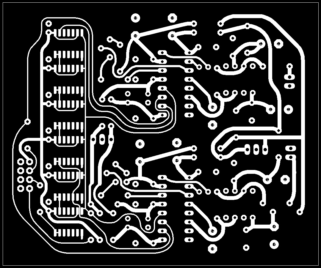

PCB v1.3
Ok guys, here is the PCB version 1.3 ... size is the same, function is the same, except:
- more space for bigger audio capacitors
- I2S input has more GND pins for each signal
- C37, C38 is removed from the PCB
Double check it, because this PCB is untested and an editing error may have occurred

few ideas
C10 & C19 inversed printing on my v2 , dunno on the v3
What could be cool is smd pads for 0.1uF 0806 CD FCA caps size with vias in the middle of it for the ones liking radial MKP more ?
keeping both 0.5 mm & 1 mm legs pitch at the same time everywhere for caps ? ... and a little headroom more for the pitch legs for the 1k5 aop resitor ?
ufl pads + vias for the I2S ? with SGSGSG arrengement for the ones using fifoPi or else boards gaving just uf-ls
suppressing 0 ohms straps for the digital signal till the dac chips with using the layers instead ?

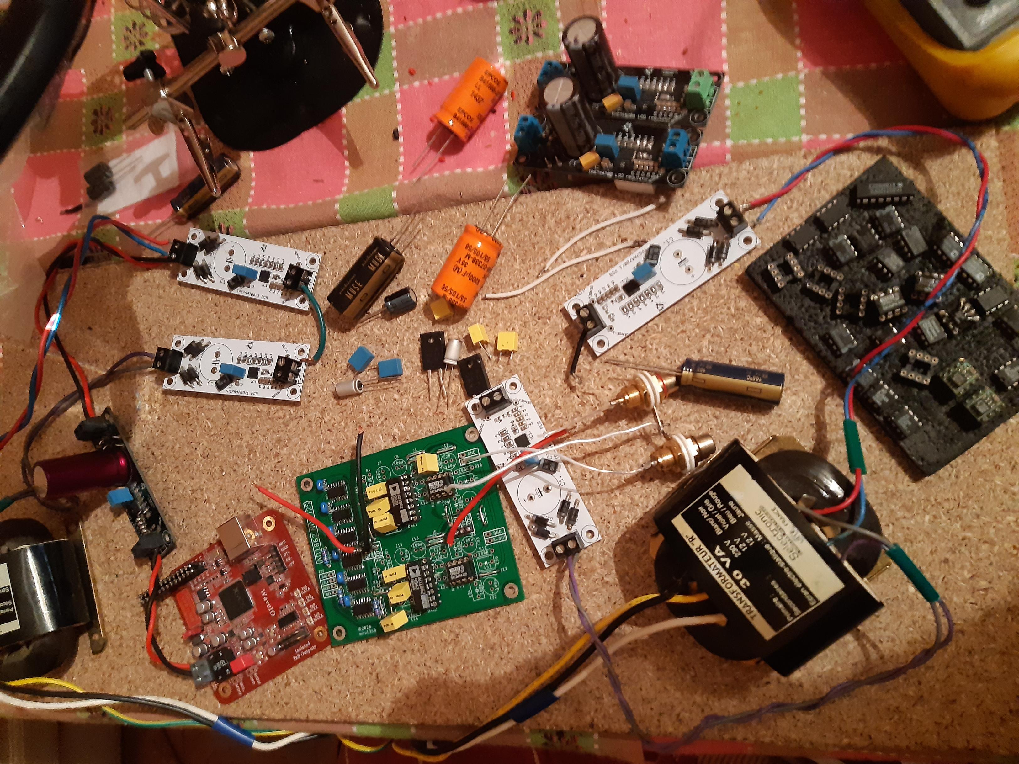

Just asking as it s a new year ... going to show my experimenting Miro's version for the porn...
