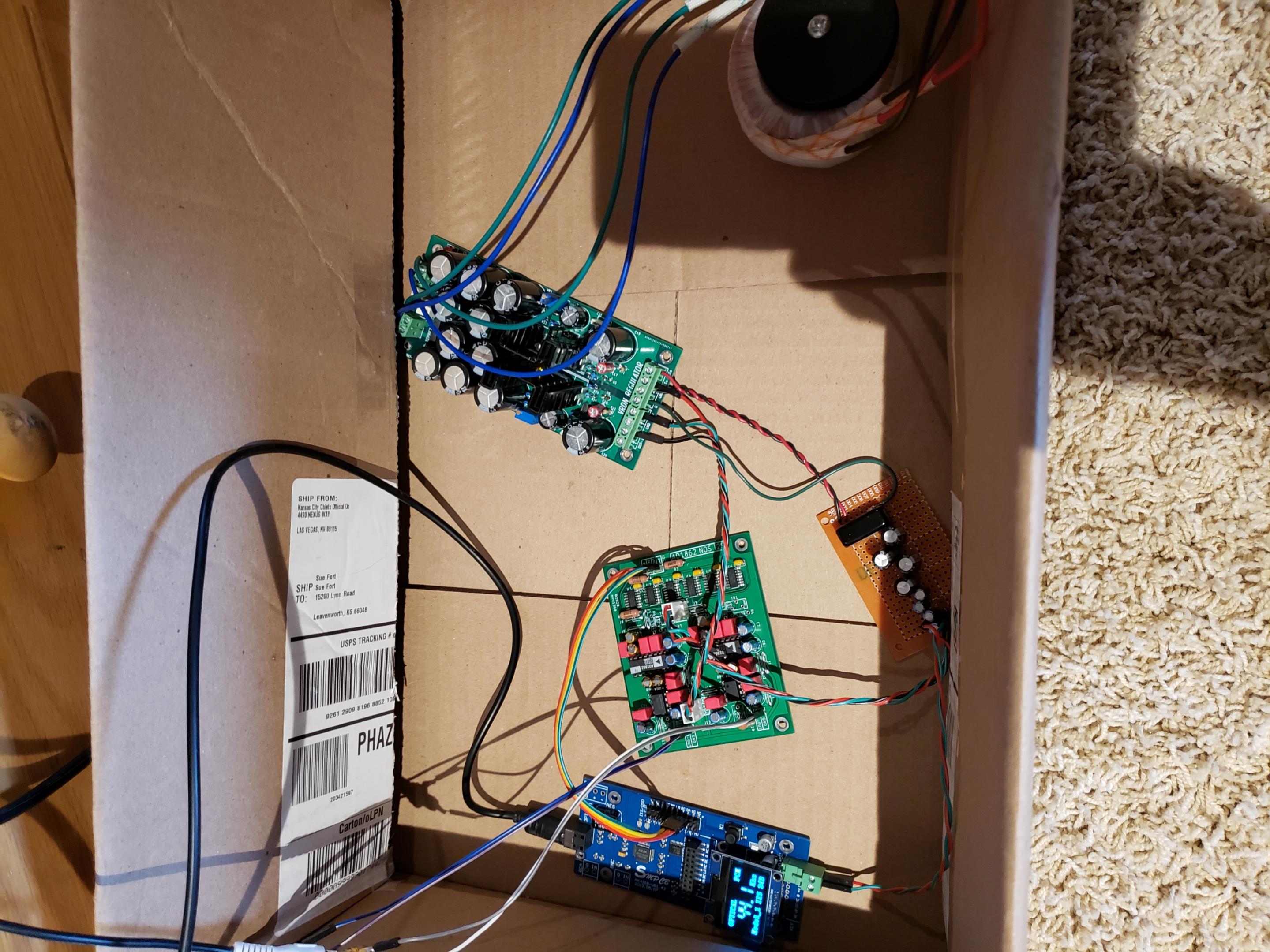

I had the volume up at a nice level and when Bruce Springsteen came on, one of hos songs has a quite loud harmonica. I felt myself getting ready to wince, because most the time those types of sounds are shrill and fatiguing. Right when it would have been shrill, I notice it isn't, it leaves out the shrill part and just includes the nice harmonics, like in person.
NO, I did not expect this from this easy of a project, my wife appreciates it also, she noticed a very dramatic change. I turned the stereo off to watch football and she asked why I turned it off, that NEVER happens.
Thanks so much for this very nice project. I'll try some different opamps, I'm using NE5534 as the base, as soon as the rest come in.

@Micro1360,
without the 47p cap and do I need the jump on C36 ad C31 location
and any negative effect if skip these 47p caps?

@pistollero
The fewer capacitors touching the signal path, the less distorted the sound
By the "jump" do you mean "short"? No, never short capacitors (no jumper).
A lower stability at high frequencies can occur without the capacitor - for a voltage feedback operational amplifier (VFA). This capacitor is not given at all for a current feedback operational amplifier (CFA), because it would practically worsen the stability
It's more for testing than for theory, but in my opinion you can skip the capacitor - the sound can be better without this capacitor (I don't put this capacitor in there).
Crazy reading about it is in TI report SBAA150A.
