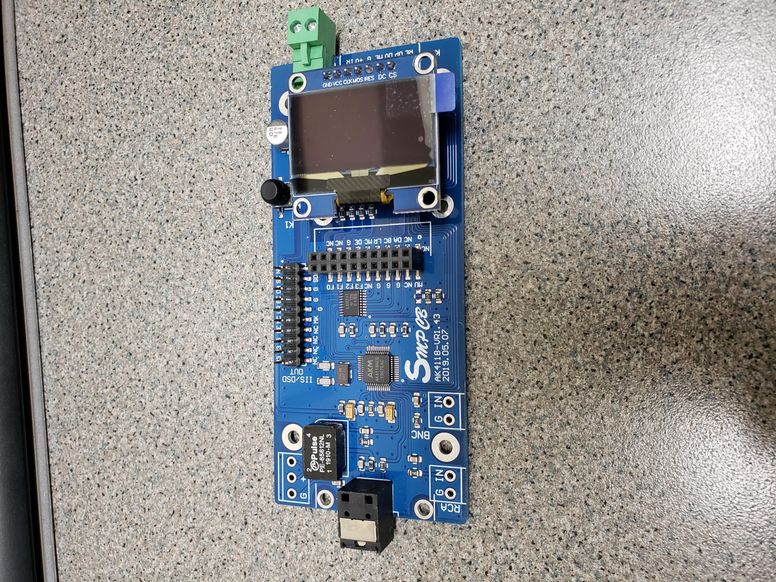

Gentlemen,
I have assembled the Miro board and was looking for something to use for a Toslink to I2S interface, found one, I'm sure it sucks, but at least I can try to get this thing going. I've attached a picture, do I need to connect to the shift registers or hook it up like the JLSounds board recommended by Miro? BTW, I have no idea what I'm doing on the digital side, you guys all speak a different language, LOL.
Hi RickRay,
looks like there is standard I2S output (and different inputs), therefore install the shift registers. These shift registers are working without problems.
On the I2S output socket are pins: LR, BC, DA, G ... connect in with DAC board (LR-LRCK, BC-BCK, DA-DATA, G-GND).
Connect the +5V power supply, connect your toslink and see/hear what happens

Pure magic!!!!! All I had for opamps was a NE5534 and a TL071 and it still sounds like AWESOME. I'm hearing stuff on recordings that I have not heard before, especially low level stuff, little notes here and there. Piano and voices are very clear and you can here the raspiness in Dave Mathews and Bruce Springsteen's voices, the harmonica sounds very nice.
