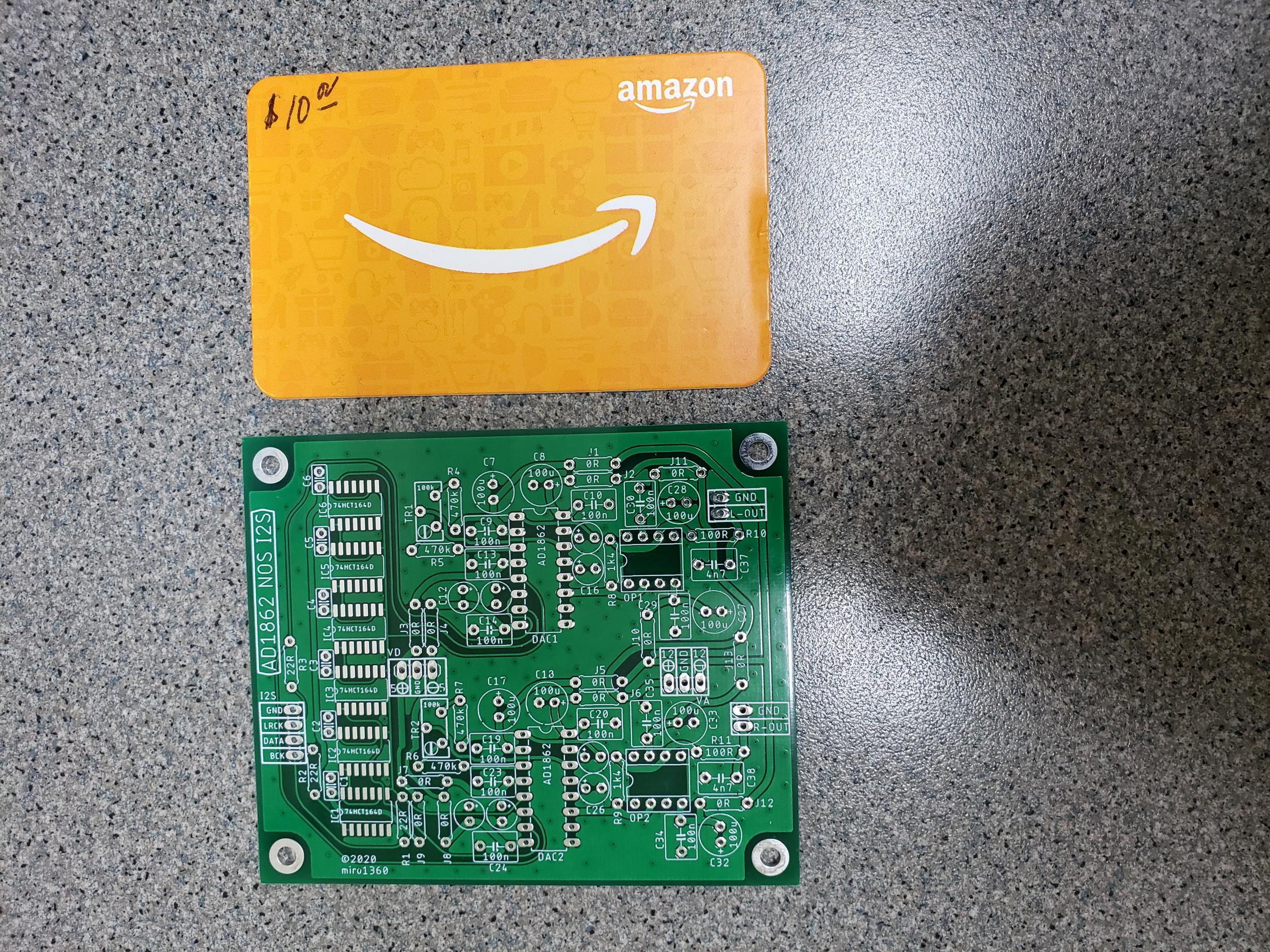

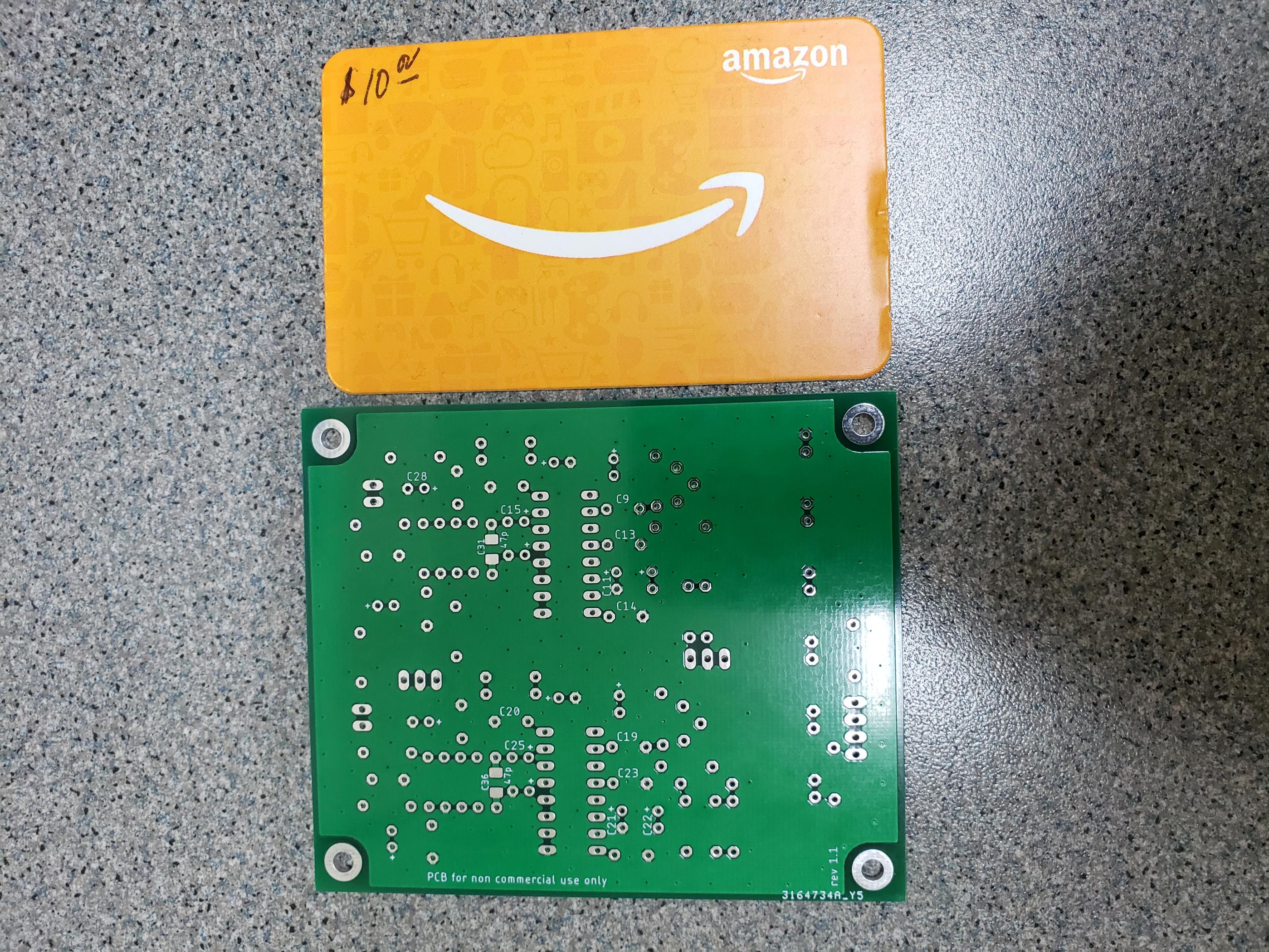

I have 9 extra boards that I have from getting my board made. I will sell these for cost plus shipping. $2.00 per board with shipping, somewhere between $5.00 and $10.00.
Boards are 1.6 thickness, 1 oz. copper weight, HASL, 2 layer.
Let me know if you are interested, include your PayPal e-mail address and your shipping address so I can figure shipping; I will send an invoice.
I will send an e-mail for approval of the final amount before sending the invoice.
