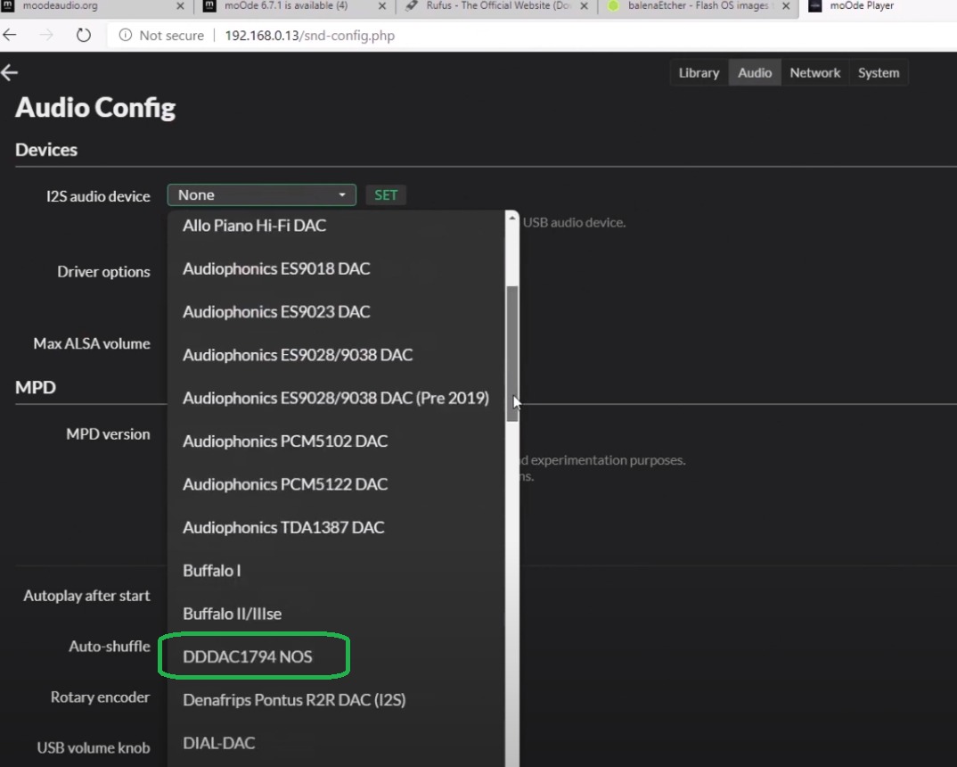

simple-bclk-64fs
... well, it can be tricky
... look for someone who finded settings for DDDAC to run on 24b/192kHz, apply the same settings for this AD1862 and it should work ...
... or just simply change the settings - select DDDAC
simple-bclk-64fs

Hmm.. So I tried the dddac selection in moode with fifopi.
Same result. Then I tried hifiberry digpro hat with moode and various selections. Also same result. Finally I installed volumio with hifiberry driver selected, again same result. The hifiberry has shorter i2s wires btw, so indeed as suggested, I have moved the rpi to the dac.
I'm a bit at loss here, might need to sleep over it..
I don't play a lot of 24/192 tracks, but got triggered by you guys that it should be able to work properly

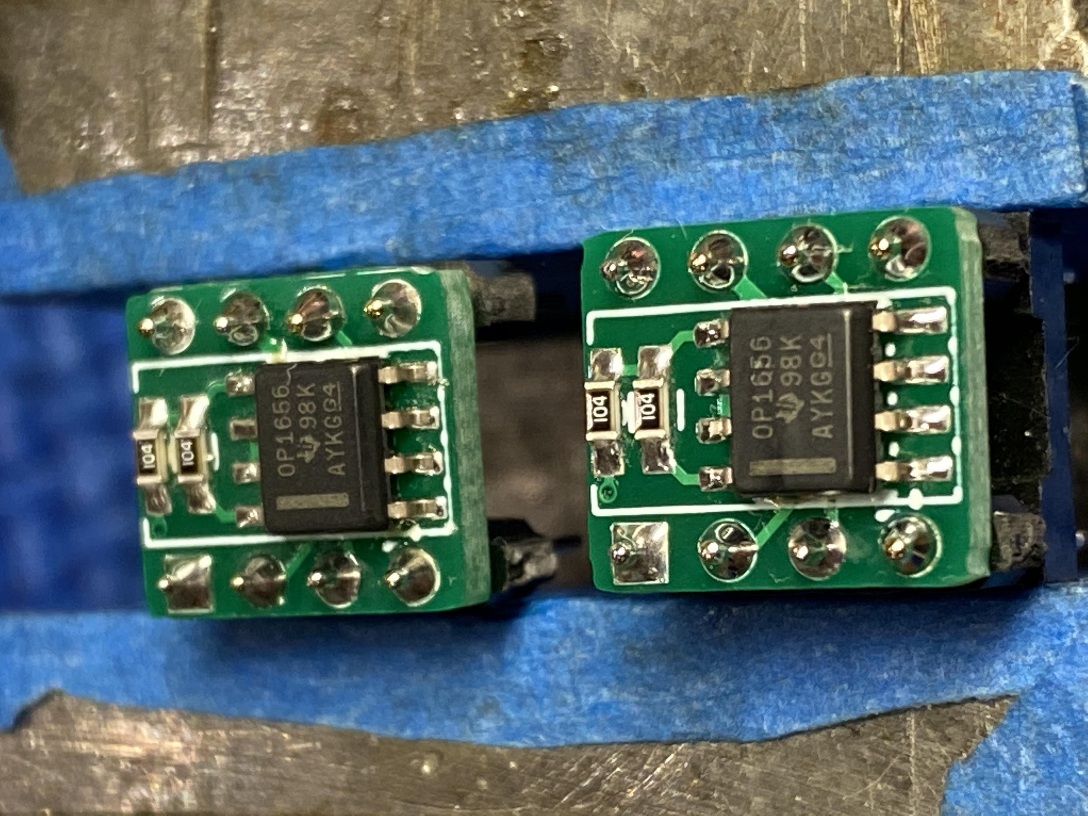

Is the OPA1656 compatible with this board as I see some of them using it? But when I check, it says 2 channel but the Miro's dac board is compatible only with 1 channel opamp per side. Here is the one I am planning to get OPA1656ID Texas Instruments | Mouser.
Try to change these resistors:
R1=100R
R2=1k
R3=100R
maybe there really is this limitation ...
you have to use some adapter from dual to single ... @Vunce has some experience ...
see the post #459 (it is untested )

In order to use a dual opamp with Miro’s Dac board, the second opamp channel needs to be dealt with properly. I had an adapter board designed following TI’s recomendation. I’m currently using OPA1656 opamps.
