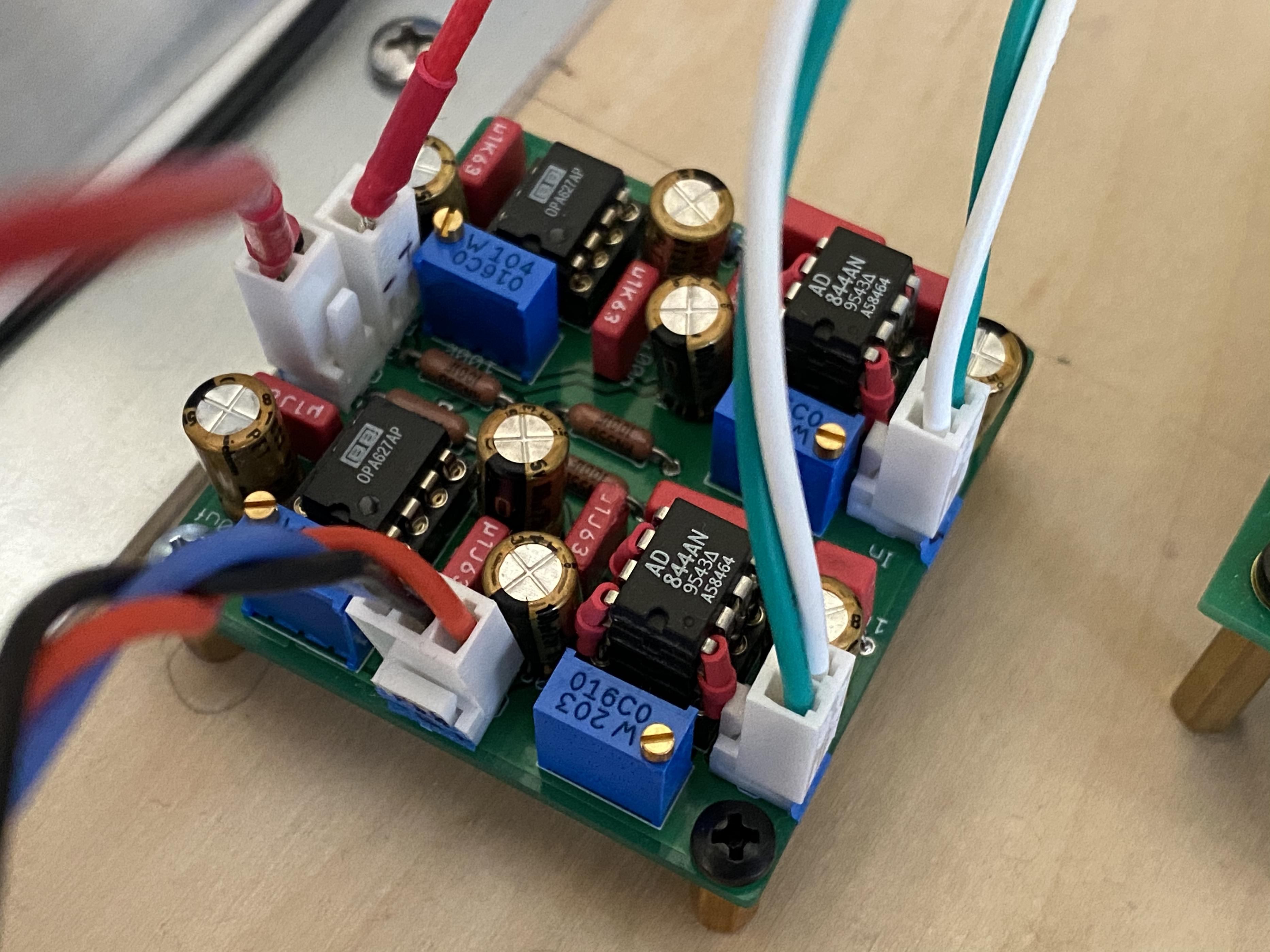

AD844 can be tried as we are in a single chip layout and this chip has a buffer.
With two opa861 (the last reversed in buffer conf, the AD844 looses. But alone the AD844 have a buffer output that is internally feedbacked -which makes the opa 861 better than the 860 or the ad844 to make short a longer story- But I really think most doesn't need a buffer with the opa 861 with a normal pre or amp (i.e. no headphones or exotic conf with pre with low input impedance à la 5 or 10k and too much long several meters cables).
Imho the LM is certainly as capable as the ad844. So the list from Galac I advised remains for me the best with the LM and the other ADA4898.
Again it's not easy because I/V & Buffer has to be made in the same chip, hence one of the bunch that could sound better than an other in each particular owner setup. That list is the sota operational amplifiers from nowadays for I/V purpose !
Tgink that the few sota CD players from TEAC or Denon that embeded the ad1862 were running with opa2604... the newest ones are much better...and diyers and enthuiasts worked a lot to make better (ah Jocko Homo said this was the best R2R dac chip ever !!😉)
Of course after there are the discrete diamond à la Rogic, or EUVL... but much more work. Rogic said the opa861 is so much well made than even a discrete will have hard time to make better.. In fact it can if you sort out the parts, do thermal coupling as said EUVL with the design he offered few pages aboves and you can design a 4 layers pcb cause the diamonf config : look at Painkiller project in this forum for more understanding.
Some I/V thoughts Galac

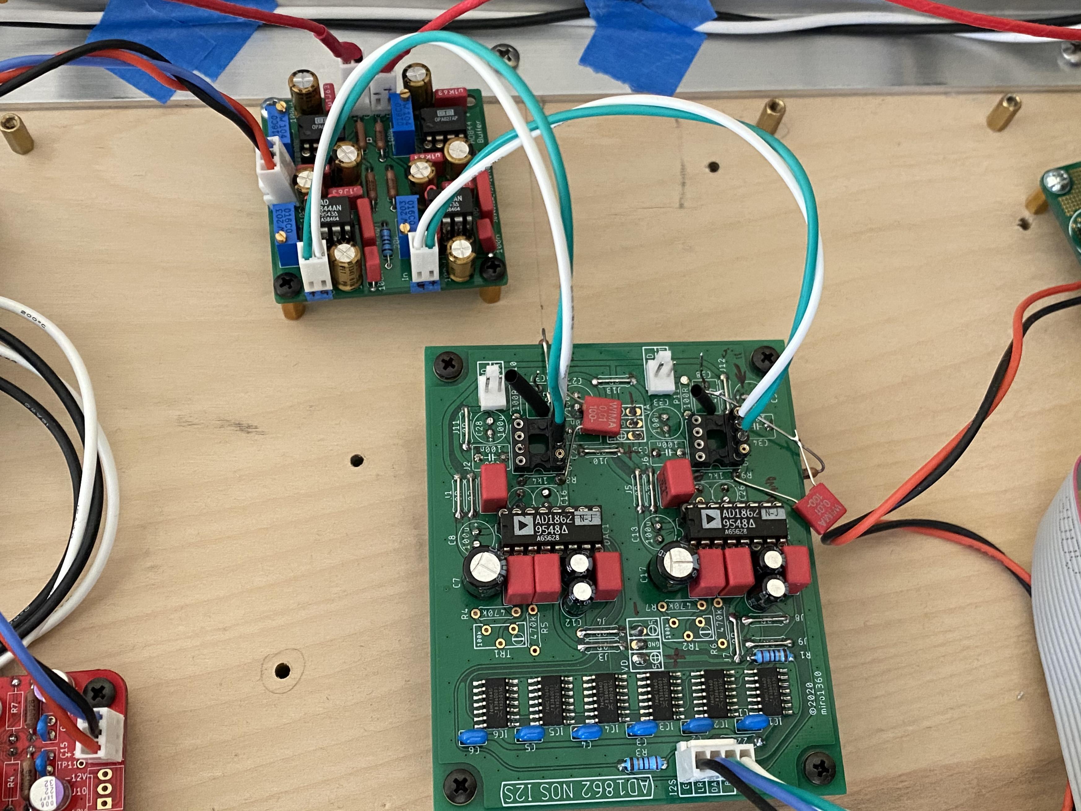

Lots of good info Diyiggy! Funny you should mention the AD844, I recently built the triple stack AD844/OPA627 I/V buffer. I sort of did this backwards as I built the OPA861/OPA861 output stage first. In my opinion both methods sound excellent. I could be happy with either, but the cost to build the Triple Stack AD844/OPA627 is definitely a negative if you had to purchase the parts specifically for this board. I happened to have the opamps in my parts bin already 😀
As for a simple opamp plug in for Miro’s Dac board I find the OPA1656 (properly connected to an adapter pcb) and the OPA627 are very hard to beat in my main system.

@all
Thanks for your extensive and valuable feedback!
@Paddy
I really like the "mono" idea as I have a switch laying around that switches L (or R) to both channels (which was intended to make cartridge setup easier) and changing the bottom opamp is way more effort.
@diyiggy
Yes, I talked about the "Simple Discrete Current-Mirror IV Converter, à la AD844" from EUVL. But I have to think about the implementation cause I'm somewhat space constrained and didn't intend to route another DAC PCB - for now 😉
@Vunce

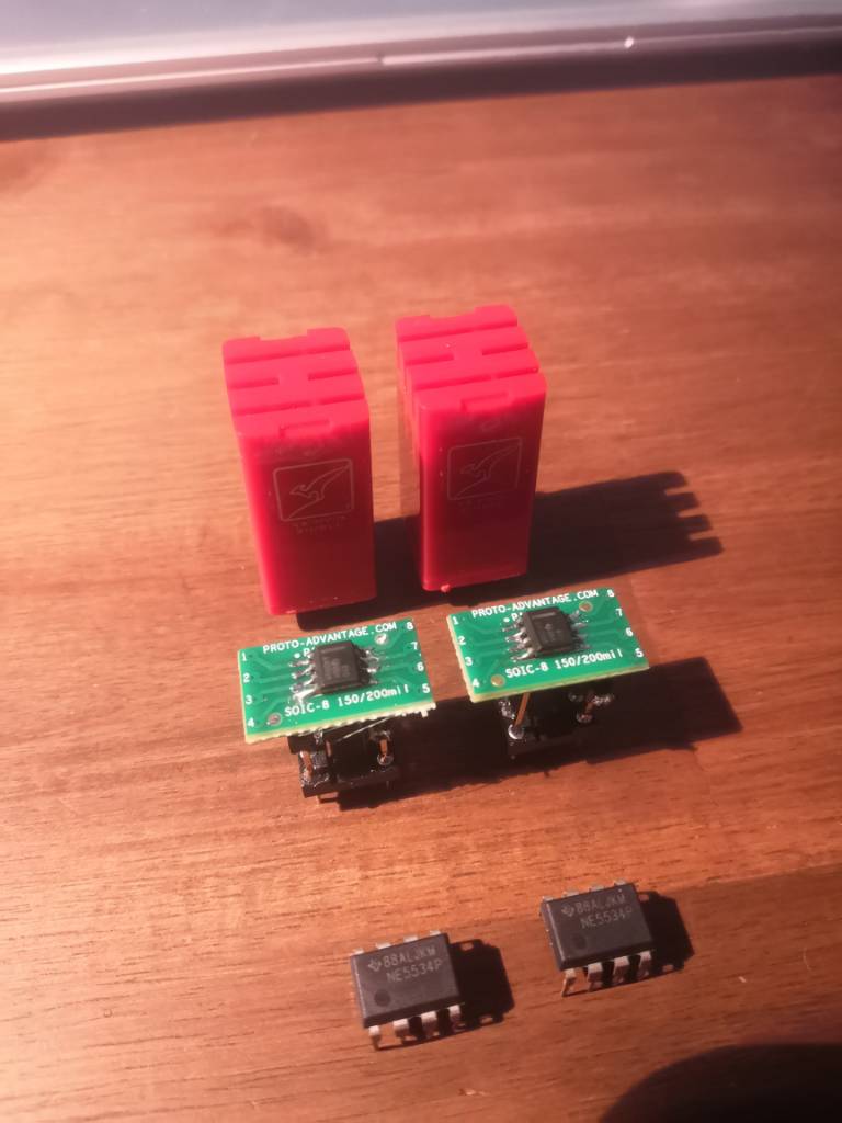

As I really don't like the price of the OPA627 I'll give the OPA1656 a shot

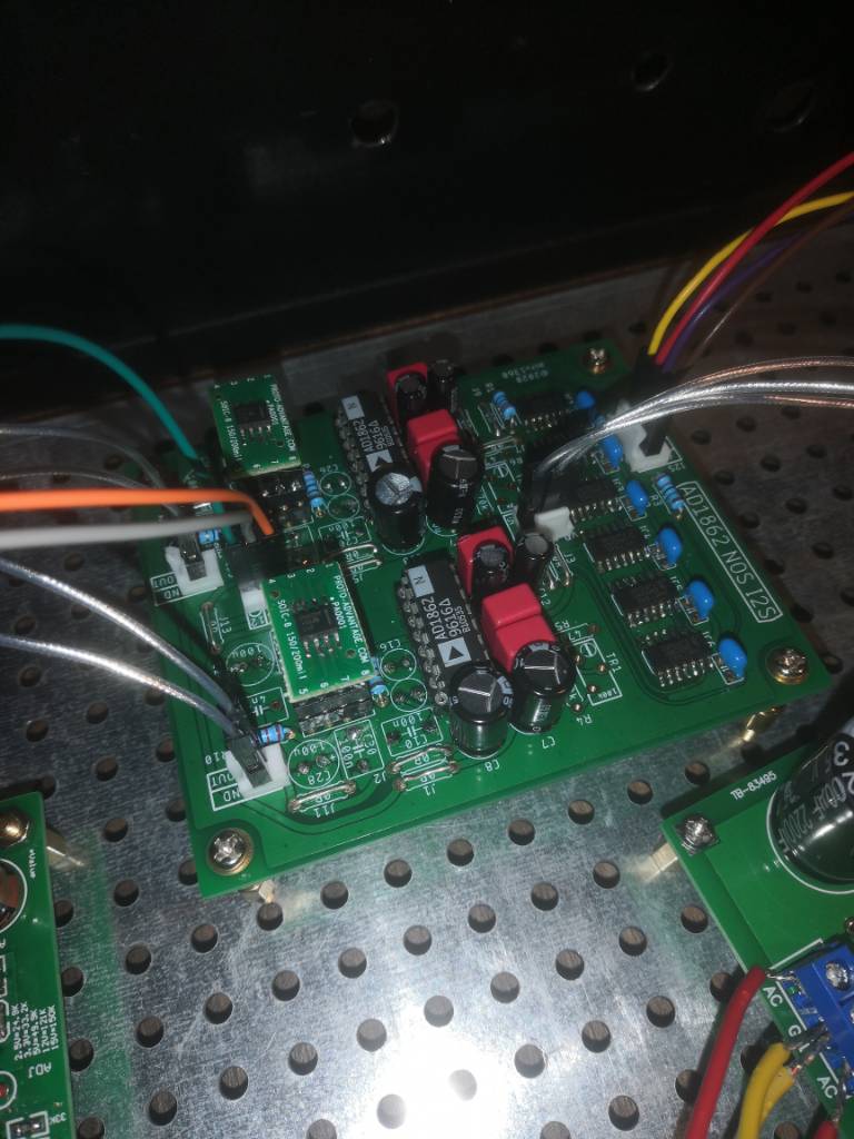

All built and done, I thought... Can you guys help me troubleshooting? I have literally nothing on the output. To be honest I would not know where to start troubleshooting?
I must confess that I made the mistake of reversing the caps on C32 and C27, because I thought I had an old board... Now I have correctly soldered the caps in again ( I assume as they do not pop as the previous two). Could this have destroyed something in the process of popping?
Your help is much appreciated🙂
Let's start with my setup:
- Lm317 psu for 5v digital and fifopi clean side (might need to separate those) from aliexpress
-lt3042 psu for 12v (also from aliexpress)
-audiophonics trafo's
-Salas L'adapter for rpi3
-fifopi with accusilicon clocks
-opamps used: opa810, ne5534, burson v6 vivid.
So far I have tested the opa810 and ne5534, of which I prefer the first. This is only on short listening session so no final conclusions here.
I like it so far, but we are not there yet. The lows are a bit muddy but plenty, and highs can be somewhat shrill and flat.
Compared to my dddac: on the dddac the bass has more details and highs are floating around with more nuances. Bear in mind that this dac has output trafo's of approx USD 300.
I still need to sit down for a while to listen to the Bursons, as I have not heard these yet.
One question I have to you guys: does r11 and r10 resistor do anything to the sound? I have put in 22r but wonder if i should just jumper it? (guess it doesn't matter but confirmation would be nice😉)
Test it with another opamp, like LM6171.
R10,11 itself should not affect the sound. Contains your DDDAC a coupling capacitor on the output? It can enhance the bass color. You can use a similar coupling capacitor instead of R10,11. Anyway if somewhat possible, try it with a decent output transformer.

Testing with Bursons now, which is quite a step up already I must confess, would not have expected that much of an improvement!
No, the Dddac is passive i/v with transformers on the output.
The sound is now very, very enjoyable! Music has been on all day[emoji16]
