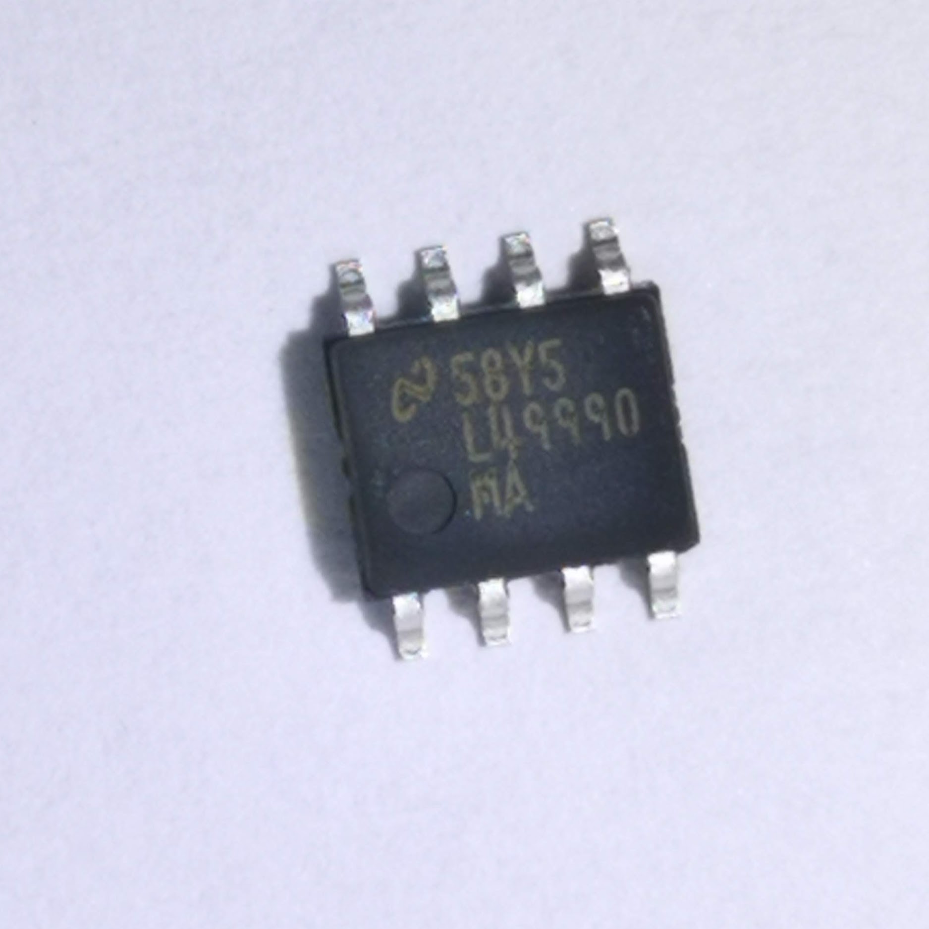

So this came from poland already transplanted to DAC. According to pictures posted by Miro I wouldn't bet this are original since the hole looks flat/ish (on pictures from Miro you can clearly see hemispherical hole on mine it is realy hard to tell) ... Sound wise they work 🙂 They sound good what I noticed is the bass is not so heavy and it is more natural than ADA4627-1. Will replace again with ADA4627-1 in a couple of days and see.

yup, but they could be genuine as well : if the hole is elleptcal enough it could be from a different plant and manufactering tool generation... I don't see chineese children in a cave rounding elleptical holes on oaps the night at the candle light to make few cents for the owner for him to buy a pangolin for christmass or some camels for the silk road to send his oaps in Poland!
Swap it with a 5532, if it sounding the same, you know that it is a fake rebadged, now if it is near enough of some ADA or LM of good quality it's maybe not a fake ! Or Send it to Miro in order he can test it 🙂

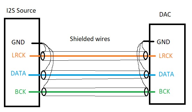

Still enjoying the DAC in the evenings! Got me wondering, how should I best deal with high res files from qobuz via my rpi with moode installed. I set mood to generic i2s dac with no resampling. 24/96khz files play but 24/pp192khz heavily distort. Should I set the moode client to always resample to 16bit?
@Robin De Wolf
24b/192kHz audio should work with this DAC (from that 20 most significant bits will be played). You can test it with an xmos based USB-I2S.
... the DAC logic does support a 64-bit frame I2S ... it does not support shorter bit frames (48 (2x24), 32 (2x16)) ... this 64-bit frame will transfer all stereo music files in resolutions 16-bit, 24-bit and 32-bit (from that 20-bit will be played)
... the question is: Does the RPI support 64-bit frame on 192kHz? RPi 4 should support it, but the older ones may be limited.
... I googled, that RPi 3 does support 24b/192kHz as the maximum, and here I don't know if it sends these bits in a 48-bit frame or can handle the 64-bit frame. If 16b/192kHz is played on the DAC, they are sent in the 64-bit frame, the same for 24/96khz (because it worked), but what is the frame for 24b/192kHz? (I found, that HDMI works only in 16b/192kHz) ...
Try to shorten the I2S wires. Or use a shielded wire for the I2S (but it probably won't be the solution 😕)
