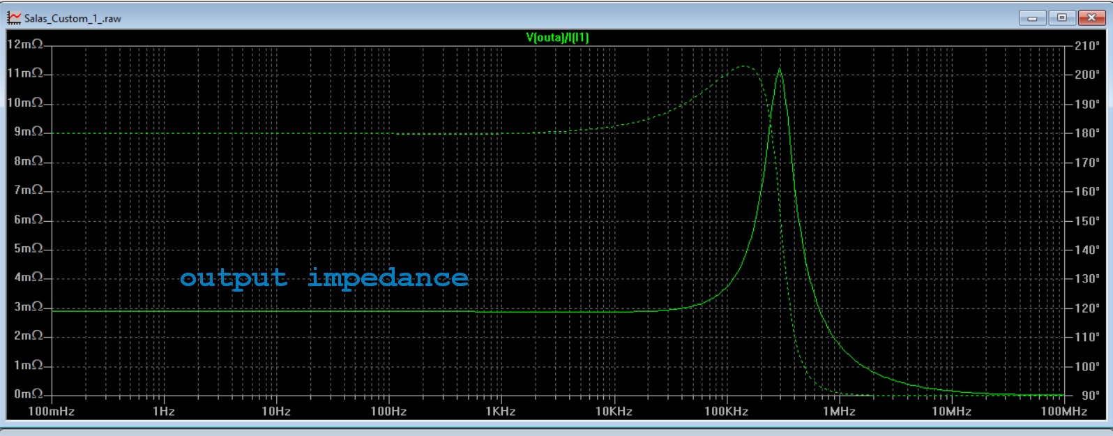

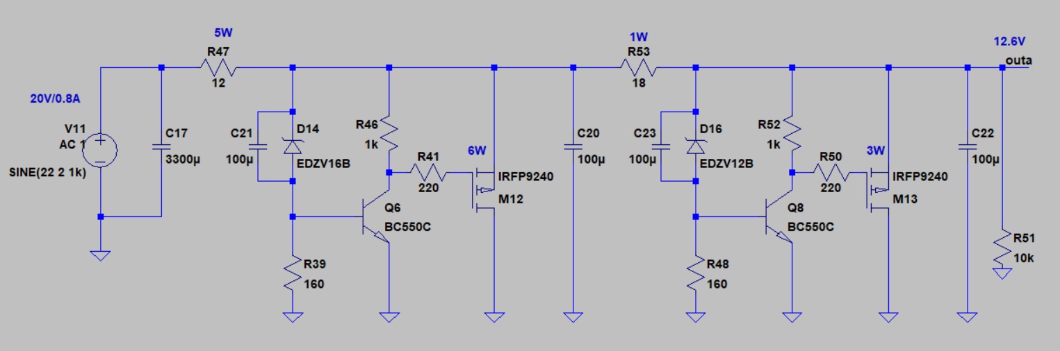

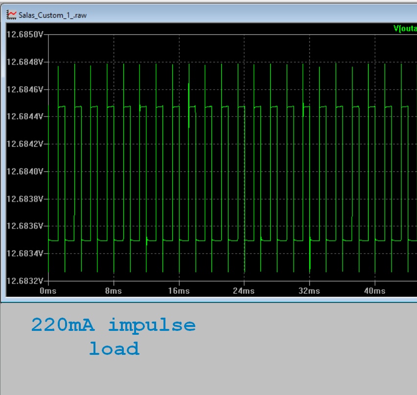

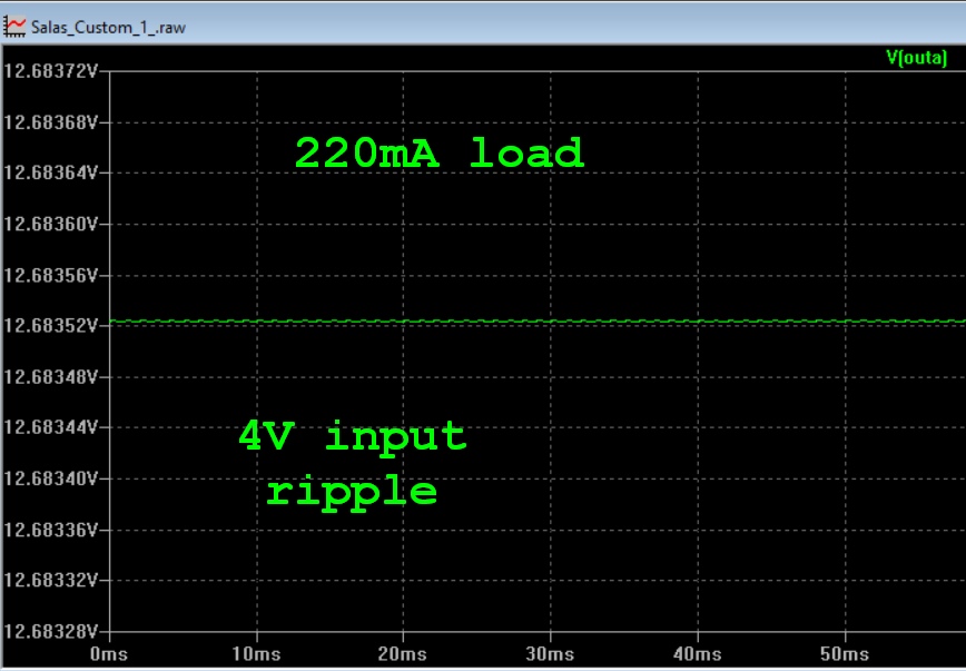

There are plenty modifications of Salas shunt regulator. Since it's a shunt, I wouldn't want any active element in the series, so I slightly simplified one from 2009 and put 2 in a row. It holds the voltage under any load. The mirror version for the negative will be similar.
The main drawback of shunt regulator is the large power losses, in my case 20W
No real test was performed by me, maybe it's not even stable.
Whether it makes sense to try ...

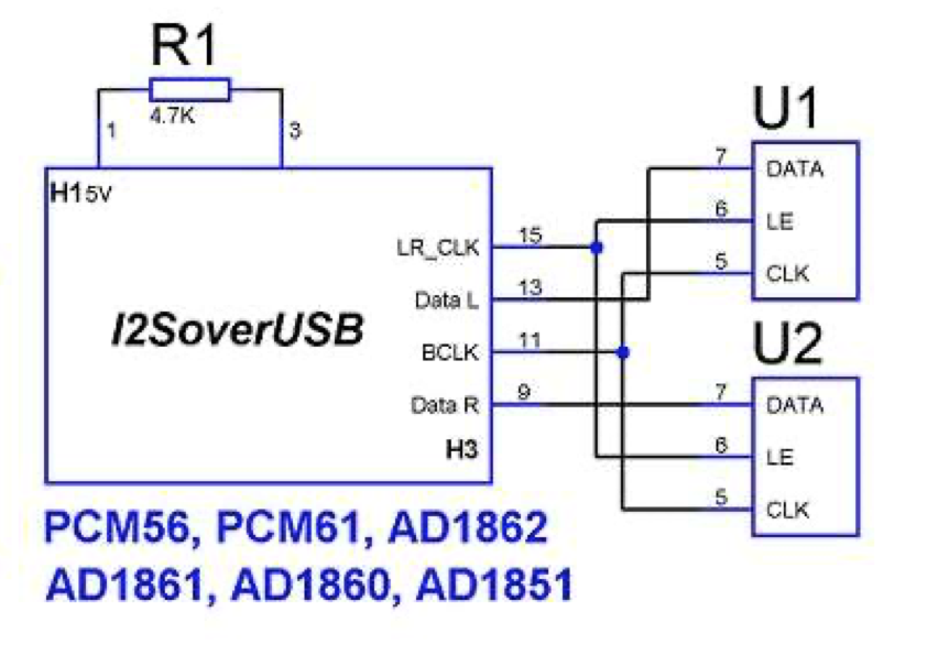

Any suggestions for USB to I2S converters suitable for this architecture ?
I2SoverUSB - I2S over USB Audio
It looks like with this one no need for shift registers have not tried though ..

I'm going out on a limb with my project. I have some PCBs in transit that 'borrow' Miro's DAC section layout but I've omitted the shift registers and I'm replacing the output stage and will be using a Borbely tube/mosfet 'op-amp' circuit instead. My DAC section will stack directly onto the I2overUSB, which will obviously be configured to interface directly with the AD1862 devices. Could be a nice little new Year project.
