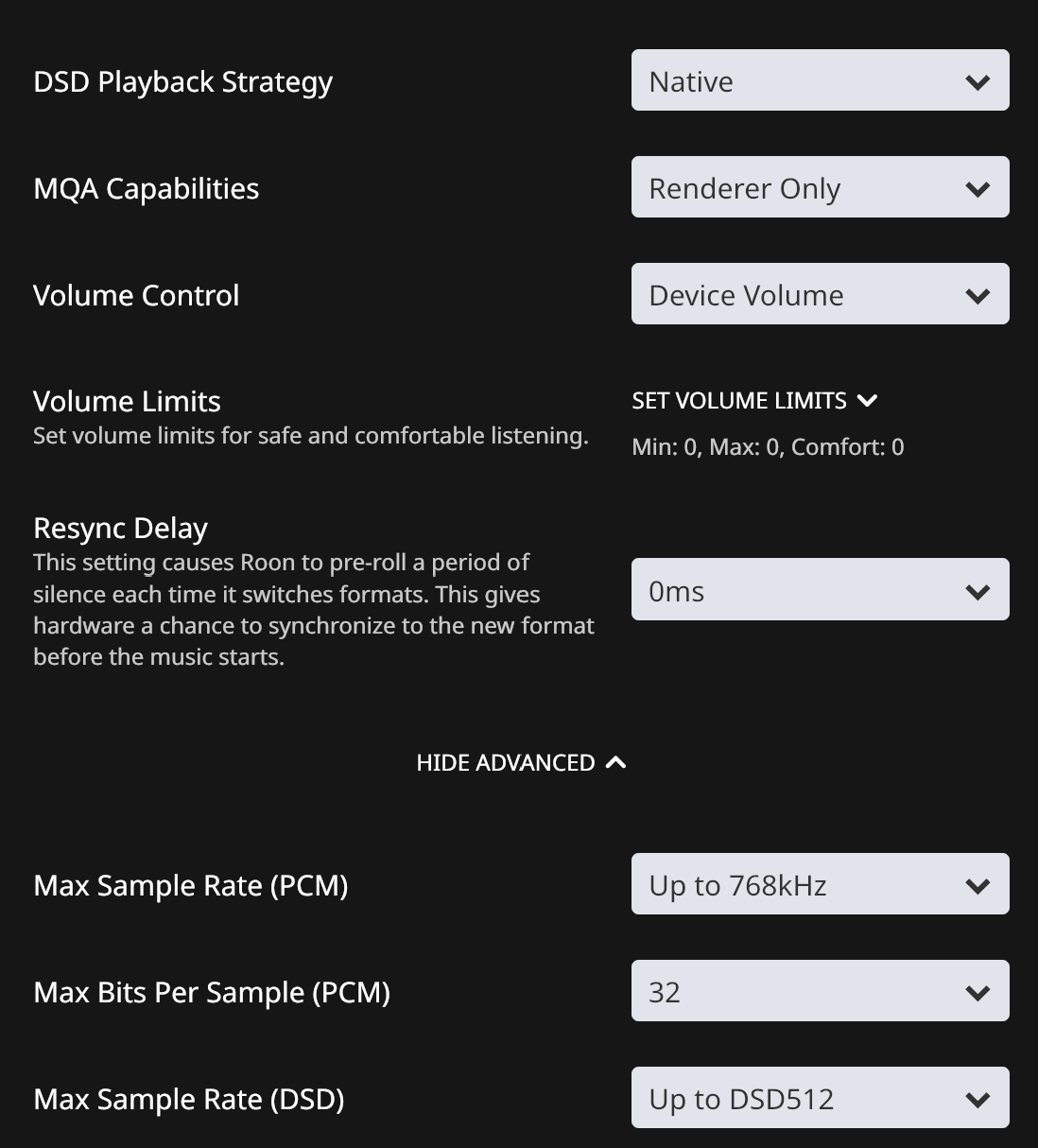

nano I just received i2soverusb and have connected everything and it is playing over raspberry usb, below is a screen shot from ROON. i2soverusb was automatically detected like this... I think you are having some sort of hardware problem or something not connected right if you haven't been able to solve your problem by now.

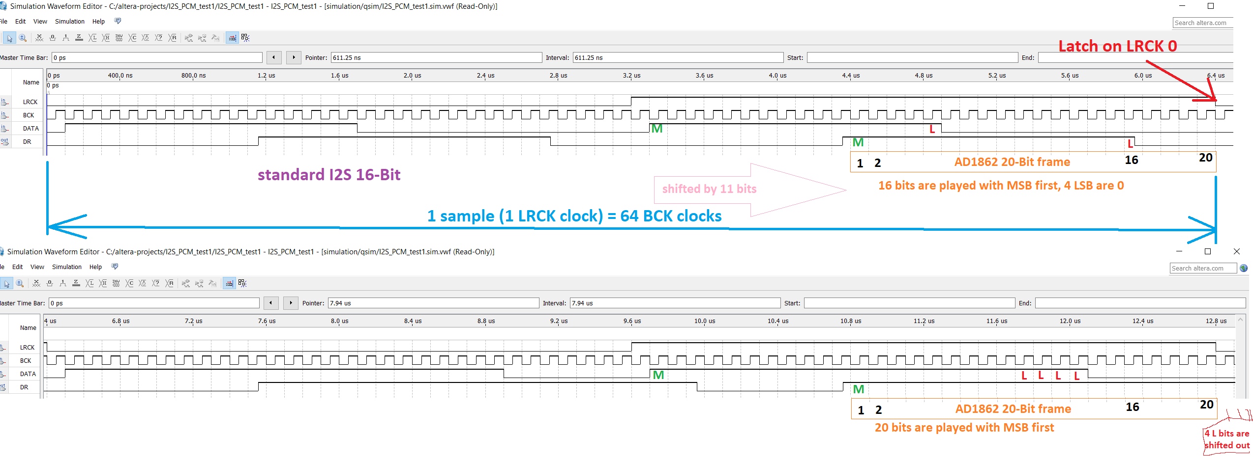

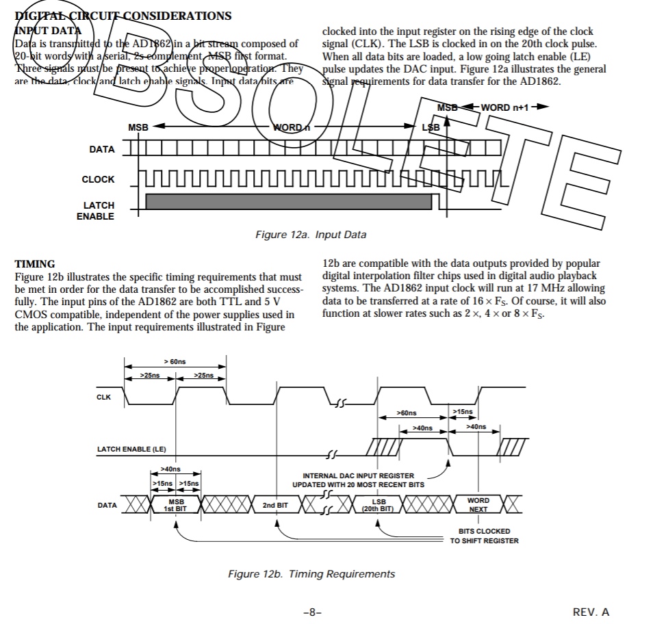

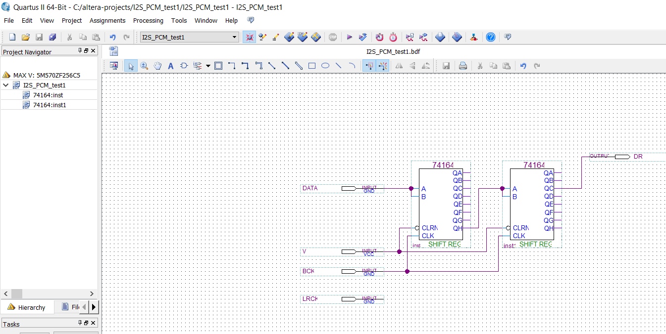

Here is a simplified simulation (without 32b buffer) of the shift register for someone who would be worried about some lost MSB bits. The simulation proves that the shift register is universal and all MSB bits are played for either 16b (aligned correctly) or 24b recordings and only 4 LSB bits from 24b are discarted (or not shifted in)
