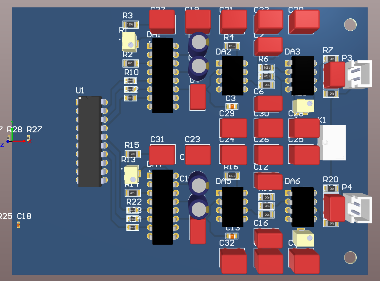

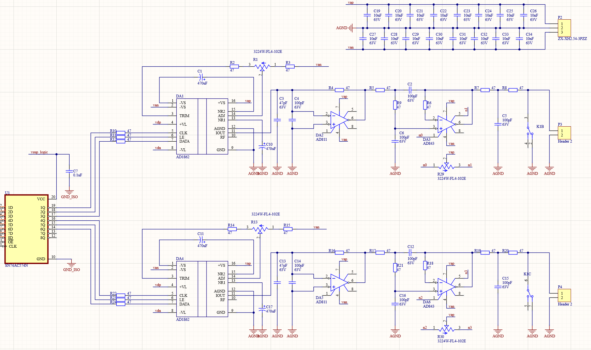

The one thing I missed in Miro's boards is the reconstruction filter so I decided to make a PCB with one (WIP):
4 layer board, going to pair it with the PSU posted earlier. Main question is the input, since I want to have both USB (York) and Bluetooth options (Bluetooth would require resampling), I am going to separate all of that and and just have clocks + reclock register on the DAC board.
(Don't pay attention to values on the schematic, they are all wrong 🙂 )
So this will be an AD1862 board with output filters? Or do I misunderstand?

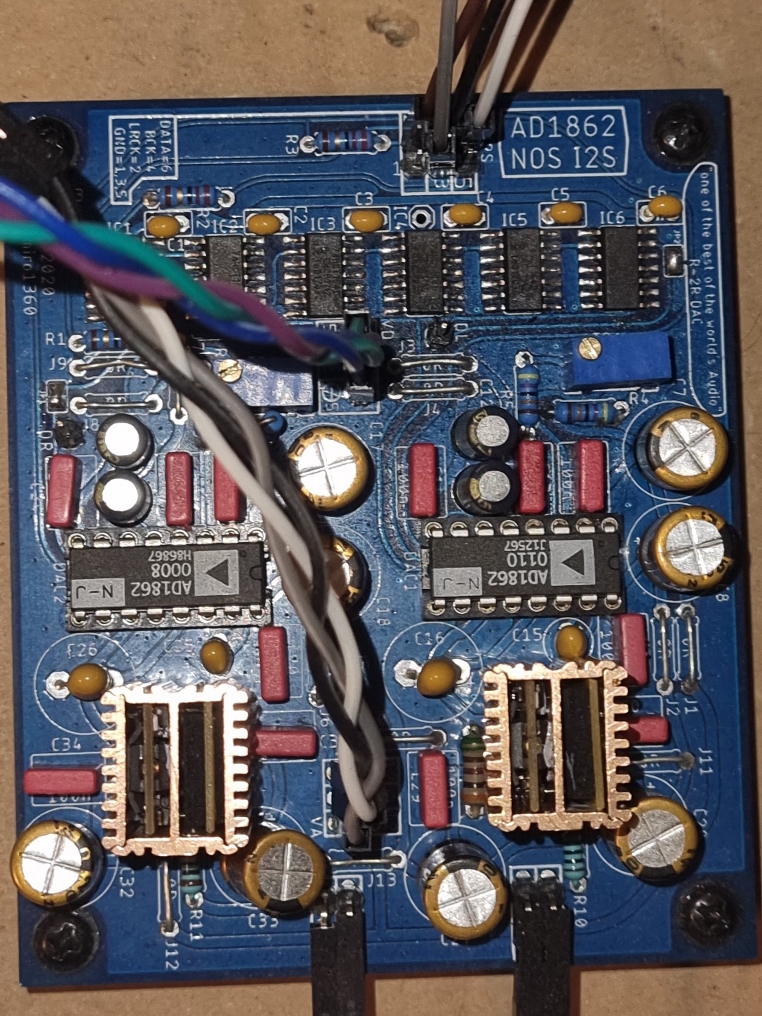

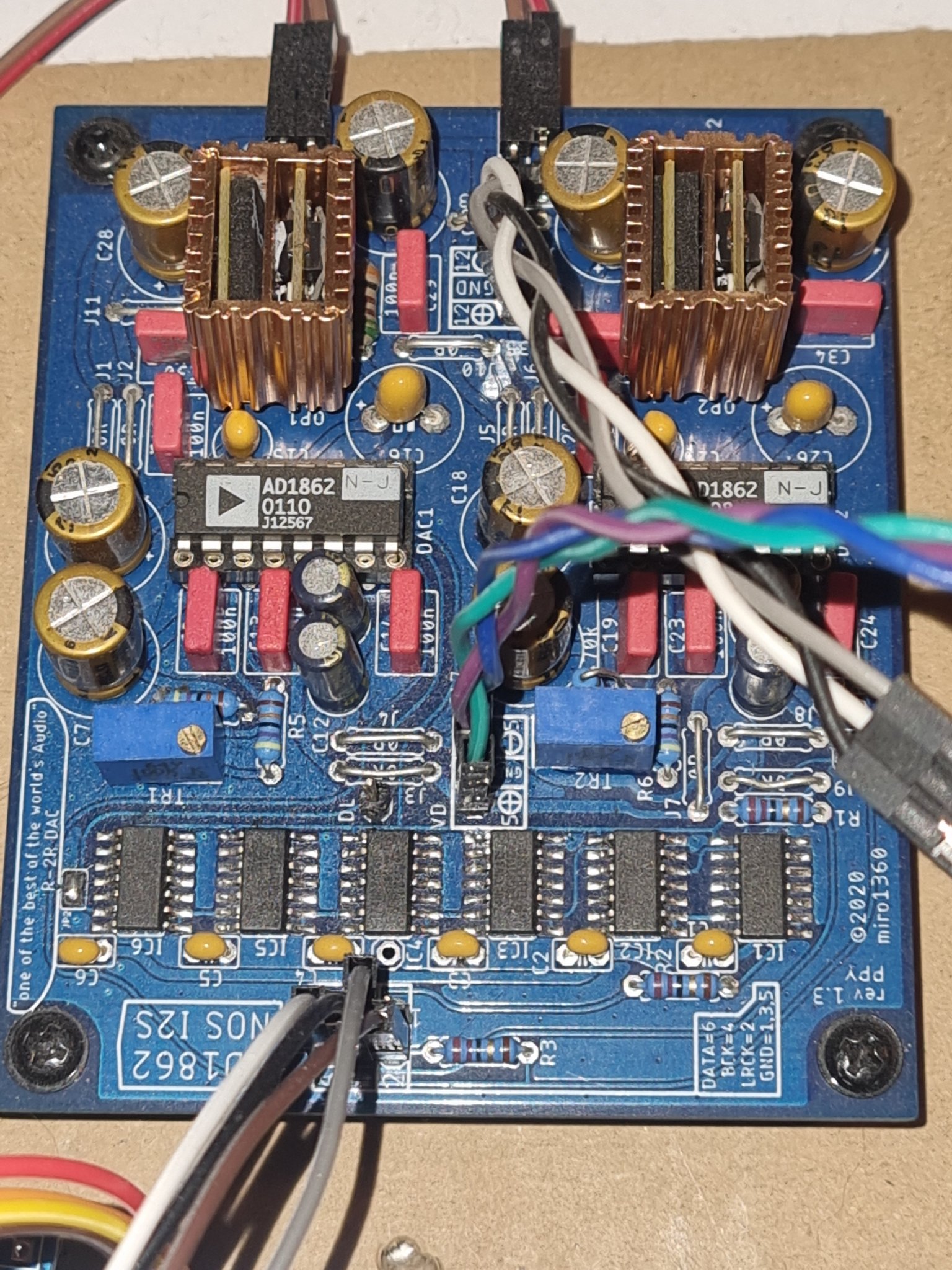

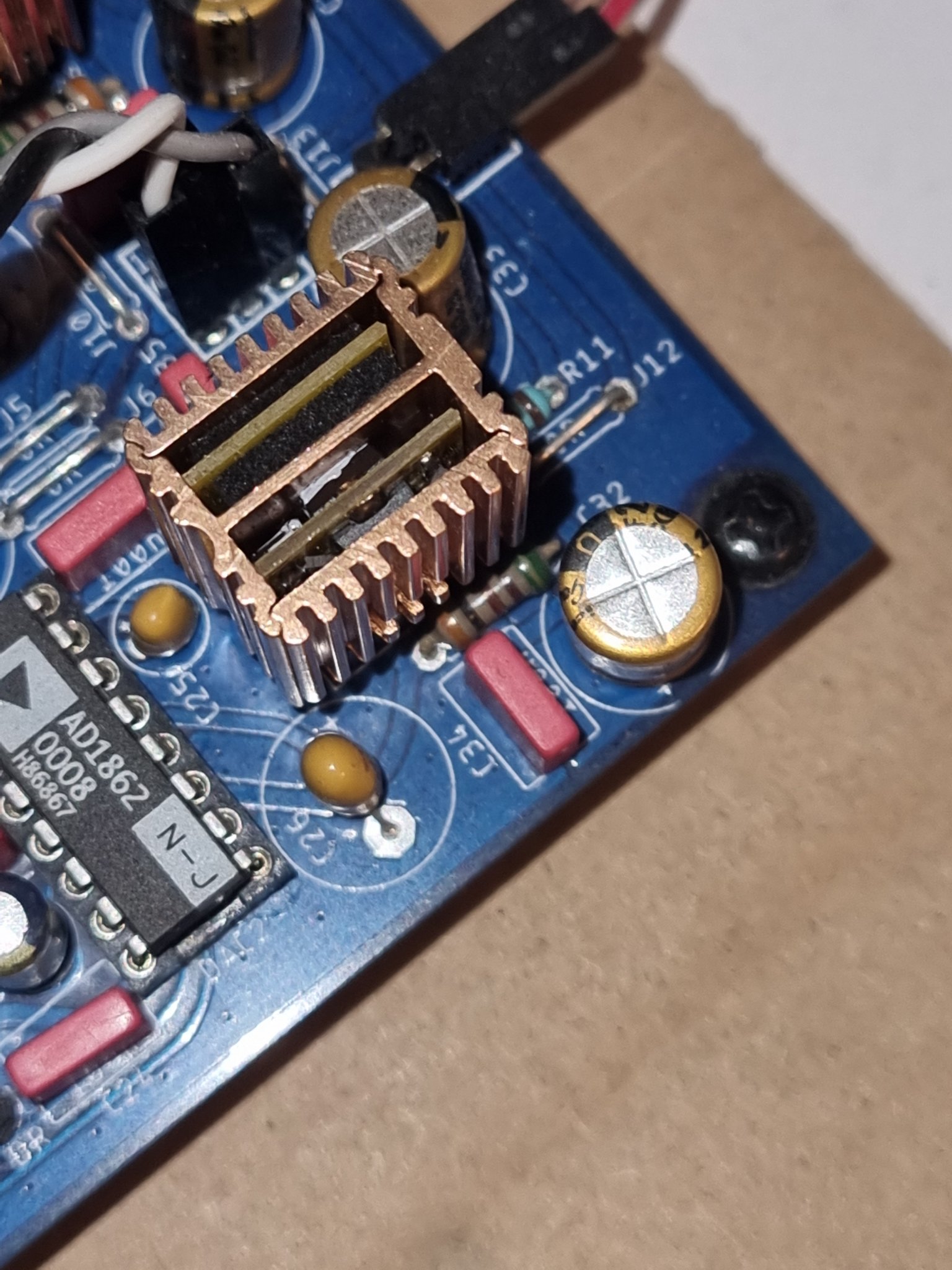

Hello everyone, some time ago I bought a used Ad1862 dac. Could someone check if all the elements are ok? It sounds nice, but the stage width and some bass attack are missing. I am not an electronics guy, more of a hobbyist.
