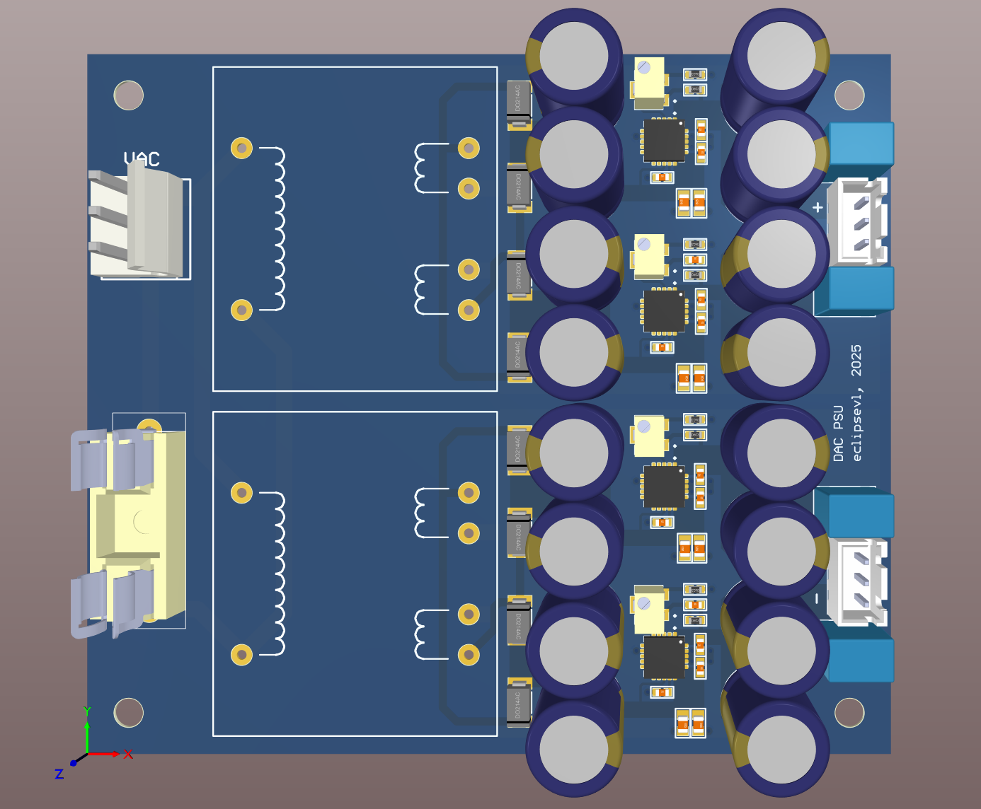

DAC AD1862: Almost THT, I2S input, NOS, R-2R
Seels the trim pots values for PSU2 12V side works better to get 10V when changing only R1 & R2.
Have to check with R1& R2 for 15V to see if the trim pots values given for 12V can be kept too.
Too bad, 😭, as a lazy guy I wanted not to touch the trim pots and have a 12V + 10V and a 12V + 15V PSU2.
why not going CRC after the bridge rather than CC? An additional say 5R / 2W resistor could spacialy fit and provide a 31Hz Fc traditional RC filtering
With 100dB PSRR provided by LT3045 I don't think it would make any difference 🙂
The only reason here to put a small resistor between didode brige and cap is to protect the diodes from high startup current. But the caps are not too big so should be ok without it.
Sent to production. Grounds of the two sections are not connected on the PCB.

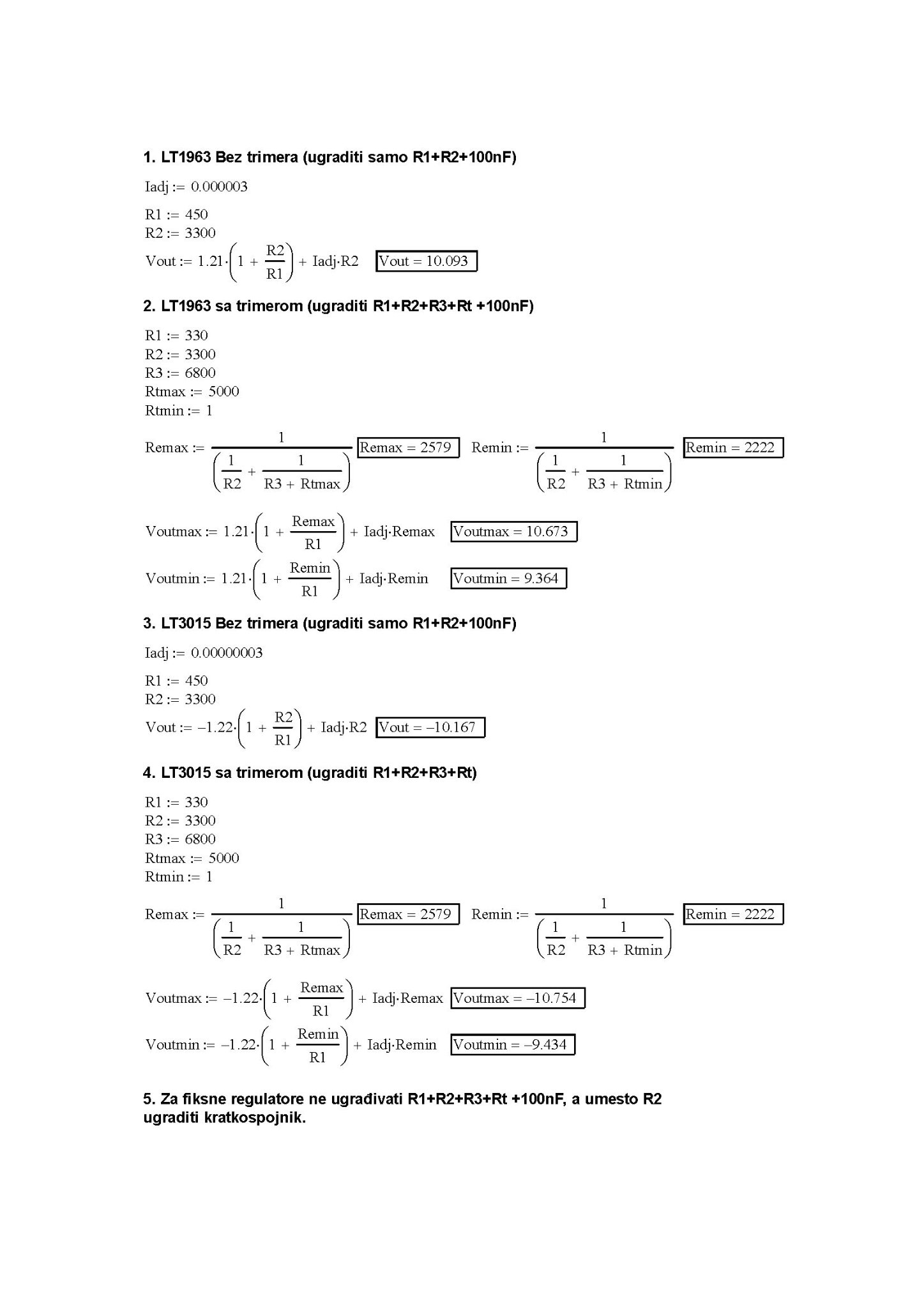

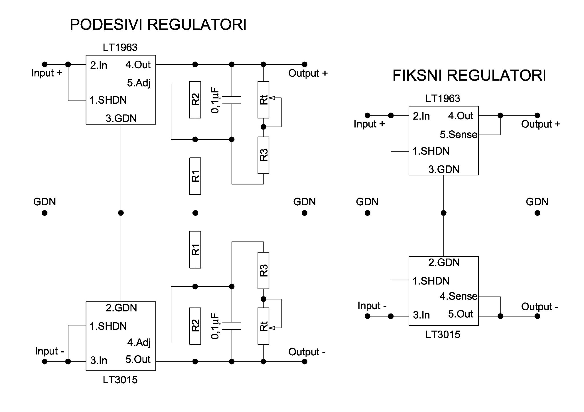

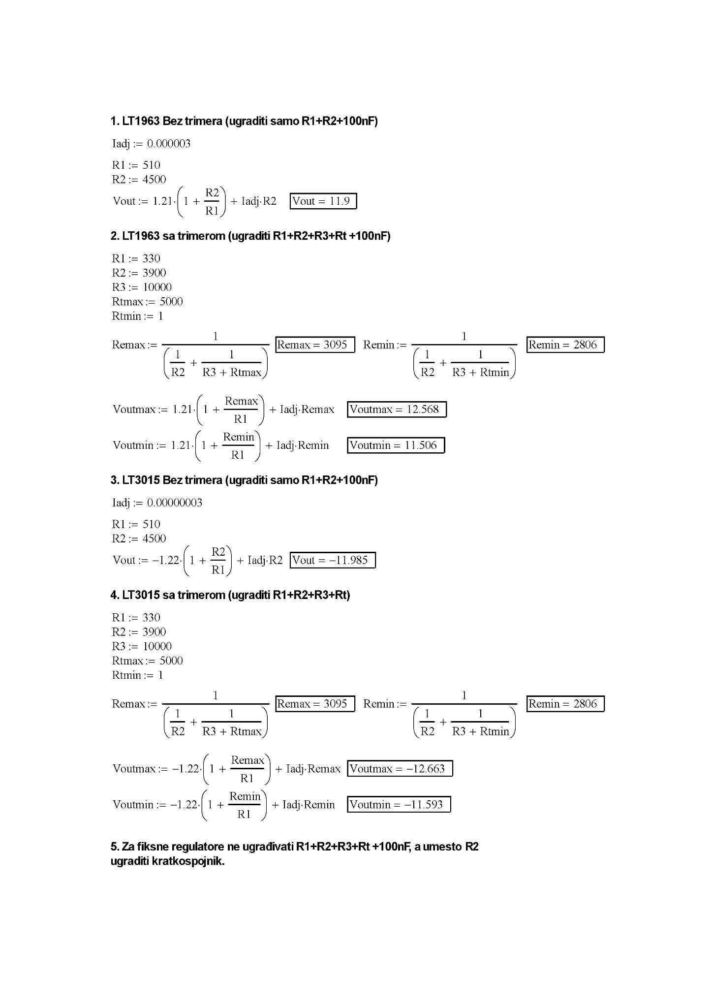

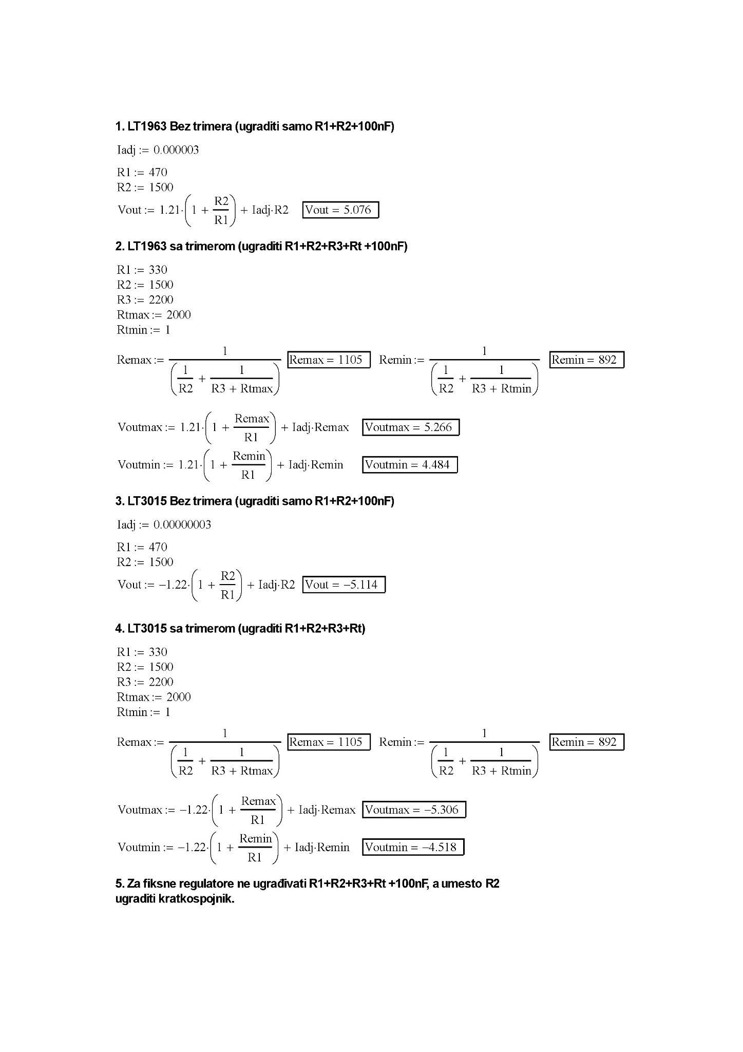

I made myself mathcad sheets for PSU2 with LT1963/3015 in various variants (with and without fine voltage adjustment), only everything is in Serbian. I can translate all, but I believe hardly anyone uses mathcad these days. 🙄
I should have made excel sheets, that would have been more useful probably,
Fixed regulators LT1963/3015 can also be installed on PSU2, resistors R1, R2, R3 and trimmer RT are not installed, 100nF cap is not installed, only a jumper is installed instead of R2.
R3 should be 5K (the pot) and not 2k2 for the +5V of Miro's PSU2 as per your first jpg.
The r1 and R2 and R3 could not be the same for the LT3015 (sees Miro's shematic).
In my compute with the R2 network I given, I only take care of the final R2 value by additionning the pot and the R below in serie then take a // resistors calculator to have the final values of R2 like if it was alone. The value took care of the pot to be at 0R and at its max R.
For the 3015, final R2 network with just the R1 changed at 4k2, will be 27791 ohms and 46493 ohms according min or max of the trim pot, supposed to give 9.2V to 14,7 V .
For the LT1963 which doesnt work with my value of R1 = 150R (blows the fuse on the positive rail for both positive regs of miro's PSU2) the R2 network is supposed to be 937 ohms and 1250 ohms for 8,7 V & 11,4 V according the pot min to max.
