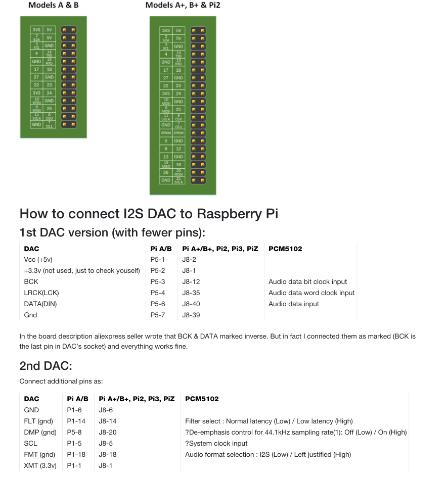

Can you elaborate? I used the RPI GPIO with a PCM5102 DAC in a previous lo-fi project, using this mapping and a standard driver:a CPLD signal consisting of CLK, Latch, Data Left and Data Right

However, i2s is not a protocol directly accepted by these DAC ICs. They need a conversion first (done in this particular case by shift registers).
I don't know what pcm5102 is using, if it coincides with the ad186x you could try to connect them to the PCM pins, but looks improbable to me.

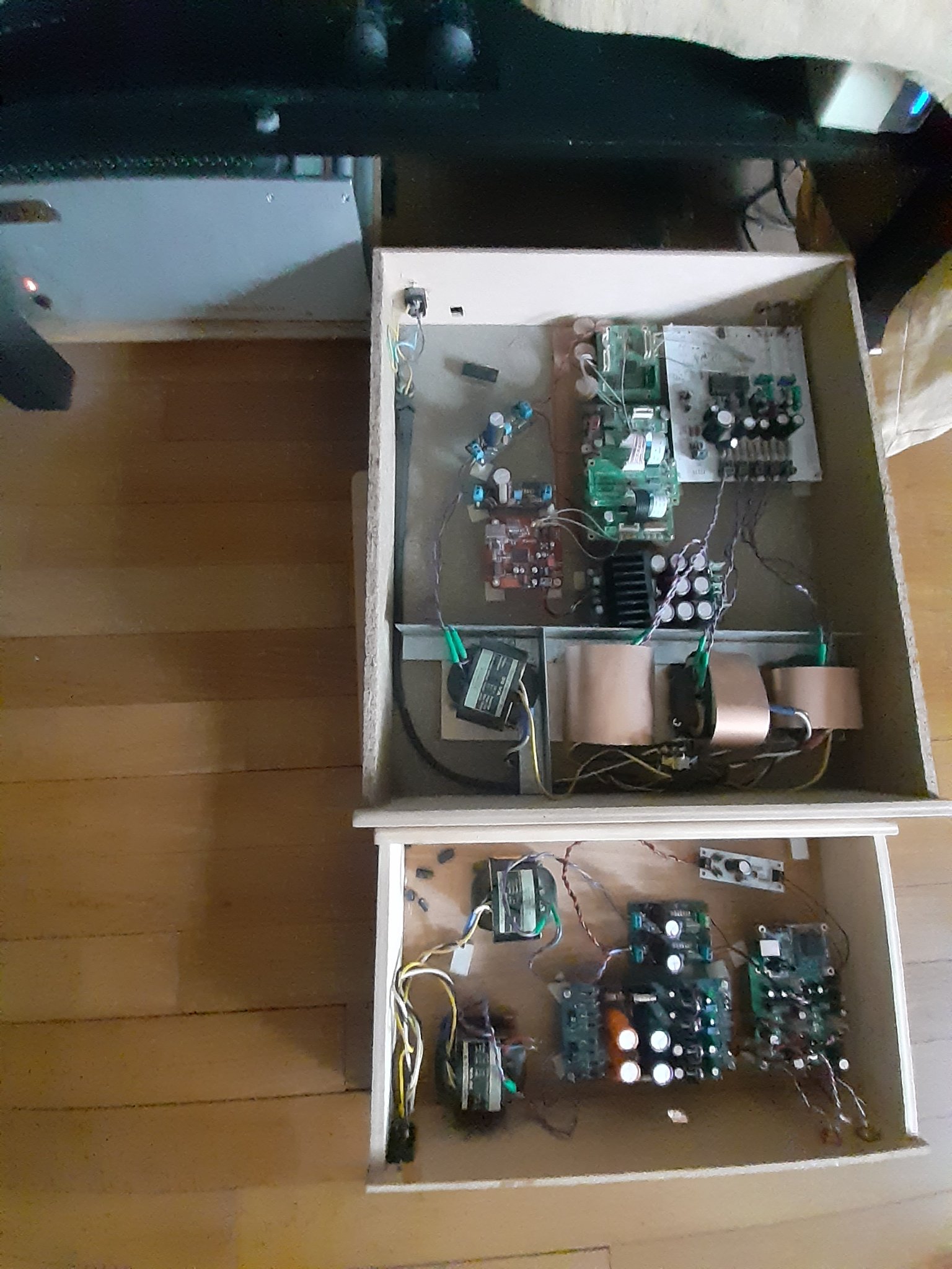

So I listened the AD811in my new 4 layers itteration pcb N° 5, like the perfum without the smell. Ad1862, so.
To make it short before more description, I find it a strange beast in my setup, there are poors and cons. It makes not better I have found than my main dac opa861 based but dacs are totally different.
It is confortable to listen to with very natural high mids and trebles, colored low midrange with a veil there, false thickness, tamed dynamic or sligthy recess of level in that lower mid/mid-bass. More remarks to come about the voicing and parts later. It makes in my setup a non fatiguing sound with very broad soundstage latterally. Good heigth too. Not ultimatly clear cause the sirup thick low mid. Bass are articulated and good dynamic but lack edge attacks, i.e. too much rounded, like bass made by a bass reflex two ways to illustrate, so not natural.
It has more poors than cons, but too much colored tonal for my setup or taste. It is the champion op for relaxed sound and if you do something else at the same time. Excellent for background or dinner, zero fatigue and headaches. Natural in that context, not for a focused audiophil listening. So sorta of tube sound in the bad side of its description... which a good tube amp is not.
Photograph : new pcb in the little proto box, aside are two V4 4layers pcb on the table. The little proto box aside my main ref Dac with its more complex power supply and digital front end with better clock.

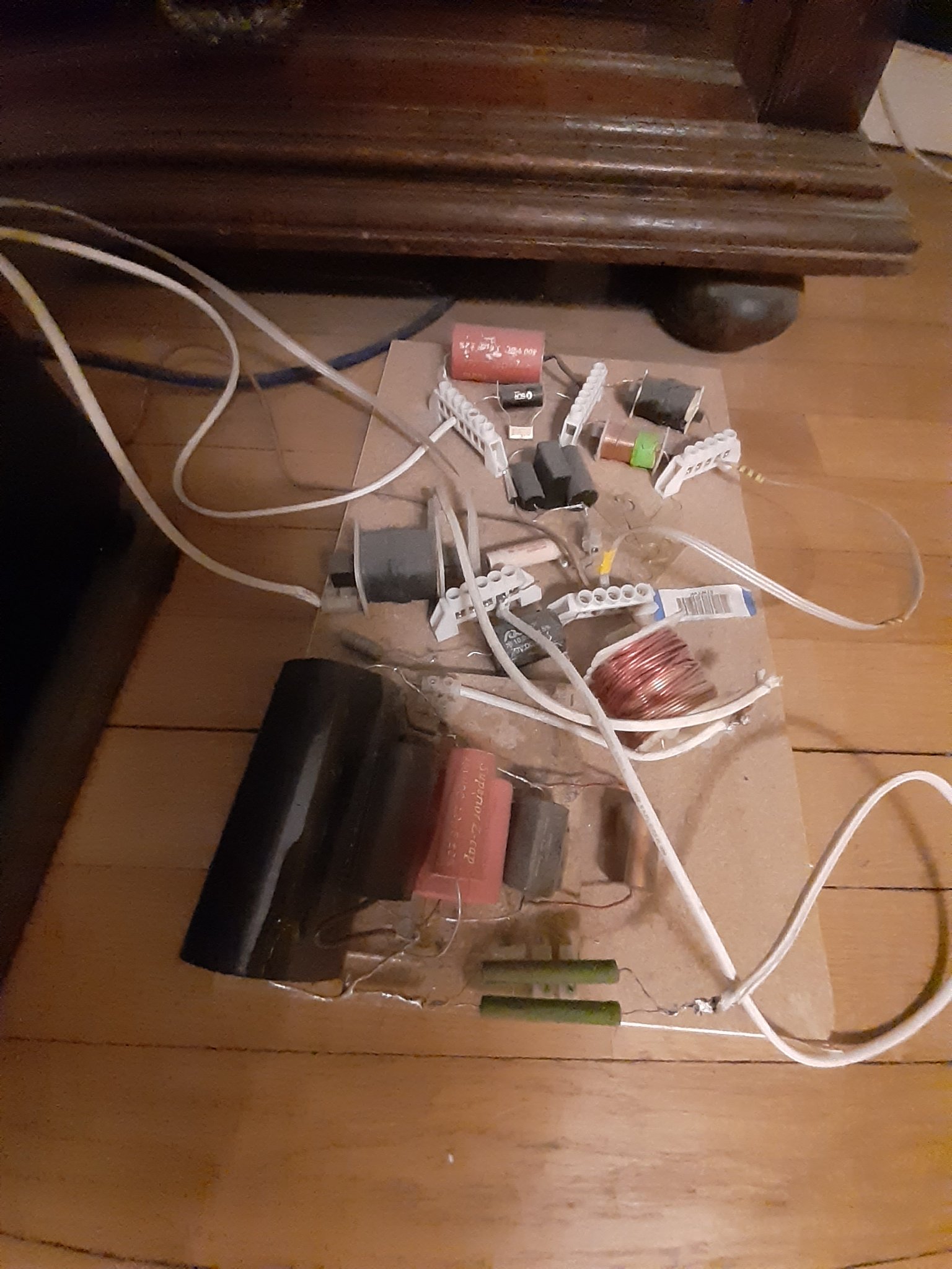

I will try later to change my loudspeaker mid serie resistors that are 2 ohms Mundirf Mox with a Supreme which is more on the neutral vs soft the mox gives here.

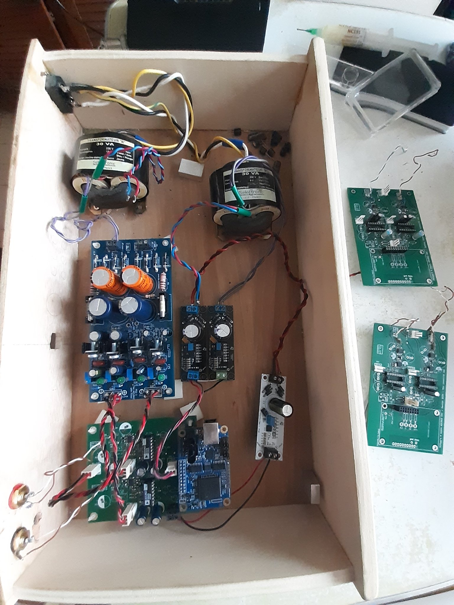

I'm collecting parts for the project. I ordered a 2x12v, 2x5v transformer. I already have psu 2. And now I look that I think I need 12v-0-12v and 5v-0-5v outputs. Does it matter what to connect to psu 2?
In my opinion, you ordered a very good transformer. You power PSU2 with voltages from a two-wire system. The voltages you write about (12-0-12 and 5-0-5) you will get at the output of PSU2.
5VAC is too low for 5VDC, even with LDO regulators. Minimum would be 7VAC, I take 8VAC for the LDO. For standard regulators (78XX, 79XX and similar), 9VAC for 5VDC and 14VAC for 12VDC. PSU2 requires separate secondaries for each voltage. So not 12V-0-12V & 5V-0-5V but 12V + 12V & 7V+7V.
Since he's already ordered the transformer, I suggest you try it first and see how the power supply behaves. There's always time for changes 🙂
go with 12/15V. I perceive a difference from 12 to 15 V....
I think I will try first 12V by // another populated miro PS board I have already. It is smd AD811 so thermal dissapation and max level is a bit lower. But the datasheet doesn't forbid the 15V for the smd package. But thermal noise should be avoided in theory.
Pffff, I forgot to purchase the white paste to put the heat-sinks !

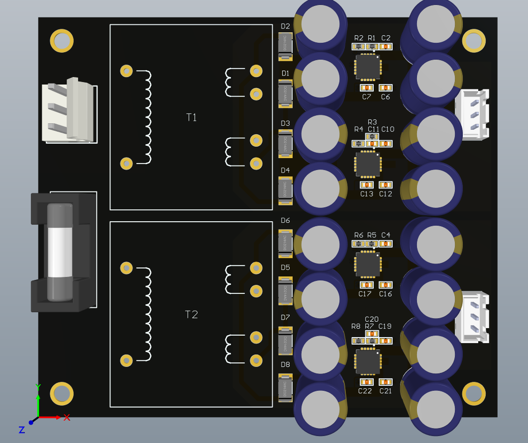

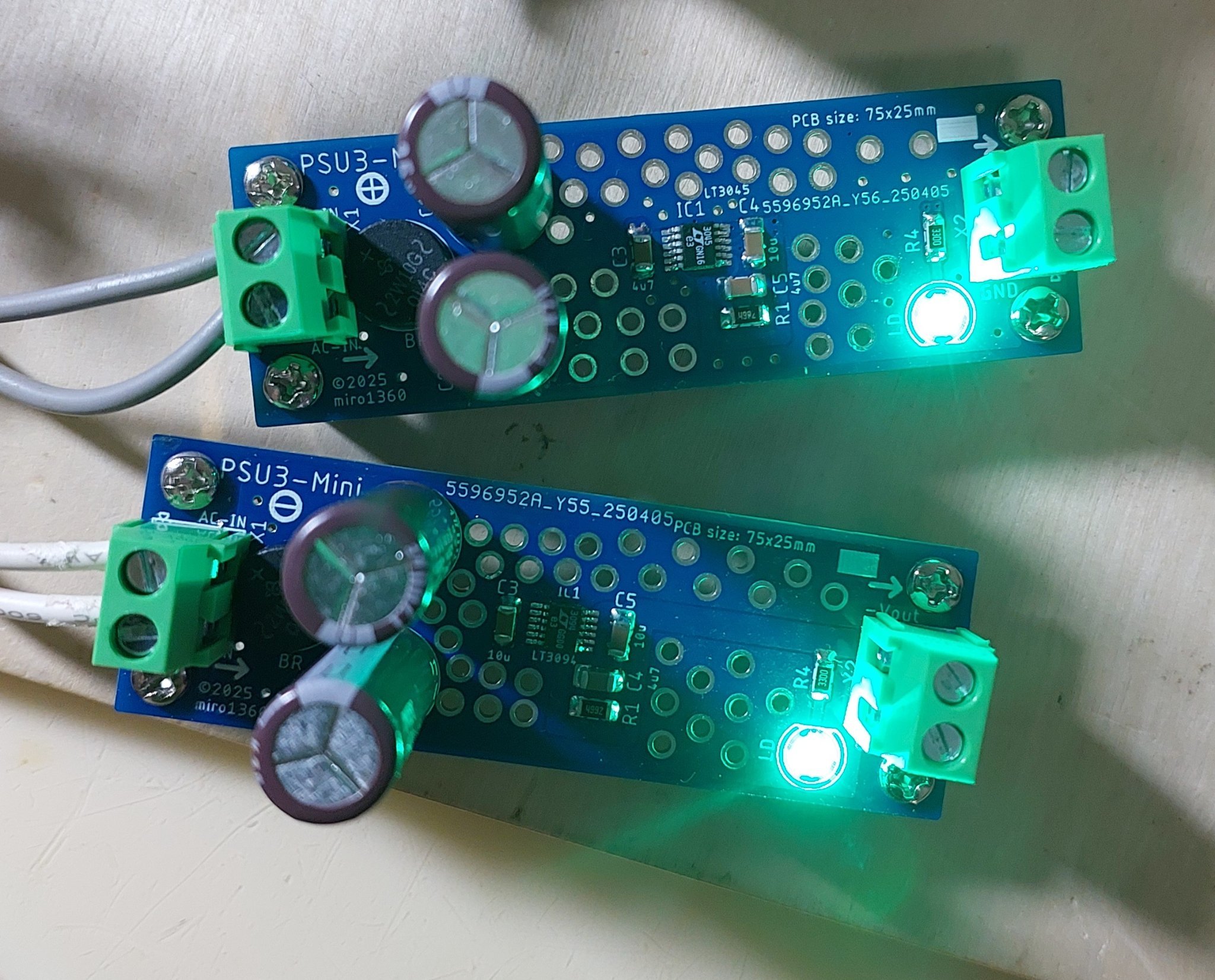

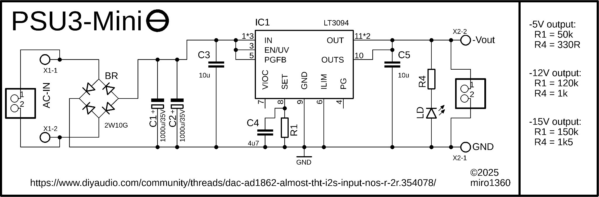

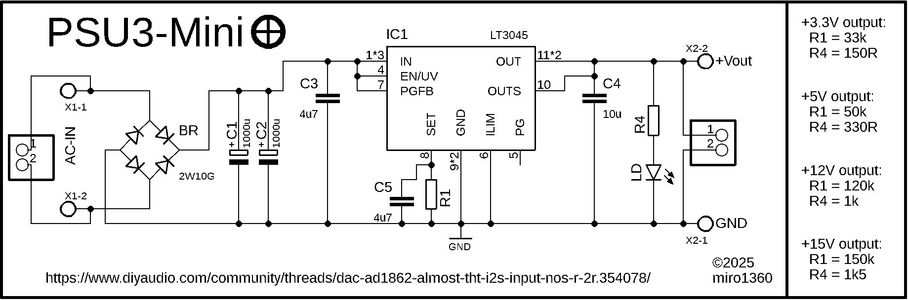

PSU3 Mini (LT3045/LT3094)
Ultralow RMS Noise: 0.8µVRMS (10Hz to 100kHz)
Ultralow Spot Noise: 2nV/√Hz at 10kHz
Ultrahigh PSRR: 76dB at 1MHz
+5V example:
https://eu.mouser.com/Tools/Project/Share?AccessId=5ebc7ee4a8
-5V example:
https://eu.mouser.com/Tools/Project/Share?AccessId=fdc404ea45

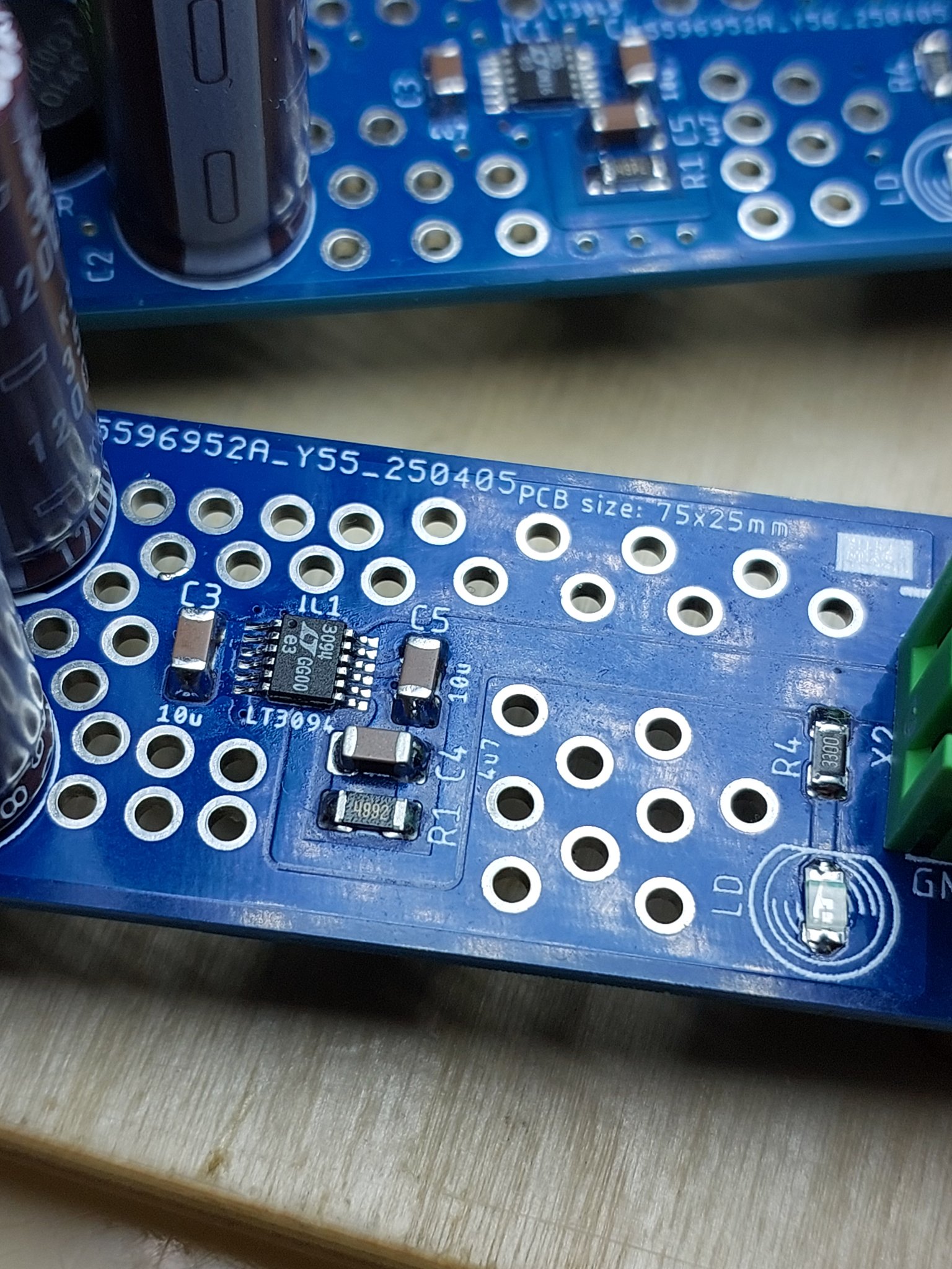

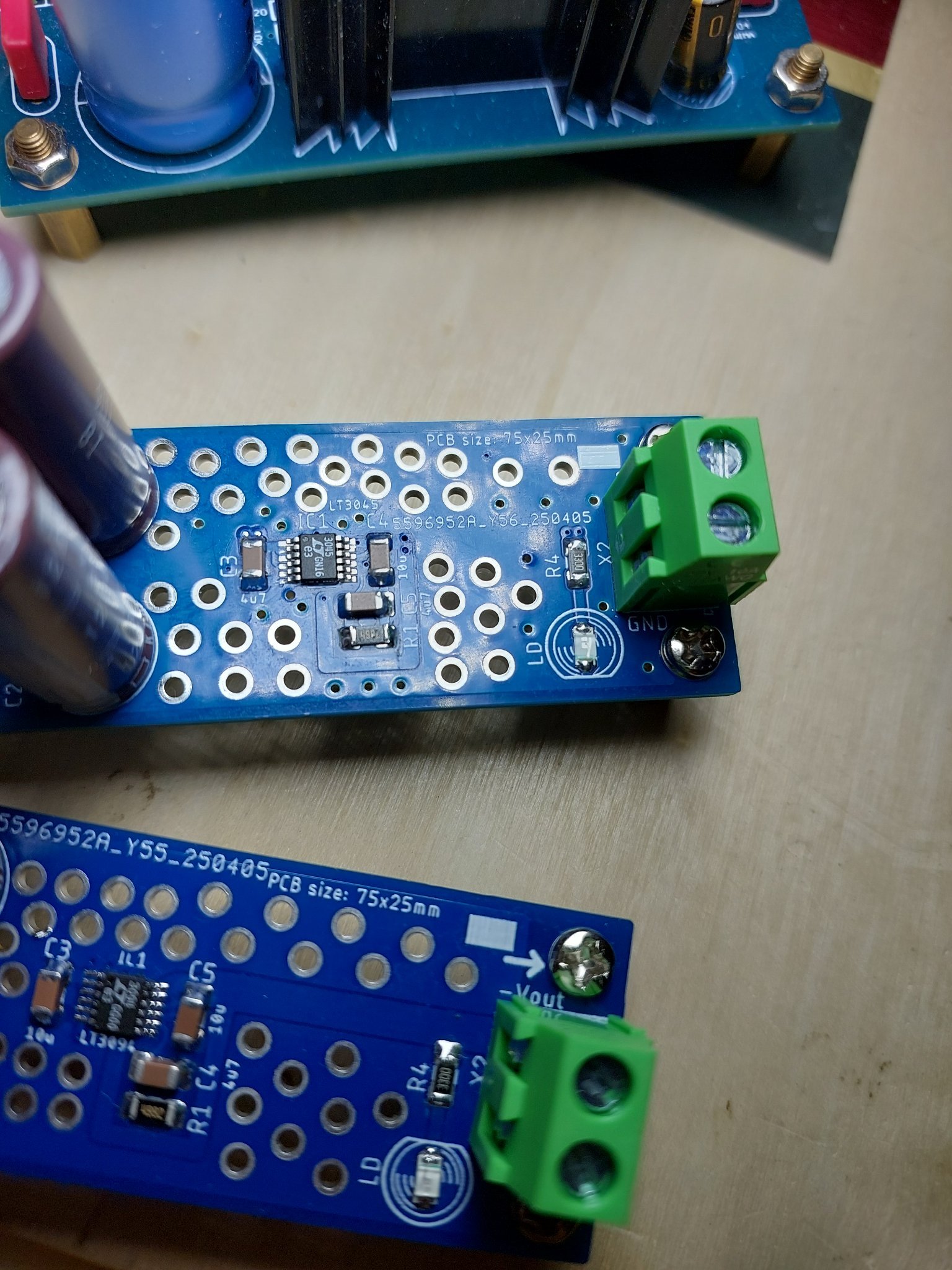

For 12V only the R1 and R4 is changed in value.
According to datasheet, be sure to use the exact capacitor parts for C3 and C5.
Very good regulators, but can be difficult to solder due to the small package
It is tested by:
@Sorenm and @zoom777
I use 6VAC 3W transformers for the DAC's 5VDC line because transformer is not 100% loaded and its output voltage is not 6VAC but higher.
Also the center-tapped secondary winding with 2 Schottky diode rectifier (instead of diode bridge) reduces the voltage drop, making it sufficient for 5V LDO even with negative line voltage tolerance.
Alex.
6VAC may be enough, but 5VAC is on the edge with diode bridge. The difference with one Shottky diode less is about 0.3V, but depending on the current it can be more. I always calculate that there may be a voltage drop in the network, there is also a ripple on the raw DC, so I secure myself with slightly higher voltages. Besides, I don't buy ready-made transformers, I mostly order good quality custom transformers here ( with static shield+magnetic shield), there is no reason to go to the lower limit. I can order any secondary voltage. I usually check everything with the PSUD2 simulator before ordering.
I also think that the static shield between primary and secondary windings is very important for audio devices. It does not affect the sound like some RF interference filters can, and it performs the same function. The magnetic shield allows me to place the transformer close to the PCBs without a trace of 50Hz hum.
Depends of a transformer. If it provide 6-6.5Vac with real load, all will be OK.
Low-power transformers have a fairly soft load characteristic.
BTW, my 3W (3.2W, to be accurate, this is ~0.5A) trafo have 7.9Vac @ no load, real load is ~0.25A.
With this current trafo's voltage is ~6.5Vac or ~7-8Vdc before LDO. I think if thes trafo will be 5Vac instead of 6Vac, also will be OK.
Alex.
And another little PSU 🙂 I found local source of 35x40 transformers with double 5 or 10v secondary windings. They are rated for 220V so the output is a bit higher that the spec. Voltage regulators are tps7a4701/tps7a3301. The board is 100x86mm

Interesting PSU3 Mini!
Just 2 questions:
Many thanks!
Claude (at the beach so perhaps dumber than usual 🙂)
Just 2 questions:
- why not going CRC after the bridge rather than CC? An additional say 5R / 2W resistor could spacialy fit and provide a 31Hz Fc traditional RC filtering
- why is the board so long?
Many thanks!
