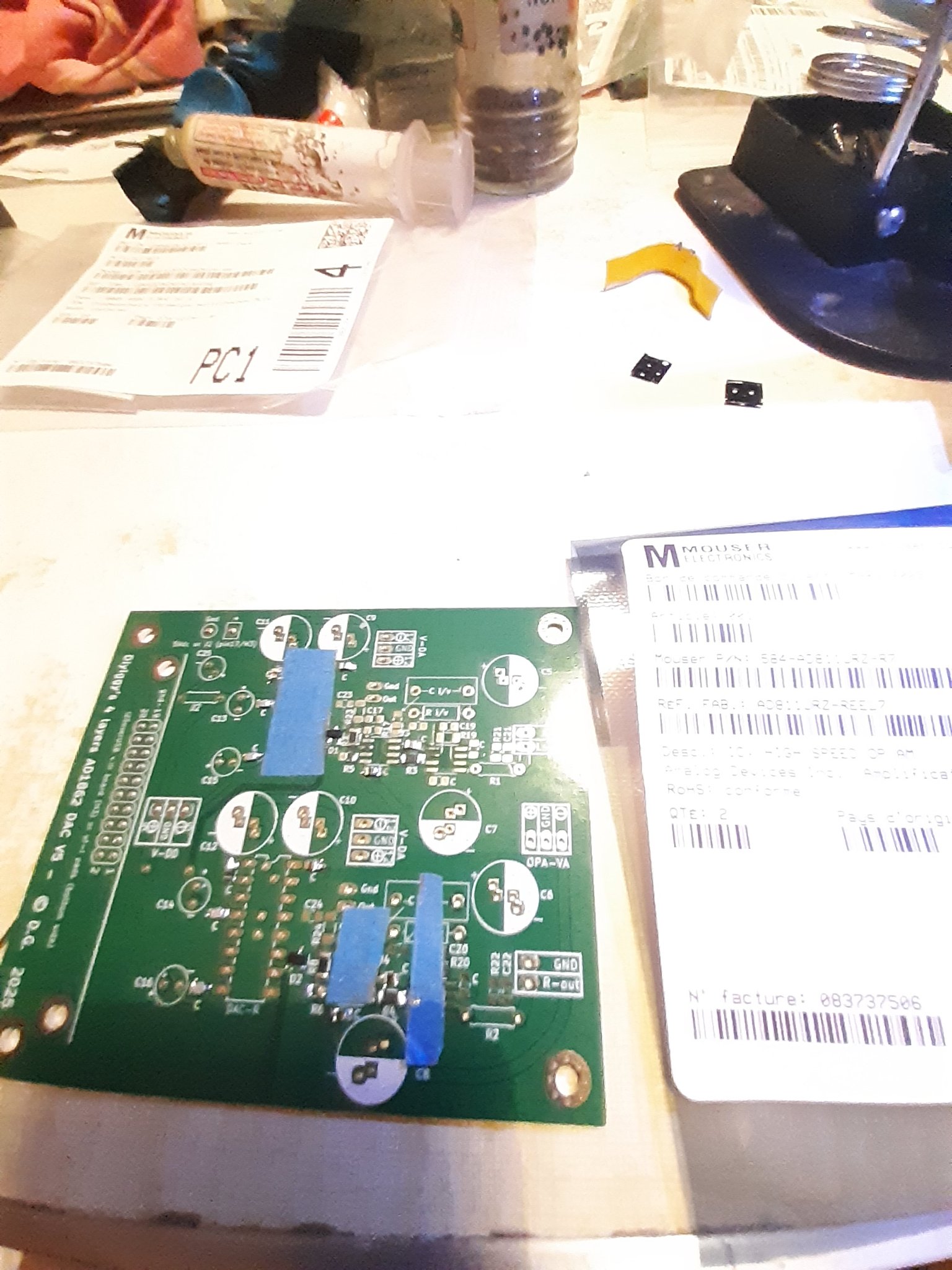

Damn, those smd tinny things... A lot of 0805 cases, few 1206... I enjoyed to solder 0605 cases on 0805 pcb foot print...
Beginning with the ad811... then the 0pa861, then op961, then ADA4899.

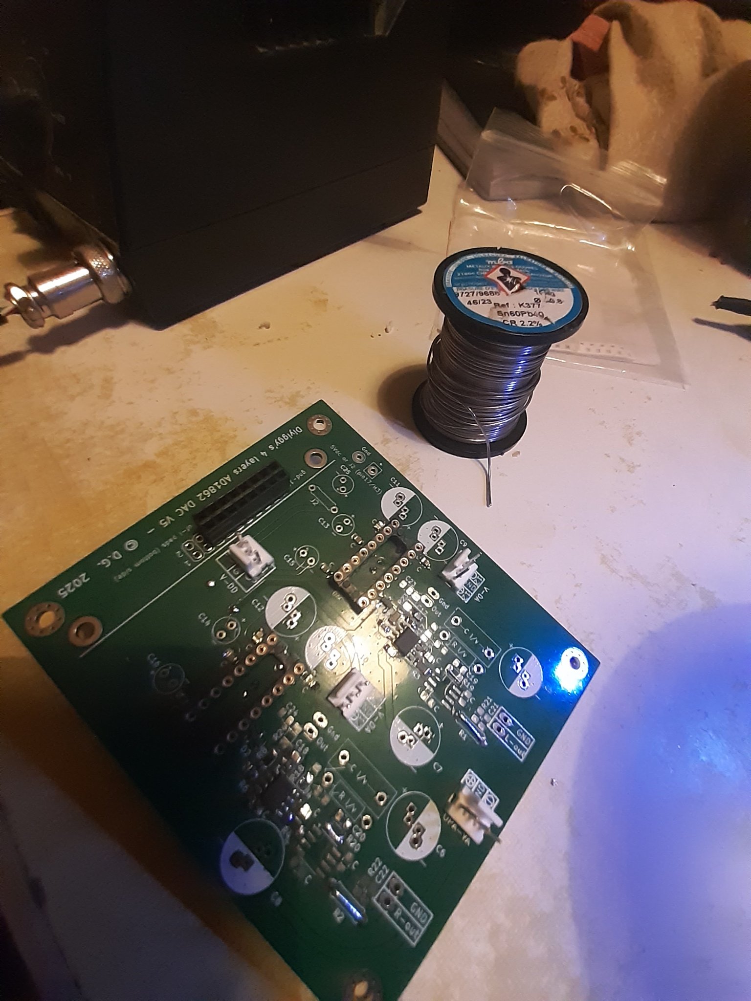

Ah, I should be able before the end of the week to test my v5 4 layers board with Grunf's BOM but the feedback cap which is a simple TDK C0G soft terminations).
