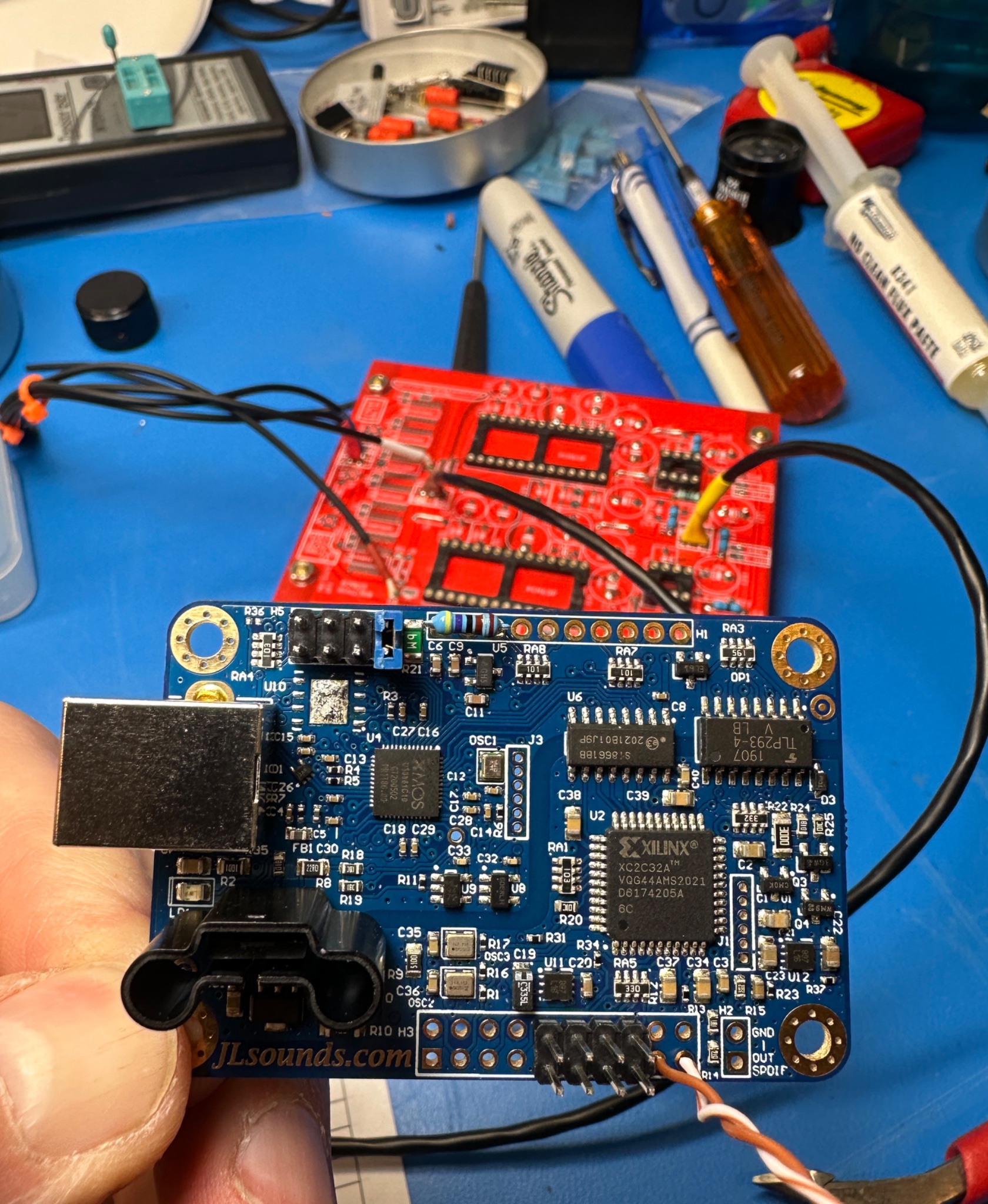

JLSounds question - v.III (current version) without isolated outputs
For use with PCM63 board, I want to have it configured like this? I think this is right but I'm still scratching my head..
4K7 between H1.1 and H1.3
J4 close
All “B” jumpers open
H3.9 Data L
H3.11 BCLK
H3.13 Data R
H3.15 LRCK
H3.17 5V
H3.19 power ground
J4 close
H3.9 Data L
H3.11 BCLK
H3.13 Data R
H3.15 LRCK
H3.17 5V
H3.19 power ground
Ah! looking at it I have the connector correct and the text in the post incorrect. Good catch though, thank you.
It is. The i2S are all coax and the grounds are connected.
Thank you! Should have it powered up later tonight.
You have got the Data L and Data R swapped.
Don't forget to connect the JLSounds ground to the DAC board ground at the i2s inputs.
Image of the DAC board is at the background is blurry but if you have not populated R1 and R3 (22 Ohm), please do. Alternatively, just use wire to short them.
Is playing beautifully, thank you @zoom777 for your prompt and expert assistance, is very appreciated.

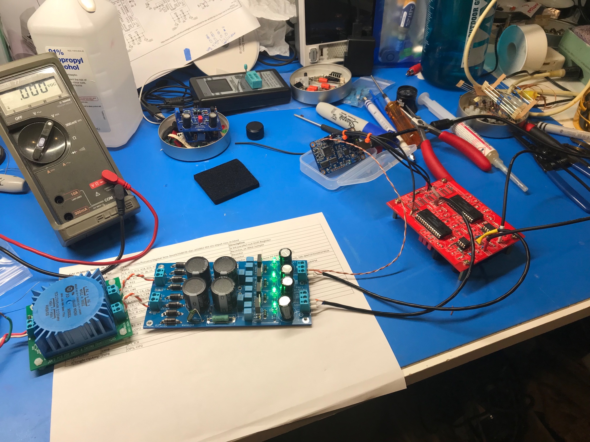

And thanks @Sorenm for the PCB. I have a nice chassis for this one, it’s going to look great. 🙂
Hmmm... looking at this photo I see I've got the JLSounds powered on by the analog side of the PSU. Will change that and well as the power wiring when I breadboard.

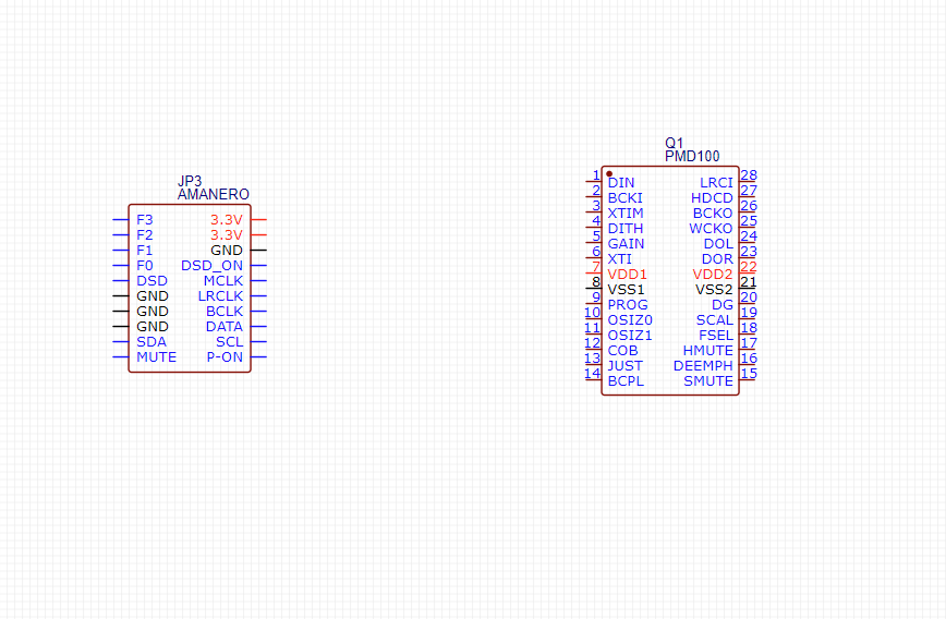

Original Amanero or chinese clone?
If original, there seems to be a need for firmware update.
If it is a clone, then i am not sure what you can do.
Anyway i suggest you try the Amanero thread or contact the maker.
I have solved the issue with the Amanero talking to the PMD100 chip. There was a firmware update for a DF1704 filter chip with reduced clock speeds in the list. I tried that and all is ok. Thanks to Domenico and his multitude of software options, this usb-i2s converter has got to be one of the most versatile of all the current popular converters available at the moment.
yes it is a chinese amanero: but the problem is not only amanero i mean the i2s usb card connection for pmd100
pmd100 page 17 figure 4? see if it can be referencedyes it is a chinese amanero: but the problem is not only amanero i mean the i2s usb card connection for pmd100
PMD100 needs either 256fs or 384fs system clock (MCK). Some USB-I2S boards have 512fs MCK which does not work properly with PMD100.
