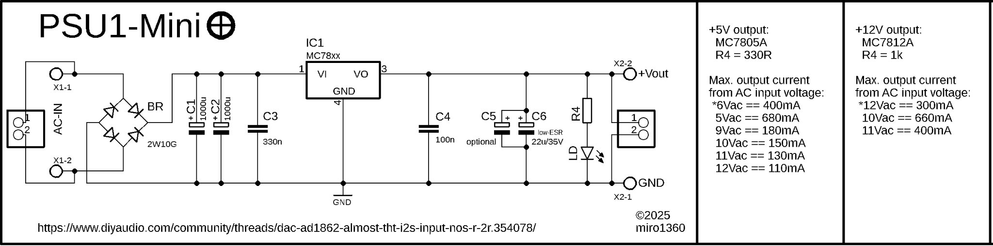

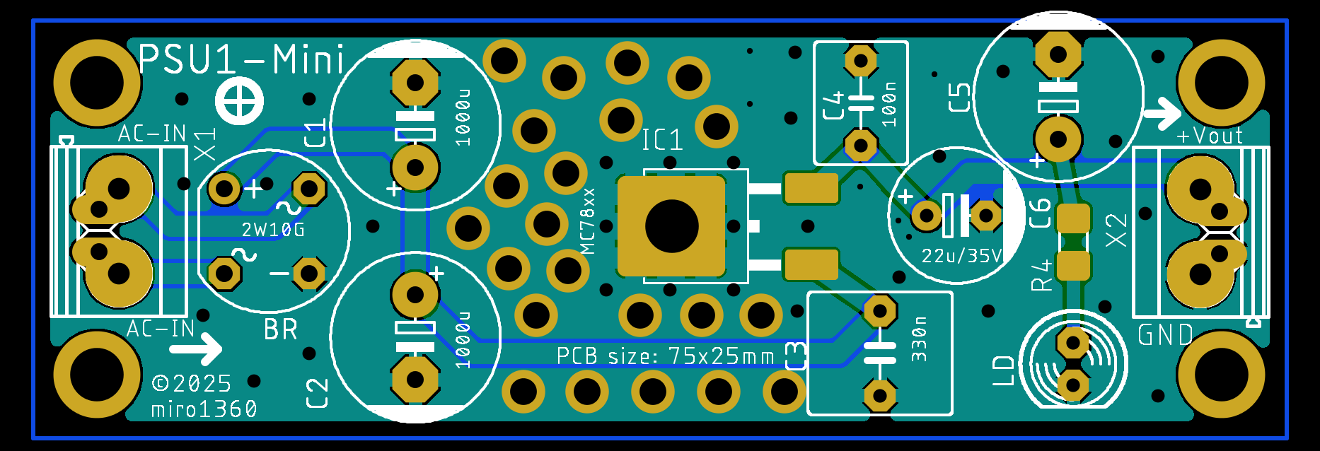

PSU1 Mini (Plus)
PCB size: 75x25mm
Mouser example +5V: https://eu.mouser.com/Tools/Project/Share?AccessId=44b0a47657
Mouser example +12V: https://eu.mouser.com/Tools/Project/Share?AccessId=cbdabd1f70
PCB size: 75x25mm

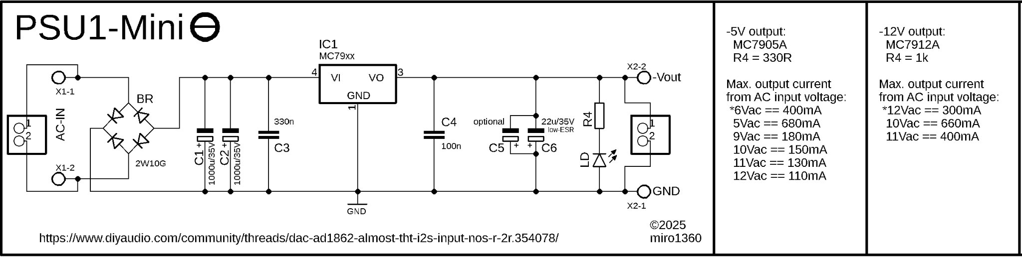

PSU1 Mini (Minus)
PCB size: 75x25mm
Mouser example -5V: https://eu.mouser.com/Tools/Project/Share?AccessId=ad0ec14220
Mouser example -12V: https://eu.mouser.com/Tools/Project/Share?AccessId=63022a8694
PCB size: 75x25mm

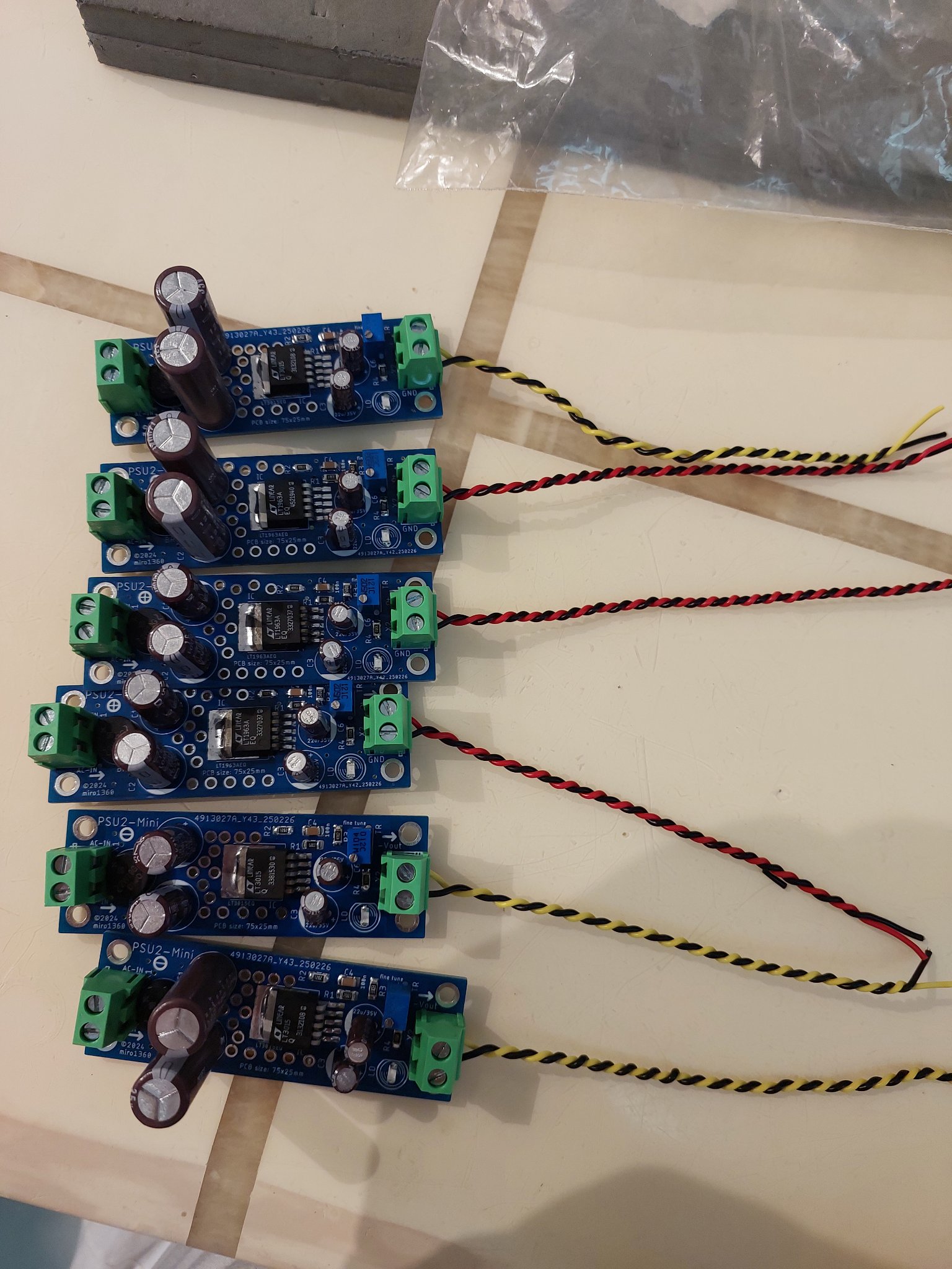

"Nice mini PSU's @miro1360! I am a big fan of the PSU2 minis"
Me too! They perform very good at a niceee price.
I will get my JLCPCb cart ready .. 😀Nice mini PSU's @miro1360....
Any chance of future mini boards for lt3045/lt3094 in the MSE/exposed pin package ... 😊

PSU1 Mini (Minus)
PCB size: 75x25mm
Is now vias in pad free at JLPCB ?
Have you thougth about ading a serie 10R/1W carbon between the diode bridge and the first smoothing cap ? It work very fine.
I am glad now the with the 78/79xx the last reservoir cap near the load is bigger than the one after the reg output pin ! 🙂

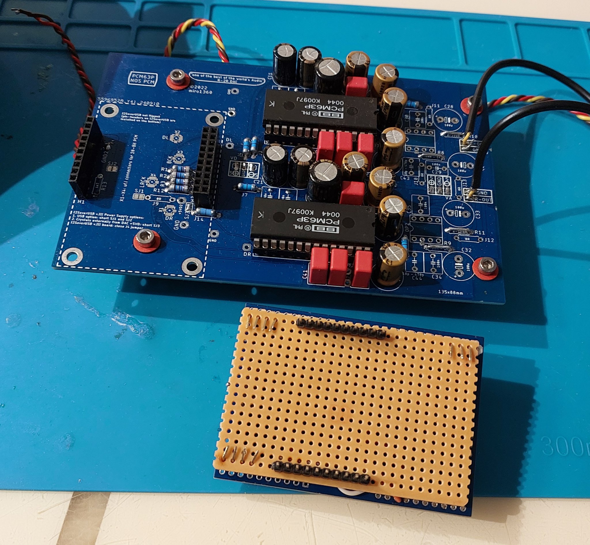

Could anyone help me to find the post number to get this version for pcm63?
Thx
It is buried deep in this thread.
@iitzex , have fun.
@iitzex , have fun.
diyAudio_PCM63P_DAC_v1.4_uf.l_jlsounds-notFlipped_align_2022-12-22.zip771 KB · Views: 63
diyAudio_PCM63P_DAC_v1.4_uf.l_jlsounds-notFlipped_align_PCB.jpg426.5 KB · Views: 149
diyAudio_PCM63P_DAC_v1.4_uf.l_jlsounds-notFlipped_align_Schematic1.jpg281.2 KB · Views: 154
diyAudio_PCM63P_DAC_v1.4_uf.l_jlsounds-notFlipped_align_Schematic2.jpg162.7 KB · Views: 150

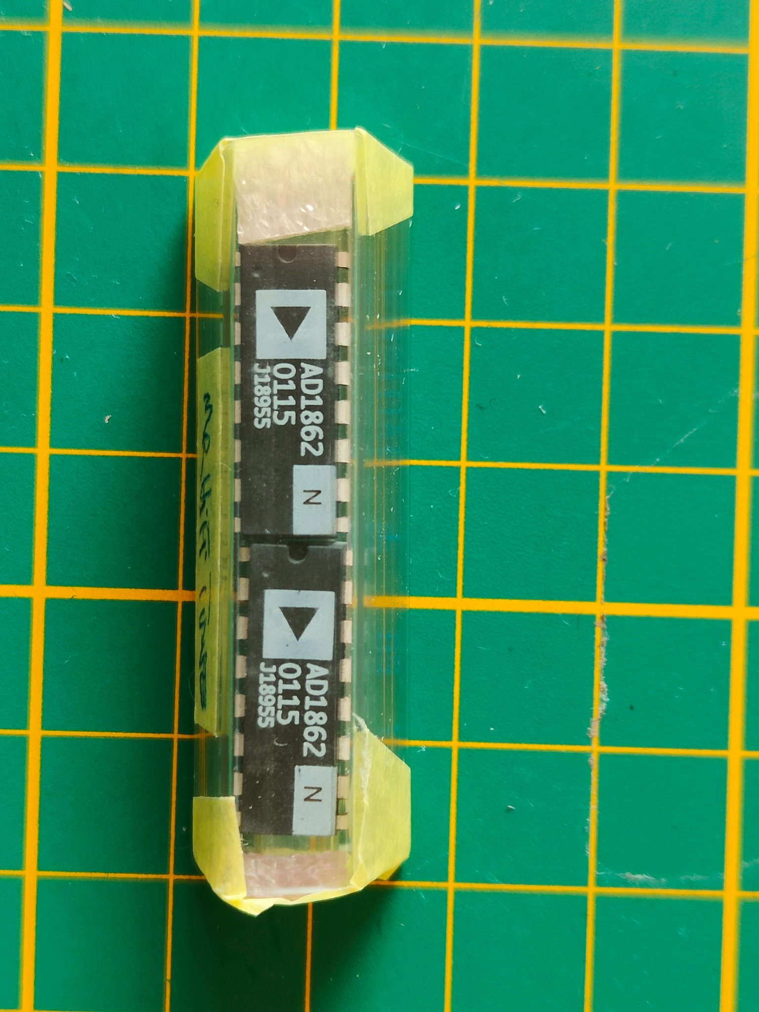

After lurking on this thread for. A while, I decided to build my own MIRO AD1862 dac.
Paddy Garcia helped me to get the AD1862 DAC chips. Many thanks for that. 🙏👍.
For power I have some modified Jung/Didden boards.
Now what I need is the DAC PCB board. Anyone who can help me out with that?
I'm a bit afraid to solder the shift registers.
I don't want to go the route to use the JLSound boards. (Prefer to use some more general like amanero, u30 or ...)
I don't know what options that I have?
Is the CPLD board a valid option?
AD1862 is no I2S input compatible so you need logic after I2S output boards like Amanero is.
Miro's cpld is an option as the offers here of I2S to AD1862 diy pcb boards already soldered.. But if you're afraid to solder the shift registers, be aware the cpld is way tinnier and harder to soldering. So go for an already soldered board instead a raw board to populate.
There is not particular difficulty with the shift-registers. You just need using flux and magnyfing glass and look at some Youtube soldering HOW TOs.
Be aware too, Amanero's clones are not very good on the clock quality.
