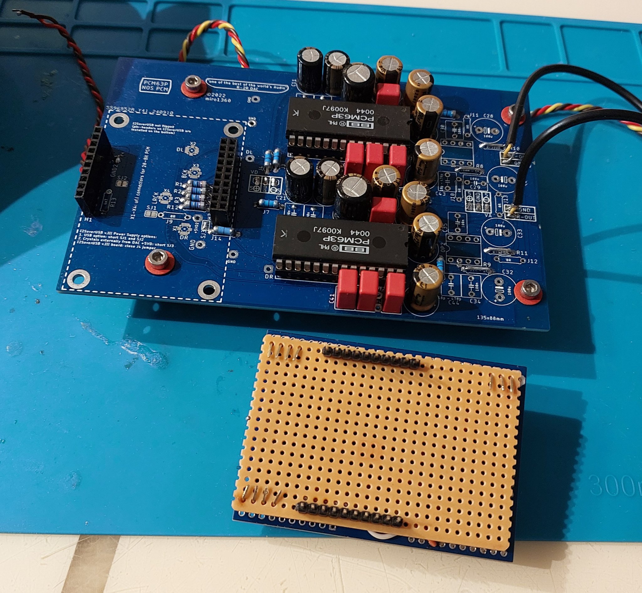

I know I'm way overdue for my AD1862, but I've been waiting a long time to buy it. But in the end it worked and I can enjoy its sound. It's hard not to love you @miro1360 . A big thank you also to @zoom777 for his advice on starting the system (you are a great friend 👍)

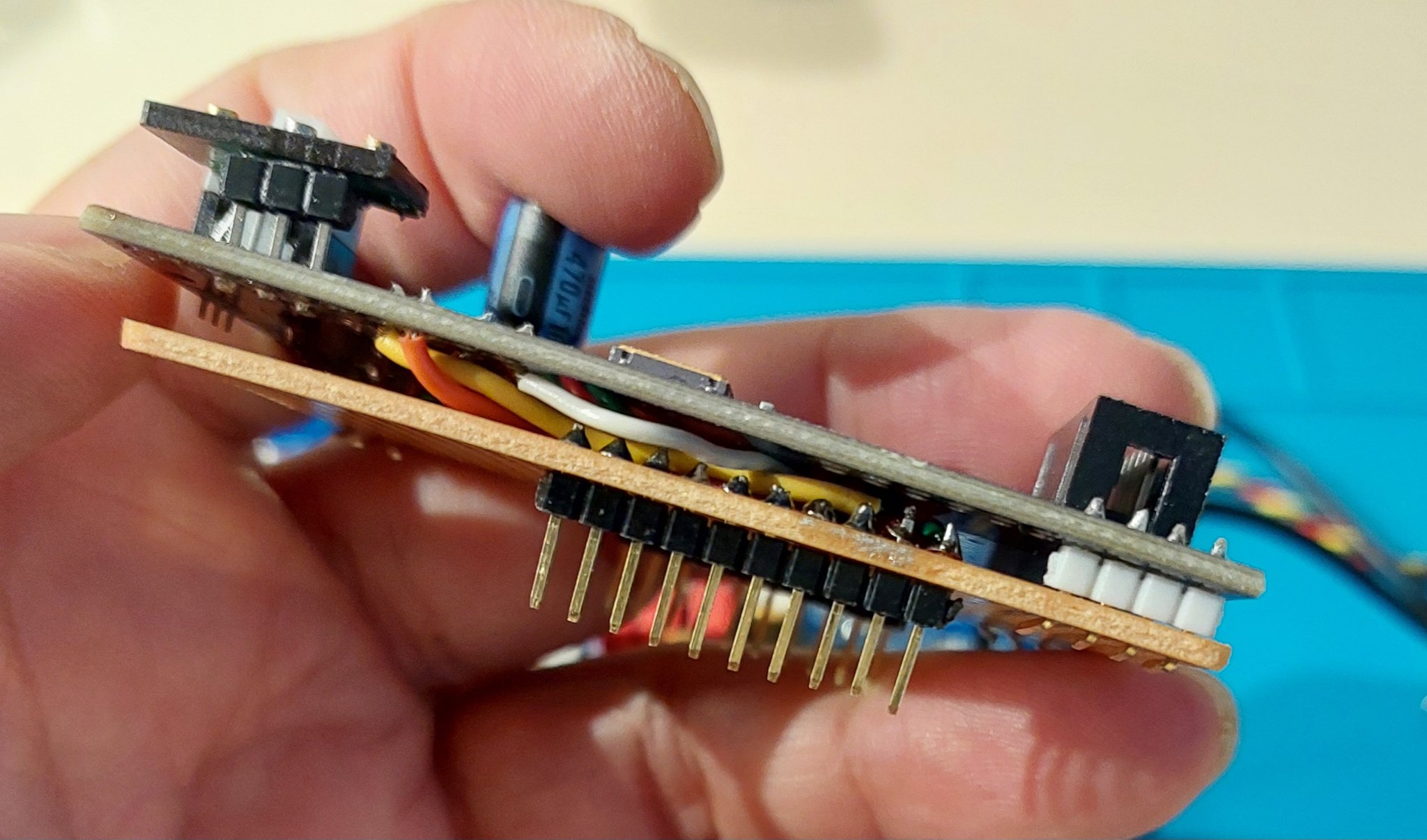

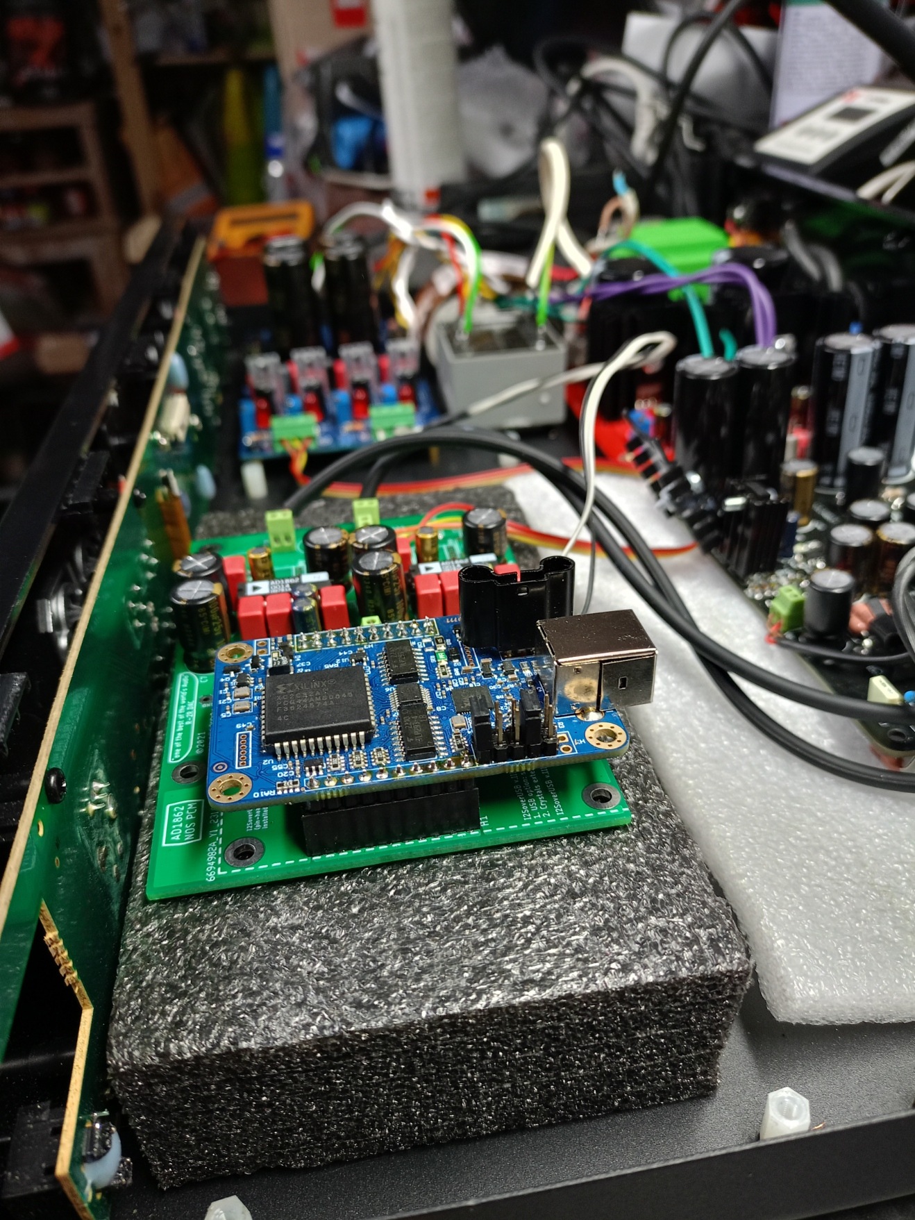

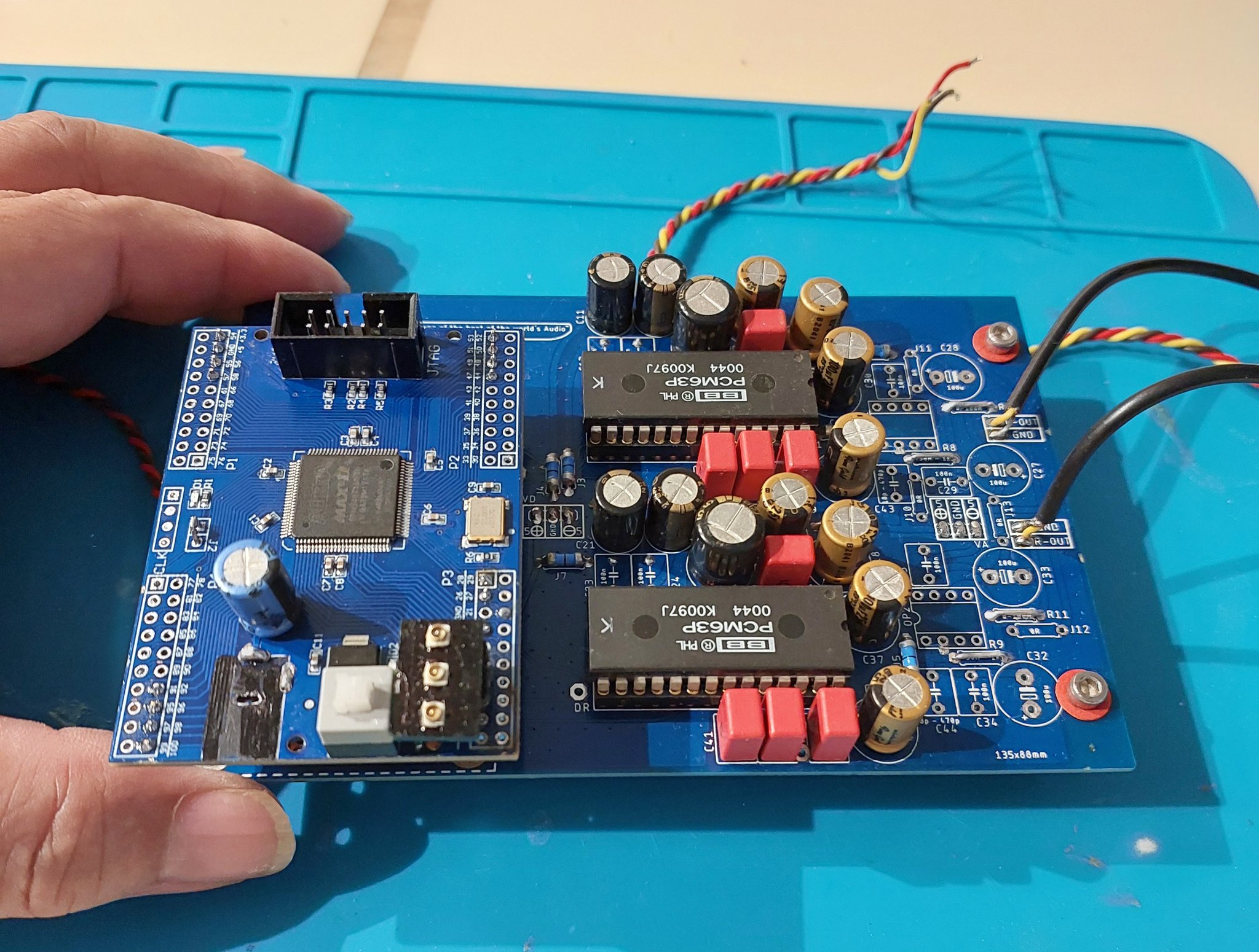

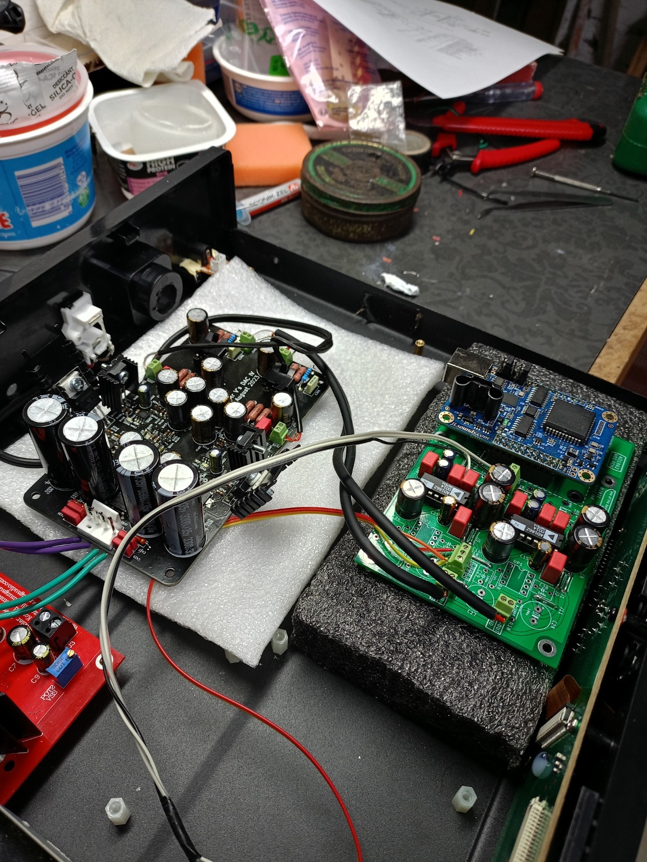

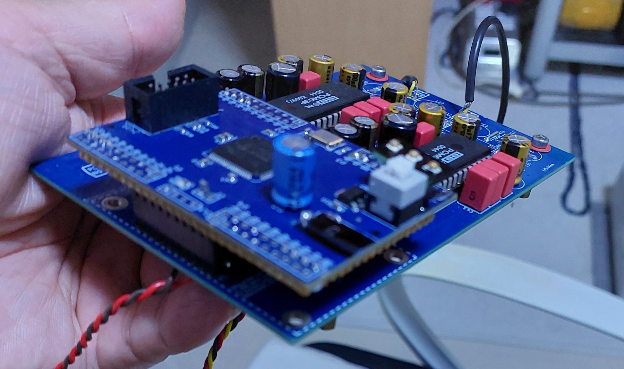

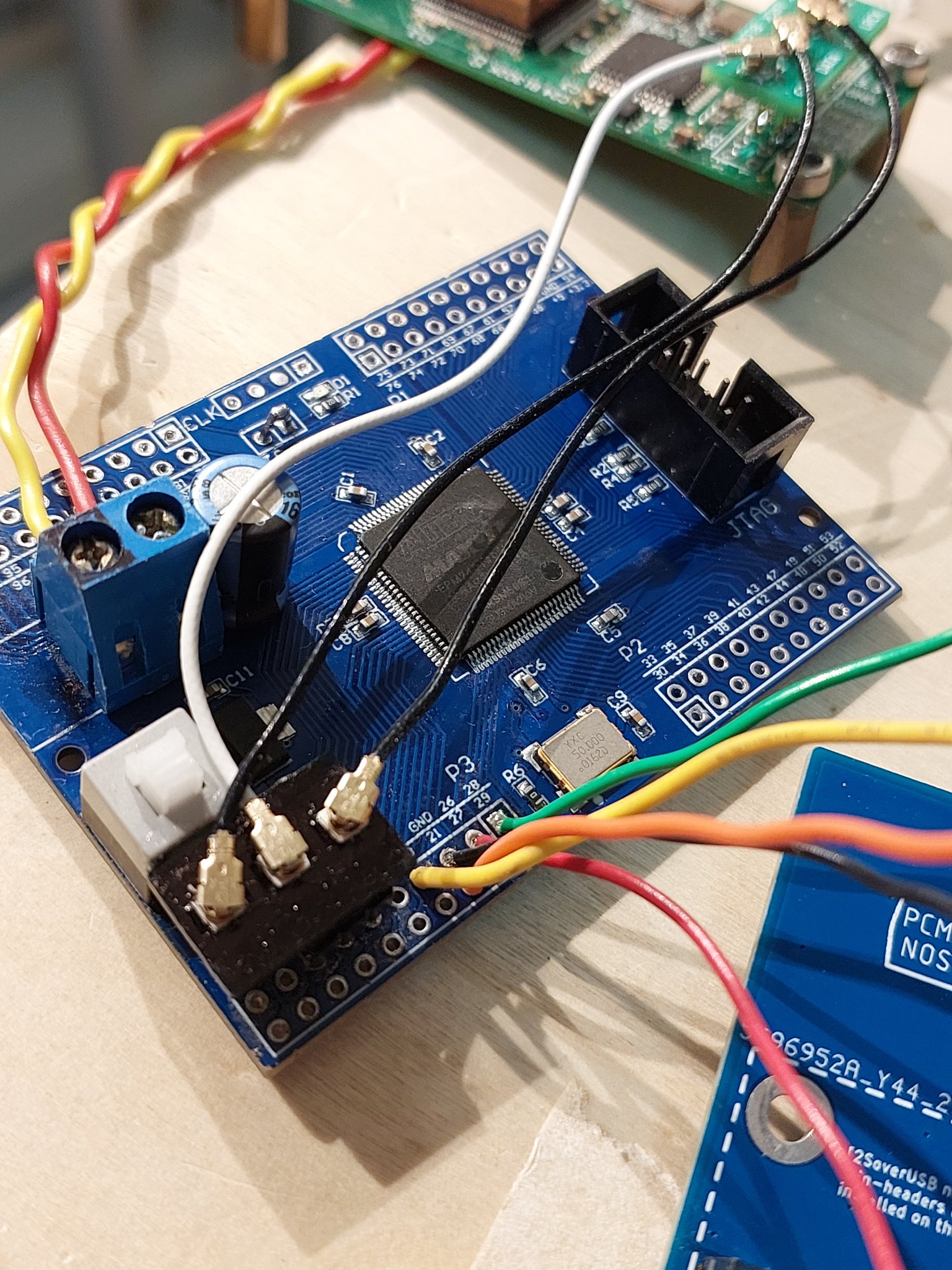

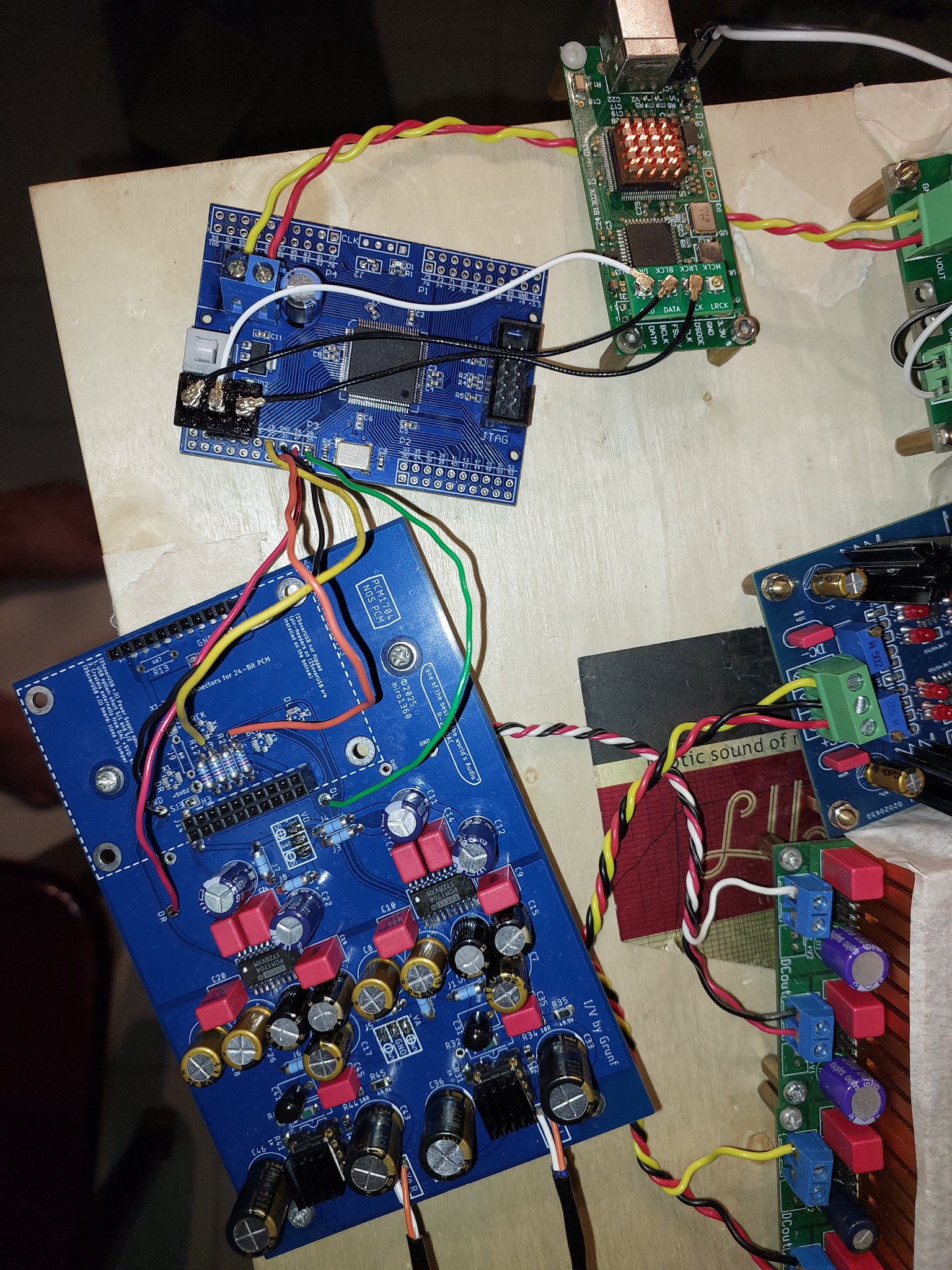

Pardon the mess, just testing if the programming on the CPLD is successful. I just want to say that Miro's 24Bit VHDL programming works perfectly. Converts i2s to PCM using a CPLD board, skipping shift registers ( are they really that bad?) , and using an existing Amanero USB interface. Building this for a friend who does not want to invest in a new USB interface ( York, JLsounds) .
Works perfectly, no noise no digital glitches. On the actual implementation, the wires will be very much shorter, of course it has to be.

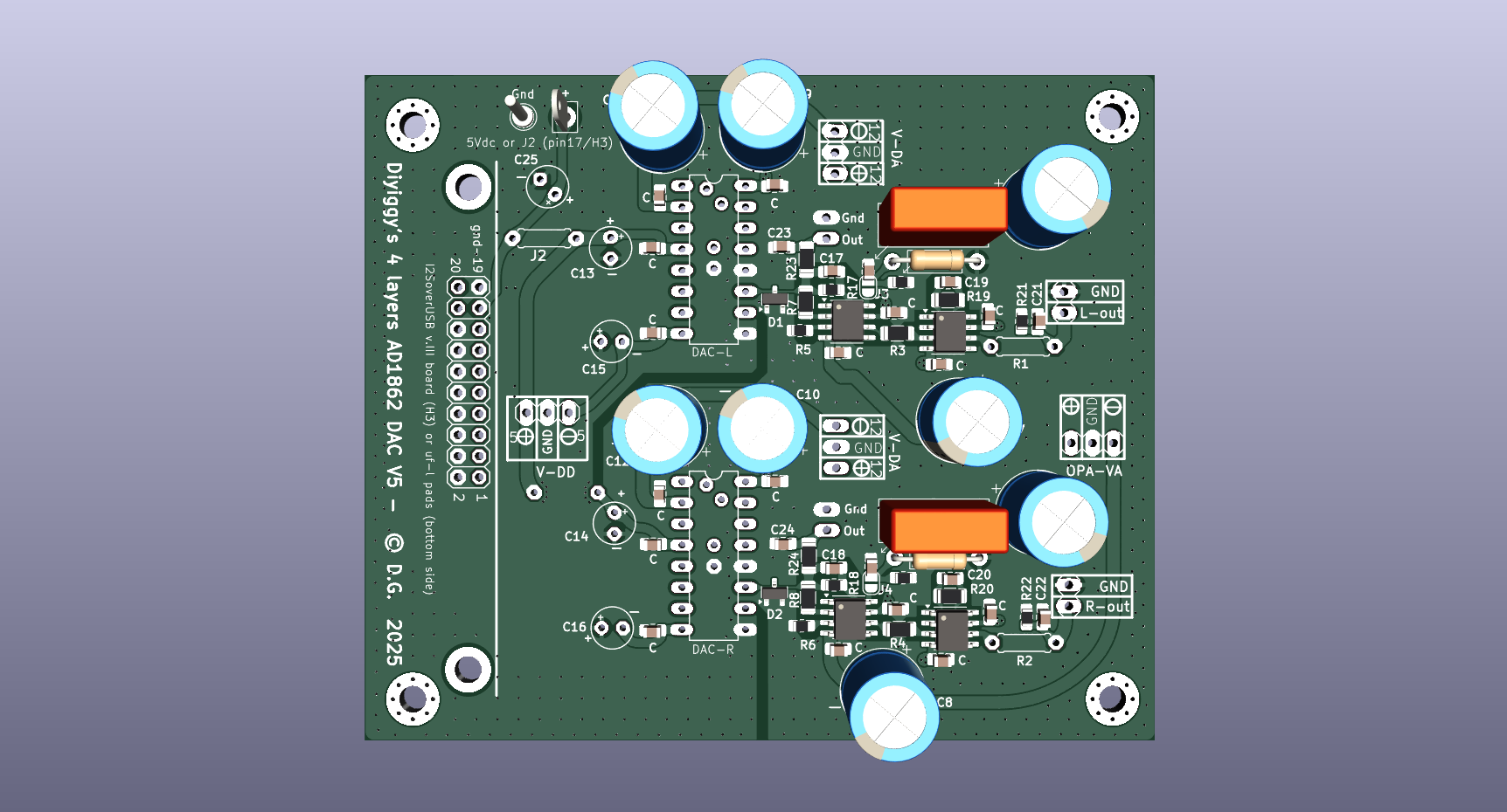

Finished the last V5 iteration of my 4 layers AD1862 pcb and ordered a batch of 5 pcb.
It has the same features of the last : designed for high speed single opamp. Has a voltage follower (buffer, etc) op amp that can be easily bypassed but can be usefull for ome I/V op amps, headphones or digital volume chips.
4 layers to enhance the capacitance of the ref layers and to avoid signals and power crossings with a carefull routing and forced current paths playing with the layers and THT decoupling.
Independant power inputs for the op amps.
Made to work with I2Sover USB v3 board or 4 uf-l pads at the bottom side for iancanada I2StoPCM board or any DIY USB to AD1862 front end.
What I added in the V5 is the possibility to use not only the VFA op amps but also the CFA (it is compatible with AD811 Grünf dissident design but in SMD version of the AD811) and the transconductance OPA861 in emitter input transimpedance mode. That's is for I/V first op amp. The second op amp is only a voltage follower for buffer (G+1) or more gain.
It was a little tricky to find the good layout for the op861 layout pcb compatibility w/o sacrificing quality. But I added via a jumper the possibility of its use with the choice of either SMD or/and through hole Resistor i/V and Capacitor i/v as it is important in my experience to voice it for best results.
It has also an output and Gnd vias near the AD1862s to plug a pcb for a future discrete I/V design or wirering for tubes with or w/o the possibility to proceed of the passive I/V (smd).
Output protection for the AD1862 and filtering options via passive smd caps and/or resitor (Rutgers pdf for illustration) were enhanced and permitts the use of external compensation.

Have made a pretty BOM at Mouser with 3 new op amps included the AD811 and the expensive resistors Grunf advised for it...
I have made last years sevral 4 layers proto you can see in the thread to use some opamps combo...
I'm looking forward to use the op861 with a Rhopoint resitor and its tin foil polystyrene caps which had given very good result in my main TDA1541A dac. If not giving the same magic, i wanted to add two smd resistor and caps options to have the possibility of a theorical better layout than the throug hole option for the op861 I/V.
