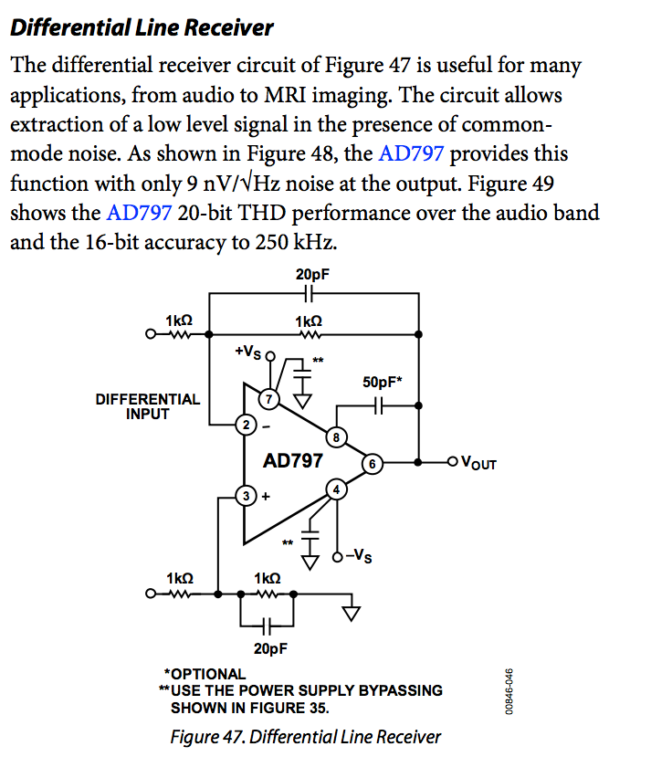

page 17 of 19. Figure 54 of the datasheet. Skip C1 if not needed.
There's no mention of 47pf between pins 6 and 8 on Figure 54. There is on Figure 47, but that's a differential configuration.
Would you use 47pf on just the AD797 or would it also apply to e.g. AD845, AD843, AD847 etc.?

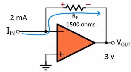

I'm trying to understand opamps a little better. Does the opamp in the DAC circuit operate as a transimpedance amp converting current into volts? Does the following picture make sense? +/- 1mA (AD1862 output) X 1.5 kOhm (feedback resistor) = 1.5 Vp (3 Vp-p output).
I'm trying to calculate gain to be able to properly compensate the opamps used. What is the gain in the example above? Thanks, Tom
There is no gain. The opamp must maintain the same voltage at both inputs, and the noninverting input is at GND. That's why the opamp generates an output voltage that will generate a current through Rf of the same value but in the opposite direction from Iin so that it maintains 0V at the inverting input, i.e. virtual GND.
In that picture, the direction of the current is not drawn correctly.
