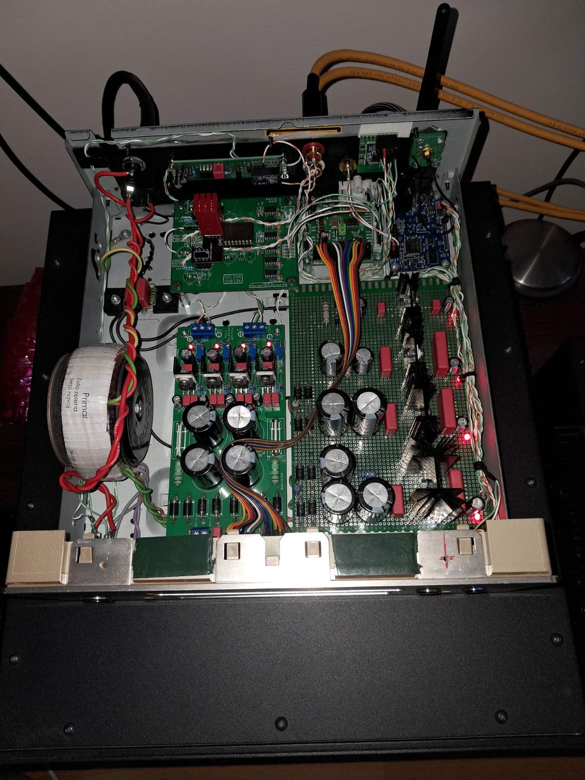

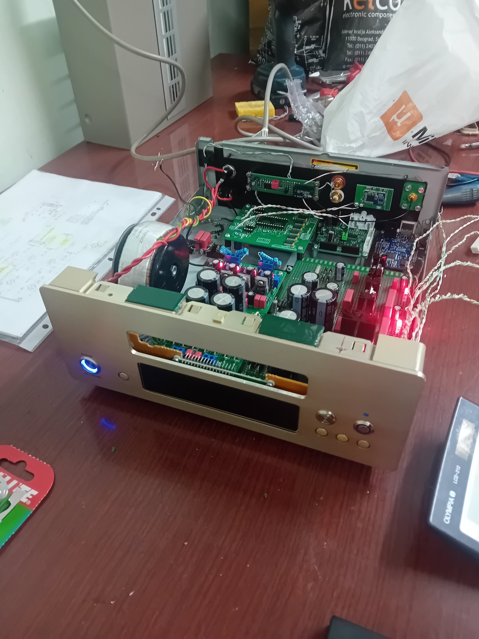

Another Miro AD1865 is in operation. My friend did it up to 90%, I just completed the wiring. Power supplies for the analog part are LT1963/3015, for the digital part LM1117T. It has everything and anything, USB, Toslink, SPDIF, and Bluetooth. BT is turned off when not in use, so it doesn't send interference to the rest of the circuit. USB board is JLSounds, SPDIF board is AK4113. The BT module has an SPDIF output, connected to one of the two SPDIF inputs of the AK4113 board. Opamp is Burson V6 Vivid dual + adapter dual/single. That opamp gives a slightly softer sound in this combination, I prefer the rougher sounding Sparkos SS3602 with the AD1865.

I have the ad1865 an ad811 output, it's my companion on the desk at work... Did you try the ad811?

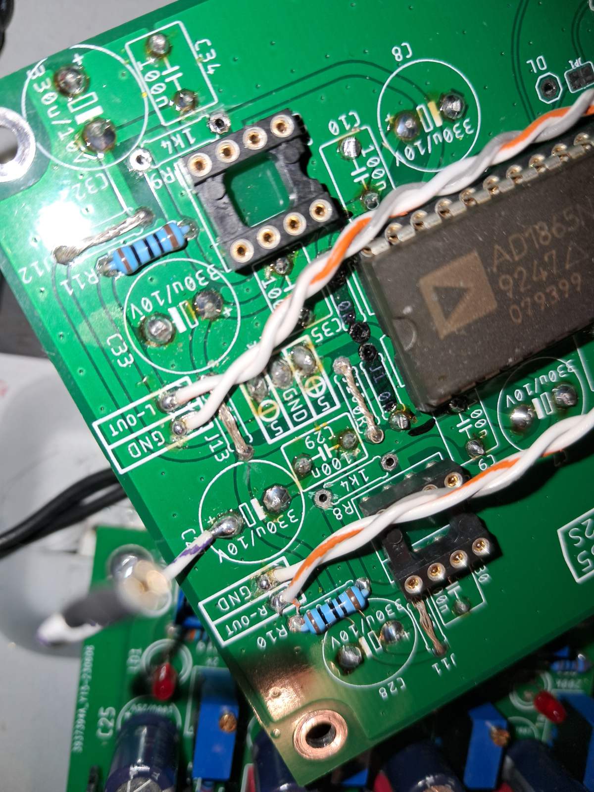

I wasn't overly happy with the sound, and last night I desolder some regular noname metal film resistors for the RIV and installed the DALE 3.01k RN55D. What a transformation, this is now a completely different DAC. Need to get DALE 47ohm for these output resistors too, and replace these nonames. At the moment I have nothing with so little resistance from DALE.
