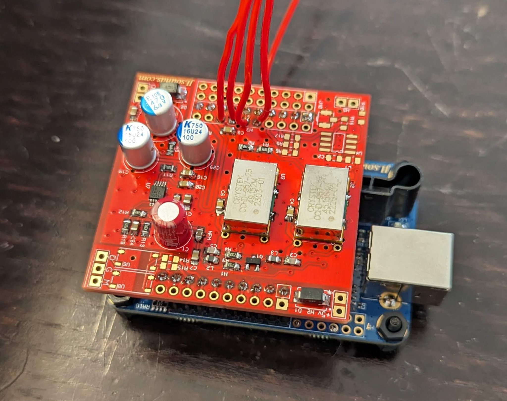

I use the JLsounds Oscillator board which stacks right on top of the I2SoverUSB card. I can't comment on how it would compare with the Ian Canada stuff.
@ Sorenm, when using external clock did you notice any improvement. Which crystal oscillator do you use?
My friend use Ian Canada SC-PURE and he is very satisfied with improvements.
https://www.audiophonics.fr/en/comp...-ultra-low-phase-noise-491520mhz-p-18254.html

@Tesla Audio I never used the I2SoverUSB without the external oscillator board so can't comment on the improvement. I use Crystek 957 clocks.
A while back, I added one of Ian's ultra capacitor boards to power the I2SoverUSB and oscillator 'stack'. This made a noticeable difference. Especially in the low end/bass. What a rabbit hole 😊
