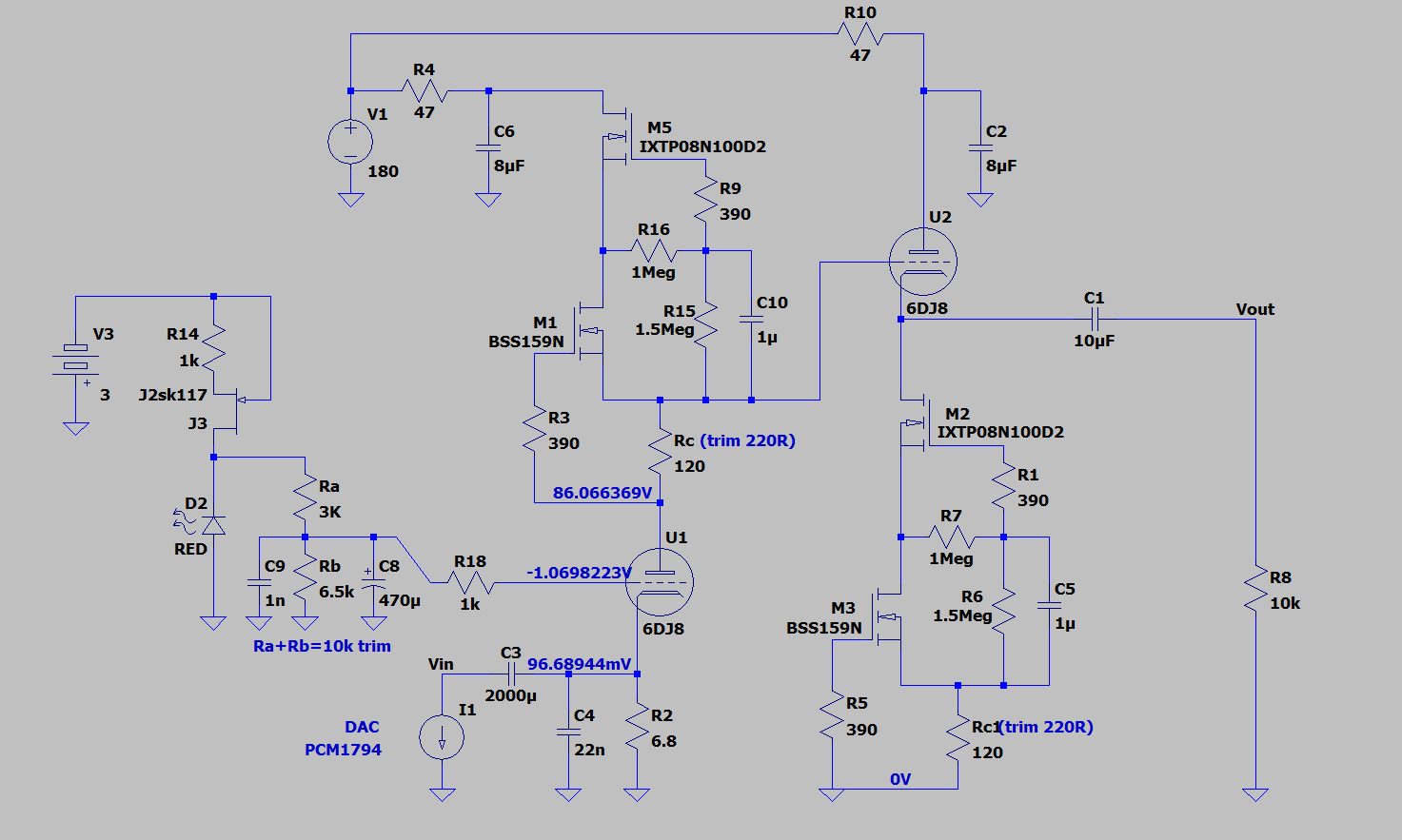

i am not sure if it was defective or i killed it .. i made a stupid mistake when i connected the power supply headers the opposite way at first try . +5v to -5v and vice versa . both fuses of the miro v2 power supply blew and then i saw it and put the headers the right way . The other chip seems ok i hear music without any audible noise .Why don't you use it as an active I/V, picture 5.?
Didn't that device accidentally kill that one PCM 1702? 🤔
So it is an active I/V .. i thought it needs an I/V resistor seeing grunf tube circuit 🙄

I used a 6S4P for one PCM1702 which has almost four times the gain of the ECC86 and that's the whole problem. The PCC86 has too little gain just like the ECC88 for the current of 1-1.2mA of the PCM1702 or AD1862. It is necessary to choose a tube with a higher gain and then the Riv can go low. Good triodes for IV, in my opinion, are all with a higher amplification factor, such as EC86, 6HM5 and similar. Then the possibilities for playing with Riv with a sufficiently large output voltage open up.i am not sure if it was defective or i killed it .. i made a stupid mistake when i connected the power supply headers the opposite way at first try . +5v to -5v and vice versa . both fuses of the miro v2 power supply blew and then i saw it and put the headers the right way . The other chip seems ok i hear music without any audible noise .

I was also more satisfied with the sound of the tubes with higher amplification than with, say, the ECC88. For example, ECC88 could be great for PCM1794, which will be my next candidate for a diy DAC (and to solve those 100mV on the cathode 😉 ).

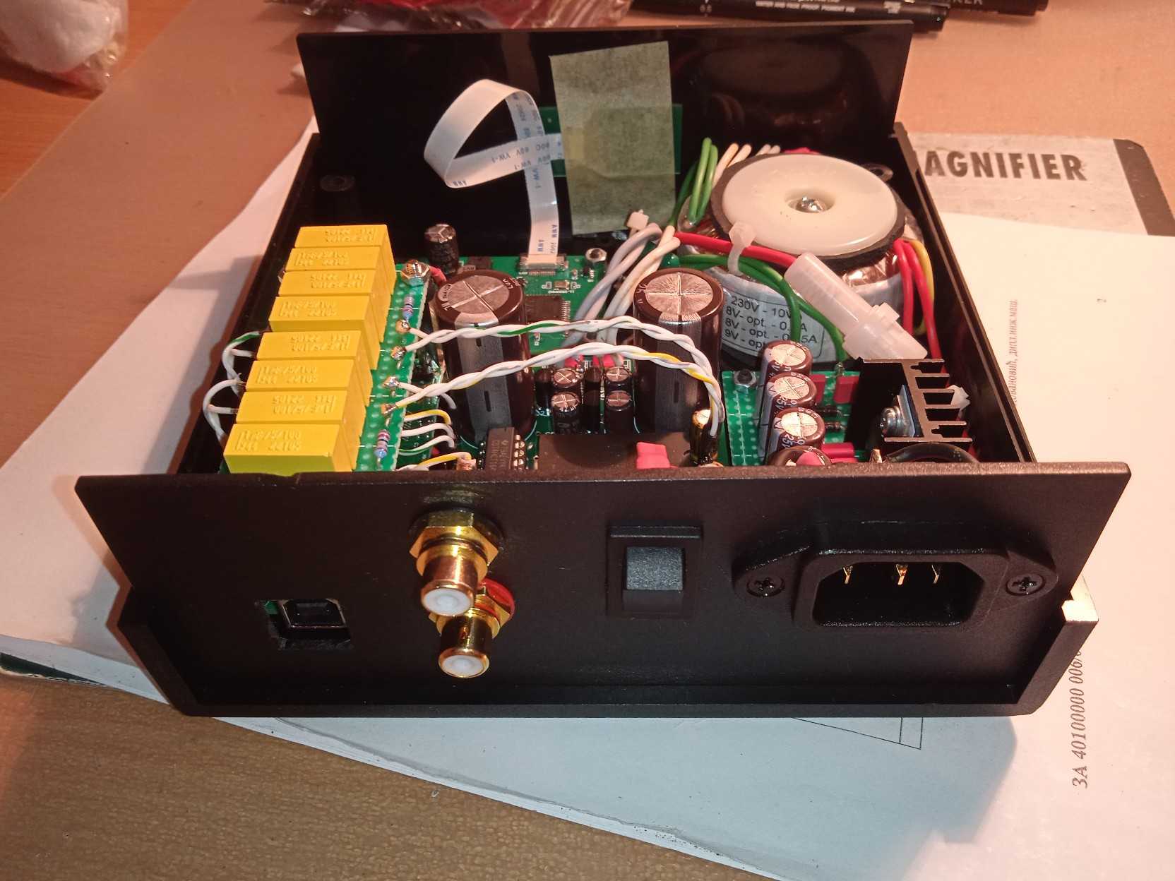

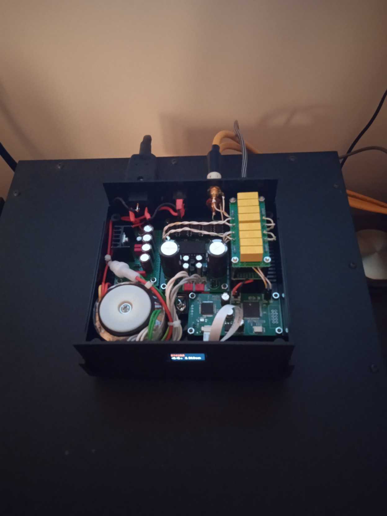

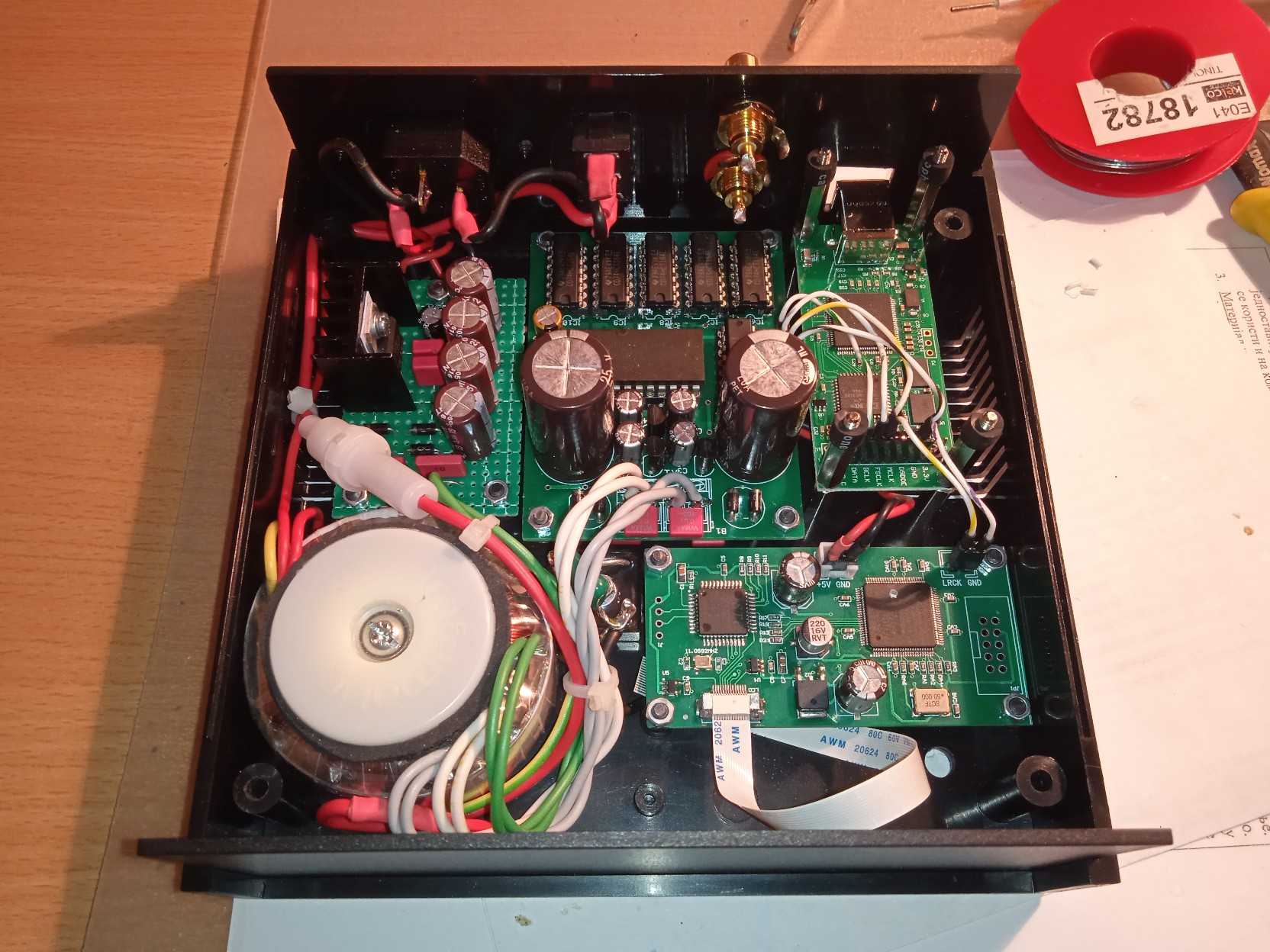

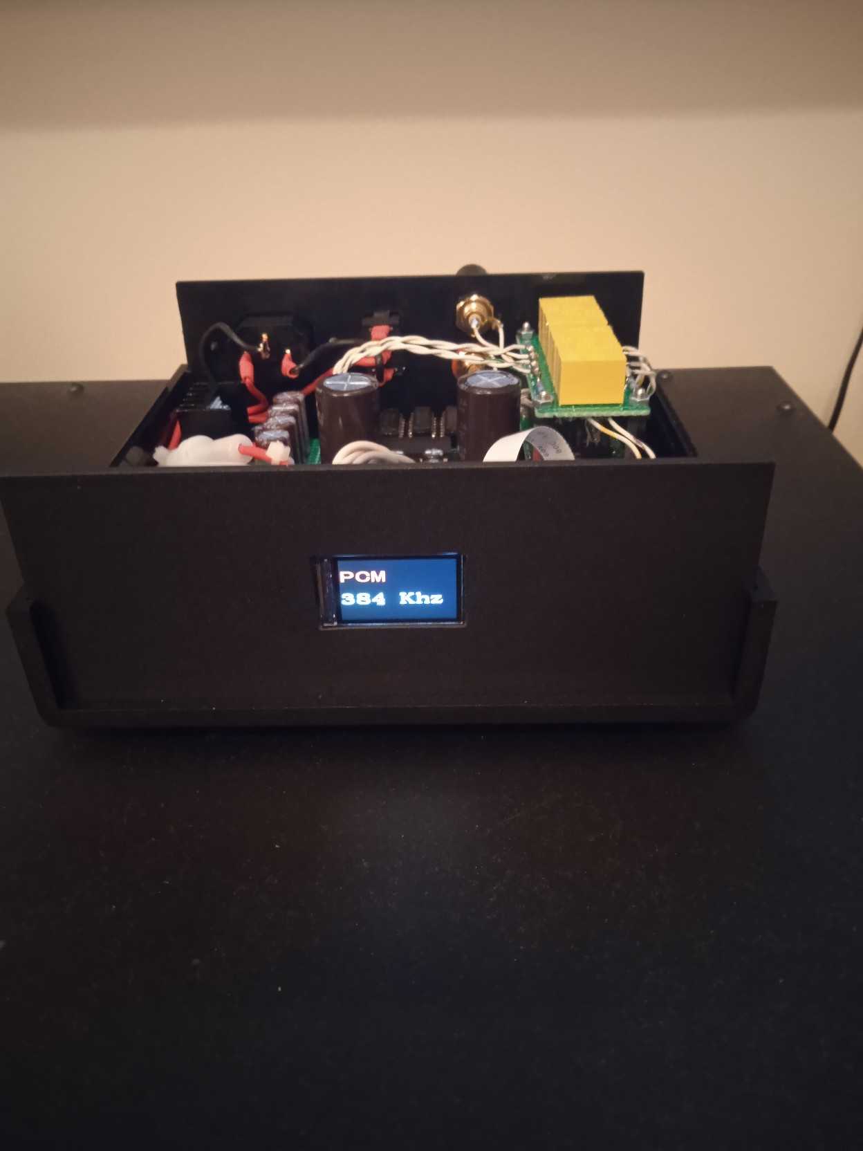

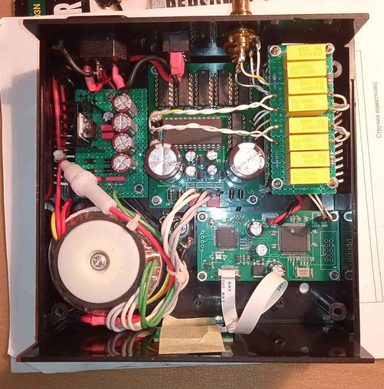

While I was watching the Australian Open with one eye, I built a small DAC with AD1865 N-K with another one. It's not exactly a Miro DAC, it's a Pavouk DAC, but the schematic is similar.
It has only a USB input, I took a Chinese Amanero USB/I2S card with SITIME oscillators, upgraded version. Works flawlessly with original Amanero WIN10 drivers.
The transformer is custom made 10VA. It has a grounded static shield between the primary and secondary windings and magnetic shielding. Transformer secondaries have snubbers determined by the Quasimodo tester. There is not a trace of hum even if the transformer is very close to PCBs.
It also has a small Chinese display for sampling rate. It says Welcome when it turns on. 🤣
