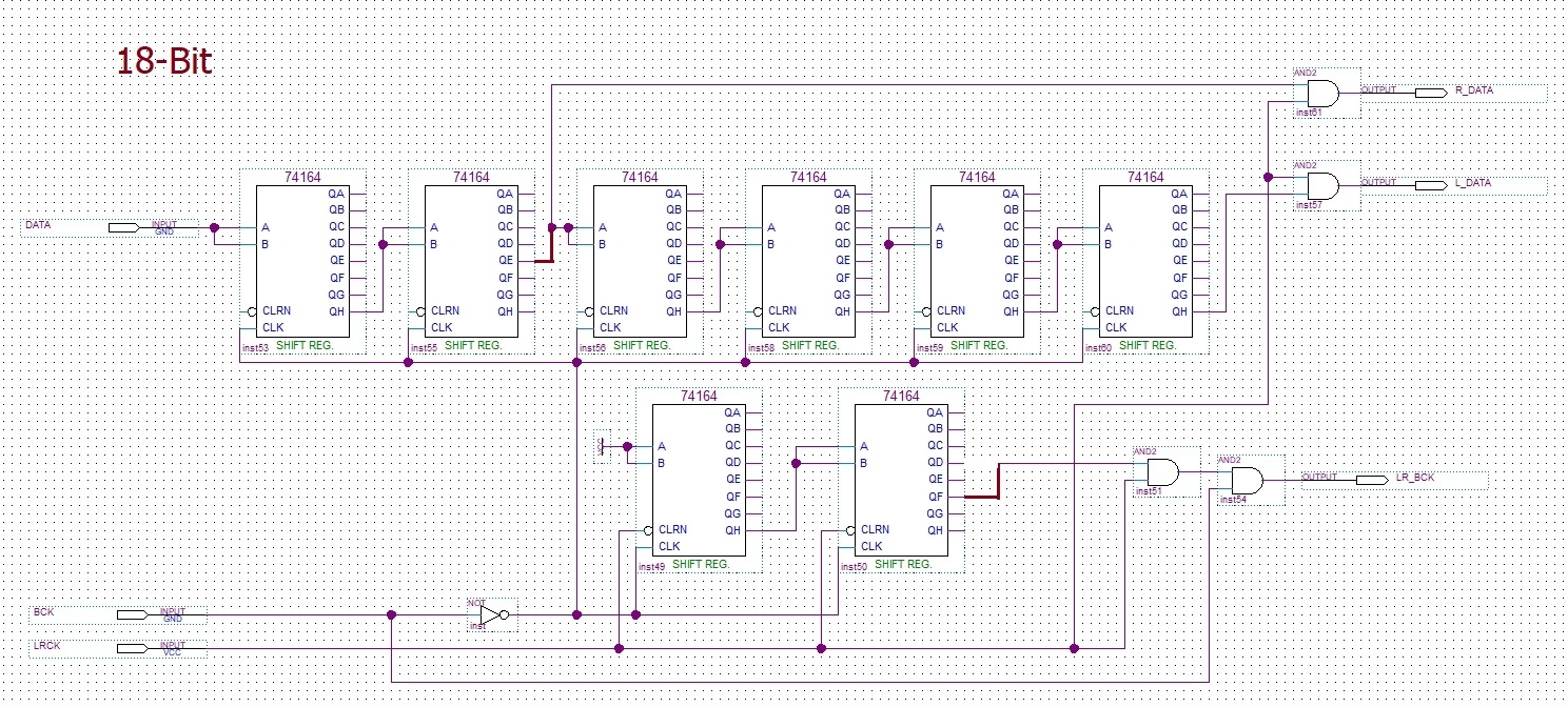

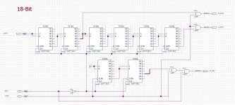

Stop Clock 2 for DAC AD1862 - PCB
Stop clock 2 for AD1862 #2832 - untested 😀
If someone confirms that it works, I will create a DAC PCB with this logic.
Miro, have you any experiment with Stop Clock 2 for DAC AD1865 and with all 18 bit DAC? I have seen 20 bit conv for AD1862 and 24 bit conv for TDA1541 here.
Can you draw a correct circuit for one 18 bit AD1865 or two AD1865? Thank you very much.
@TokRa This Stop Clock 2 for AD1862 is still untested (but I think it does work).
You can move 2 wires in the schematic to make it work with the AD1865 😉 (but as I told, I am not sure if it is bit perfect, because I did not check it with real digital analyzer, it is only simulated ... in case of an error, those bits would only be shifted by +-1 with those wires).

@Myint67 Maybe yes 🤔
Measure voltages between pins:
1 and 5 (gnd)
24 and 5 (gnd)
9 and 13 (gnd)
... if the voltage on those pins is +5V or -5V then you can insert the AD1865 directly with lifted pin 16 (this pin 16 is not connected on the AD1865!) ... if the voltage is higher, then you can't insert it directly ...
But why do you need to change the AD1864? It is very good chip.
