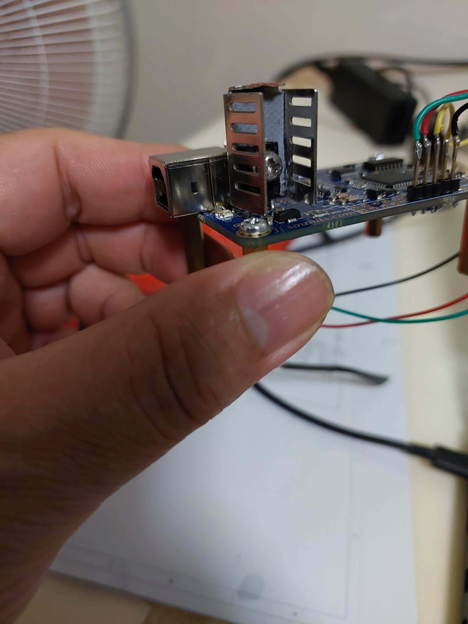

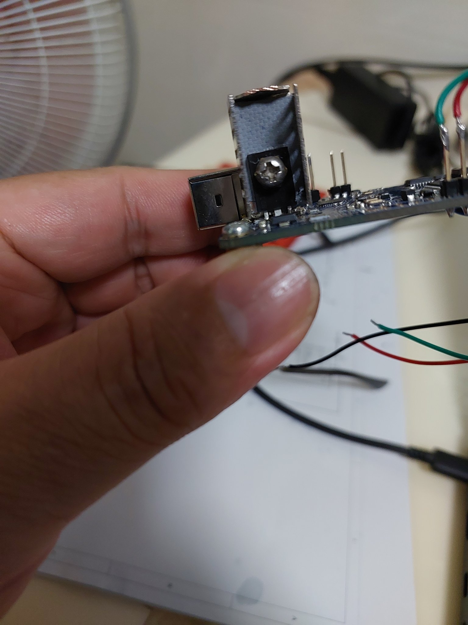

I replaced the heatsink on the JLS board (on the BD139 transistor). The combination of a 4VDC power supply and a slightly larger heatsink gives a slightly lower temperature. One cooler rib can be shortened by 2-3 mm so that it does not touch the spacer or the nut. Isolator is silicone washer. The original heatsink does not have thermal paste or good contact, which means that we do not know the temperature of the transistor. Now it is safe.
I changed the heatsink for mine too.
