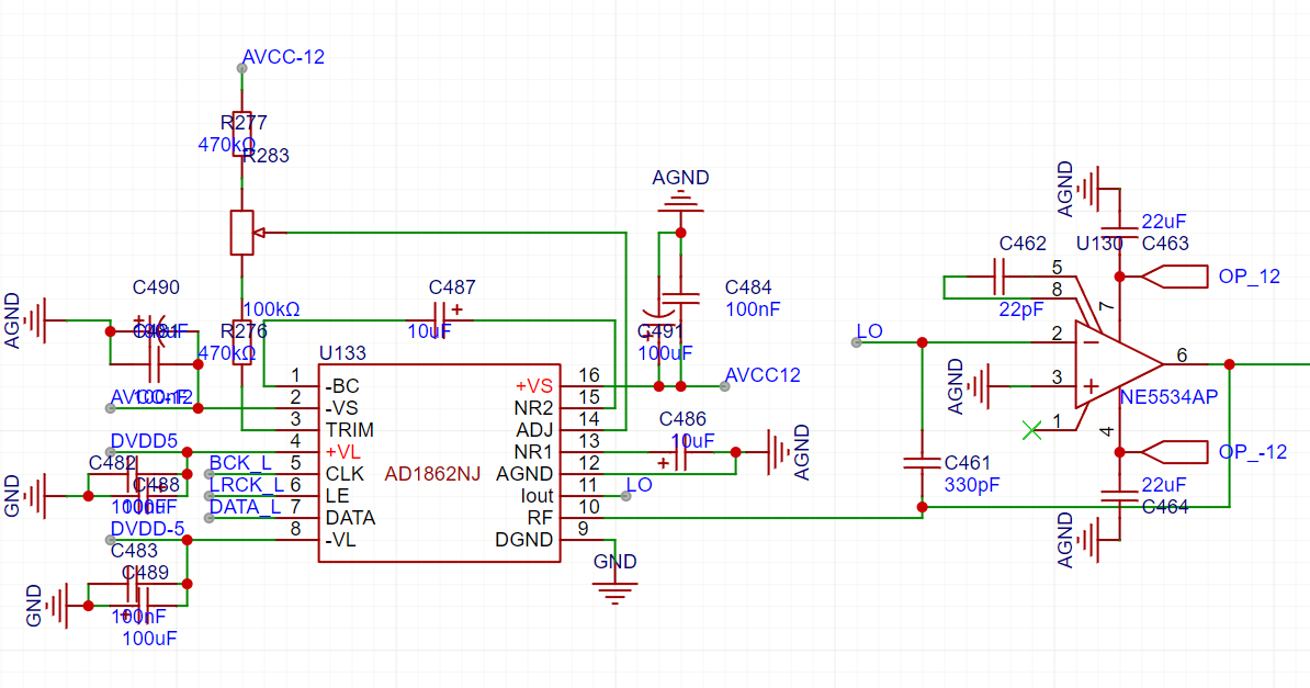

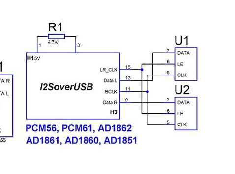

Why not use the I/V conversion method recommended by the official data sheet?
I think the resistors built into the AD1862 will be better.
Many of us have preferred resistor types that are a good fit for the desired sonic flavour. No idea how good the internal resistor is but somehow not holding my breath.

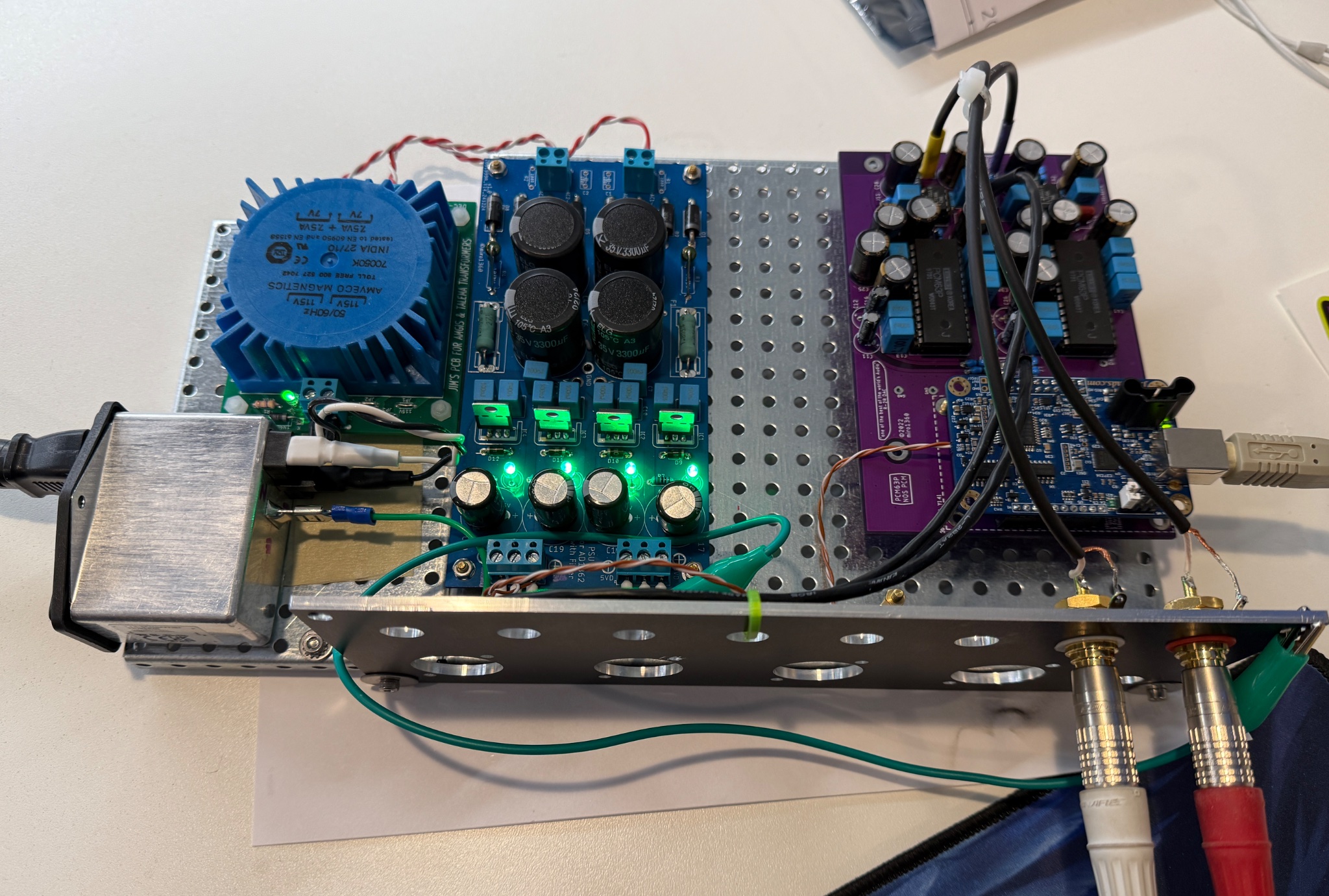

Yes, I used the I/V scheme shown on the datasheet.@CNOracle , do your board use the I/V design on the datasheet?
It works great.
Yes! This is probably the main factor.Not flexible. External resistor value can set the output voltage level from DAC 🙂
But the output level value of the internal resistor is suitable for most applications
