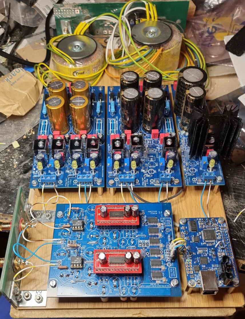

DAC AD1862: Almost THT, I2S input, NOS, R-2R
@diyiggy I am from Europe I will try to find someone from this continent which sells fully functional boards . Thank you for the suggestion .
@Vunce I wanted to say that I soldered the components to the board. I have never done any project, I just changed the electrolytic capacitors in an amplifier.
there are surface mounted components on the board, in case you are not aware. However, with some practice on a training board, you should be ok after that.

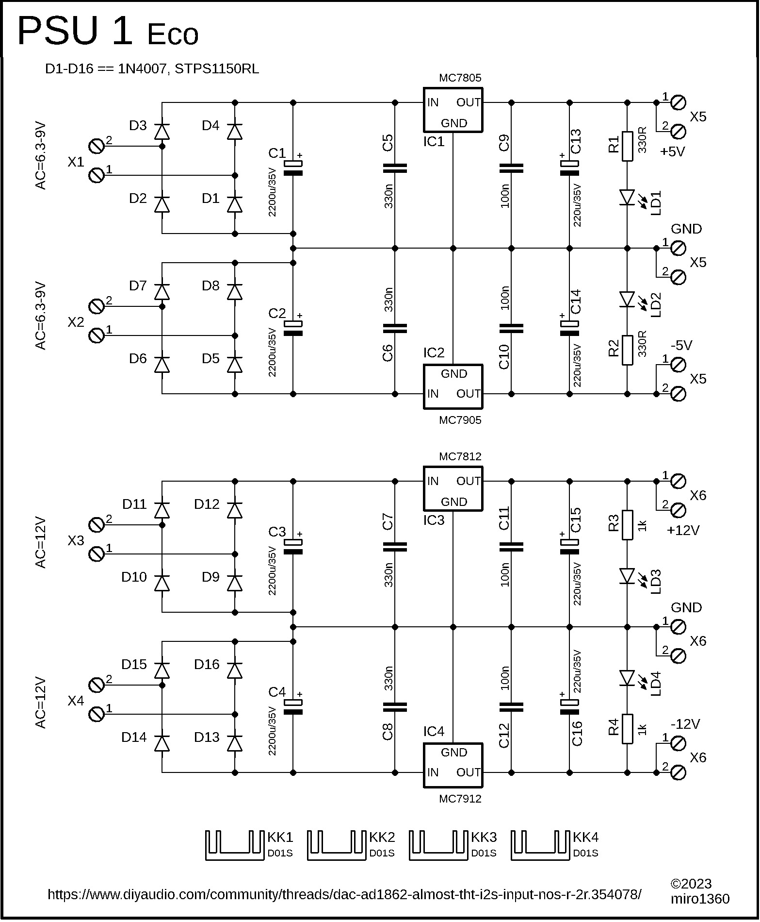

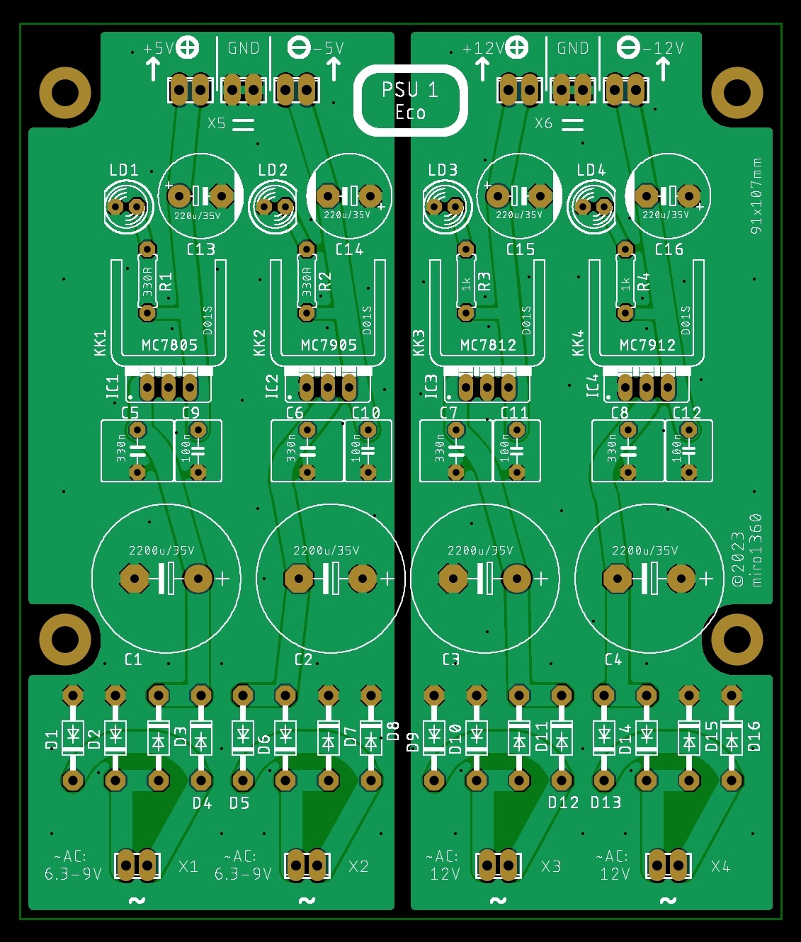

PSU 1 Eco
Minimalistic or Economic version of the PSU 1 for my AD1862 DACs (#2180, #2546).
With simple change of +-12 regulators to +-5V version it can be used with the AD1865 (#1431), PCM63P (#4167) or similiar DACs.
It is stackable with those DACs.

  • diyAudio_PSU1_Eco_2023-01-25.zip

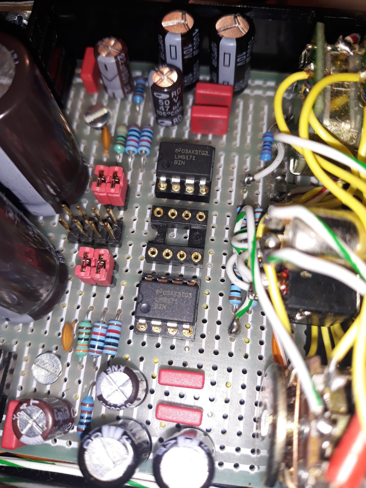

I got a pair of LM6171 from Mouser and tried them in my line preamp built just for testing purposes (accepts single or dual DIP8 OPA). It does it nicely, but the OPA1611 produced a subjectively better sound, richer and more cheerful. The Burson V6 Classic single is of course even better. So my recommendation for Miro DACs budget variants is OPA1611 (on SOIC/DIP8 adapter of course).
