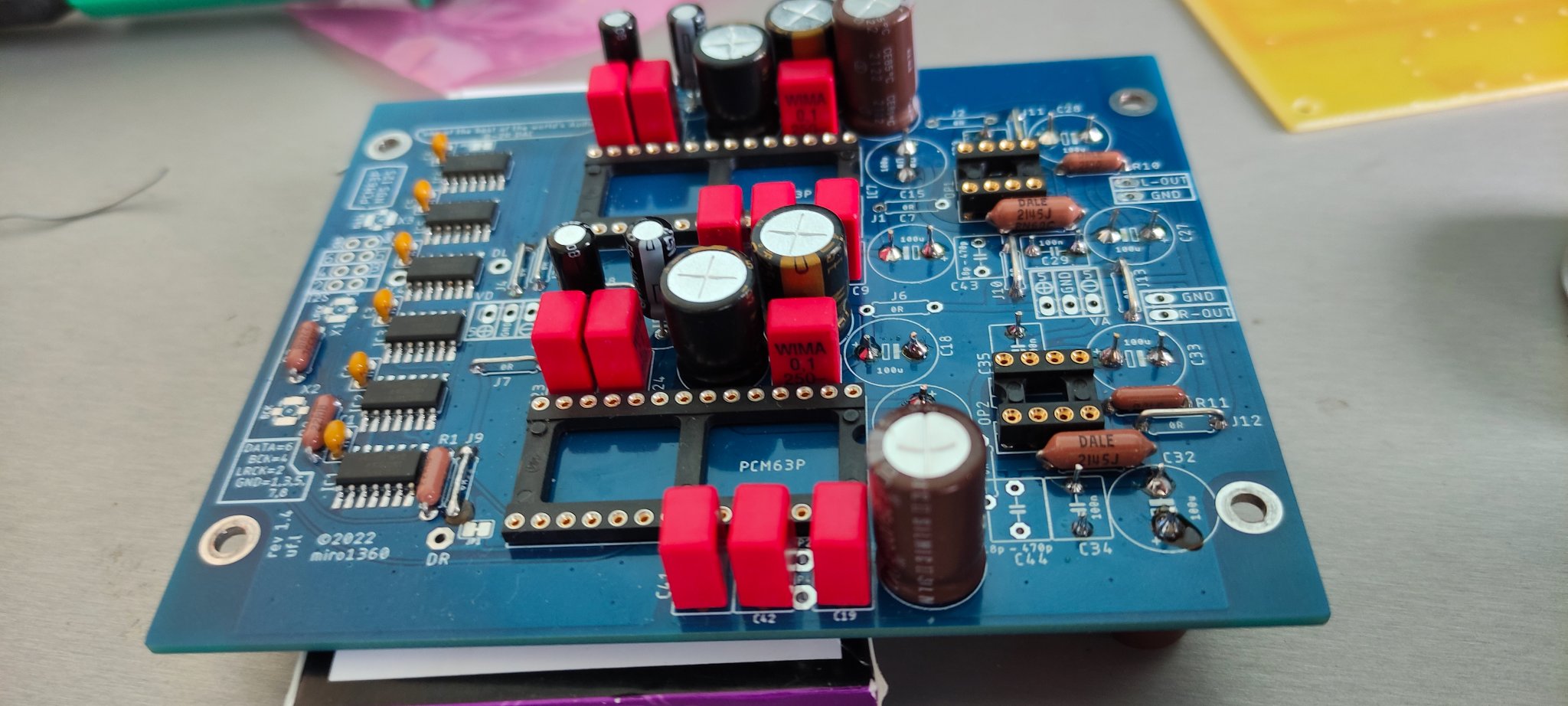

@chi0001 and @sworder84 Both of you have the same experience? No signal from shift registers? 🤔
Is it the same without DAC chips (when the PCM1702 is pulled out from PCB)?
hello miro, same situation if no feed i2s signal, output is 0v, if feed i2s signal, the dr and dl output around 2.5v dc, i compare to other pcb, eg 1865, 1862, all dr and dl output around 2.5v with feed i2s signal, so i thnk the problem is no from the shift registers, once i have time, i will go to my parents home to open my cd player, i remember the chips are 1704, i thnk some pin need enable or disable..... likea 1794.......@chi0001 and @sworder84 Both of you have the same experience? No signal from shift registers? 🤔

Input logic is working. Problem can be in non functional PCM1702? 🤔hello miro, same situation if no feed i2s signal, output is 0v, if feed i2s signal, the dr and dl output around 2.5v dc, i compare to other pcb, eg 1865, 1862, all dr and dl output around 2.5v with feed i2s signal, so i thnk the problem is no from the shift registers, once i have time, i will go to my parents home to open my cd player, i remember the chips are 1704, i thnk some pin need enable or disable..... likea 1794.......
If you compare the schematic from Pavouk: http://pavouk.org/hw/audiosystem20/pcm1702dac.html
with mine schematic, both are identical. The only difference is in the package (pavouk used SOP package and my DAC has DIP package ==> pinout is different) 🤓
Try it with only one PSU as was suggested. +-5VA from PSU into both power connectors on DAC.
The only way to find out if it is a real PCM1702 is to install two shunt resistors (100R) on the power supply pins, but pins 3 and 9 must be connected together as well as 5 and 16 exactly as mentioned in the datasheet and measure the current, 3 and 9 should be around 5mA and 5 and 16 around 25mA.
If + has a greater or equal current as - something is wrong with the i.c.
