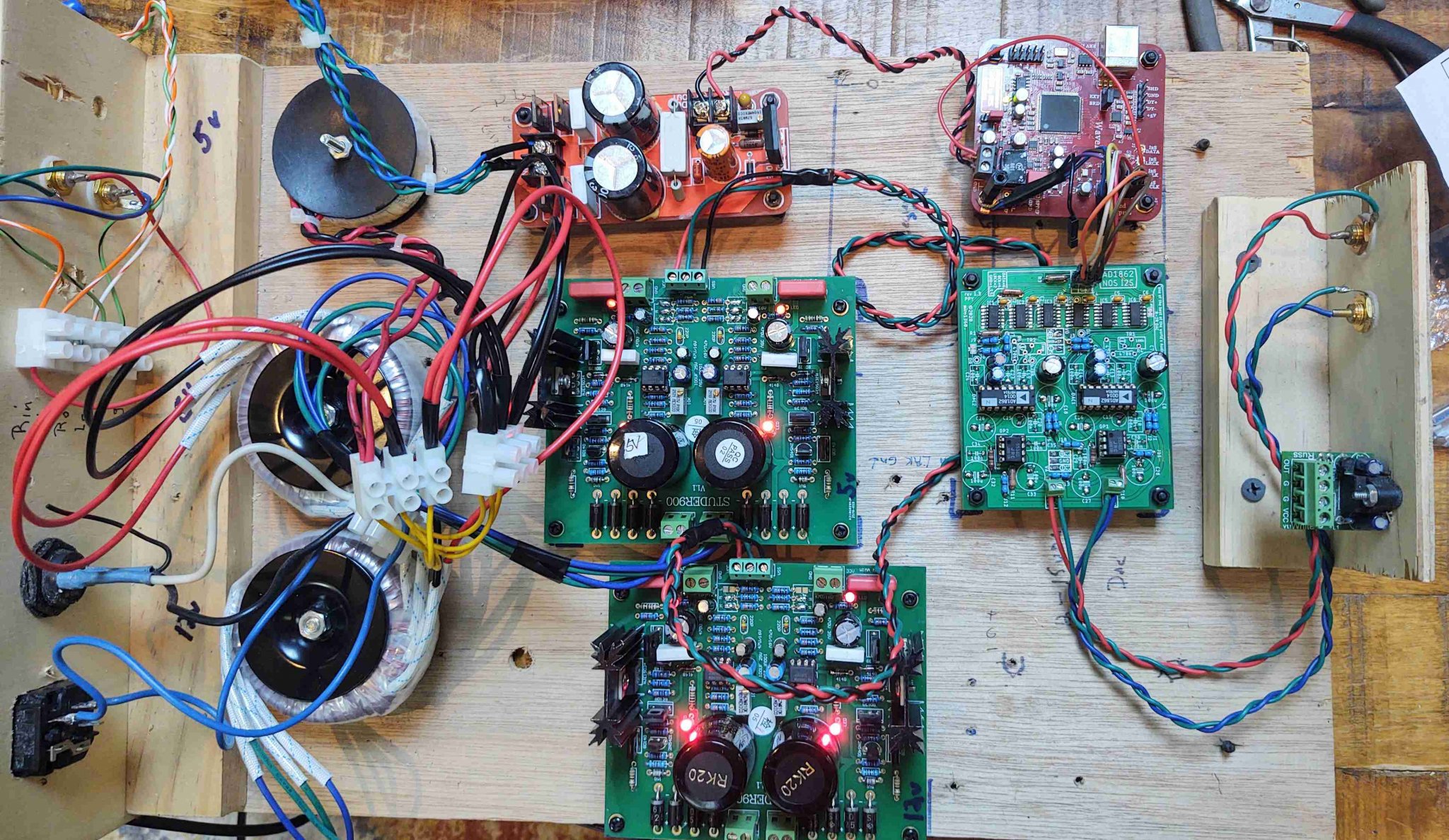

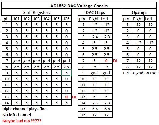

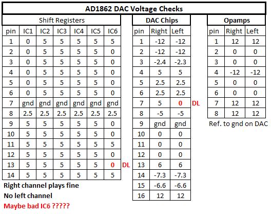

I've got my test setup complete and gave the dac an initial test. Only getting right channel to play, left is silent. Using the circuit diagram I checked continuity between the pins of the shift registers to dac to opamps to rca out and did not find any issues. I then did a voltage test on all of the chips, see the picture below for values. I am no EE but it seems that I might have a bad IC6 which feeds the left dac chip, pin 13 (DL) reads 0 where as IC2 pin 5 (DR) reads 5v. The voltages on the dac chips and opamps on both sides look similar with the exception of pin 7 (DL) on the left dac chip which is fed by IC6. What do you guys think ?

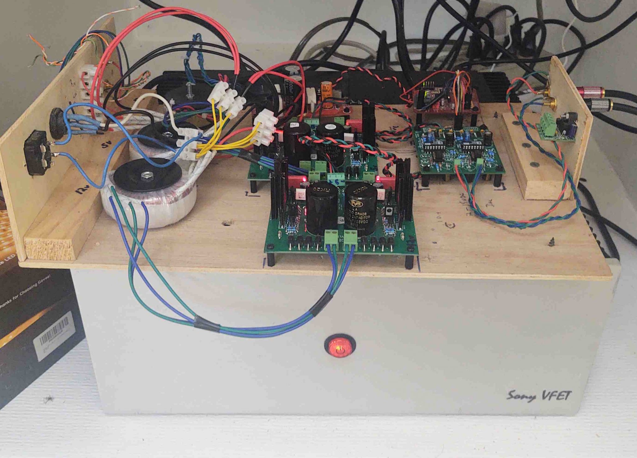

Success, she sings. Using AD797 opamps for now but have a bunch of others including some Sparkos and maybe Burnsons to try out. After a quick listen I'd say it sounds wonderful, standout imaging and tonal balance. Very impressive. I'll let it burn in for a little while and then try to determine which opamp sounds best to me in this DAC. Many thanks to you Miro for the wonderful design and the help.
Congrats. Can I ask what the $ added up to please?
I had a lot of parts that I scavenged from old projects like the wavio board some psus and trafos. So my current outlay is only about $120 US. But if I were to buy all new and put it into a nice 2U case I guess it would cost north of $300 US. It sounds great and deserves a nice case. That will be on my to do list after I play with opamps.

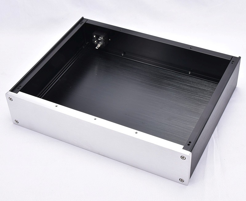

I'll just get one from the diyaudio store, largest 2u they offer should work. Hard to beat for price since shipping is included. Nice cases but you may need to do your own casework like cutting in for power, RCA out, power switch and such.
