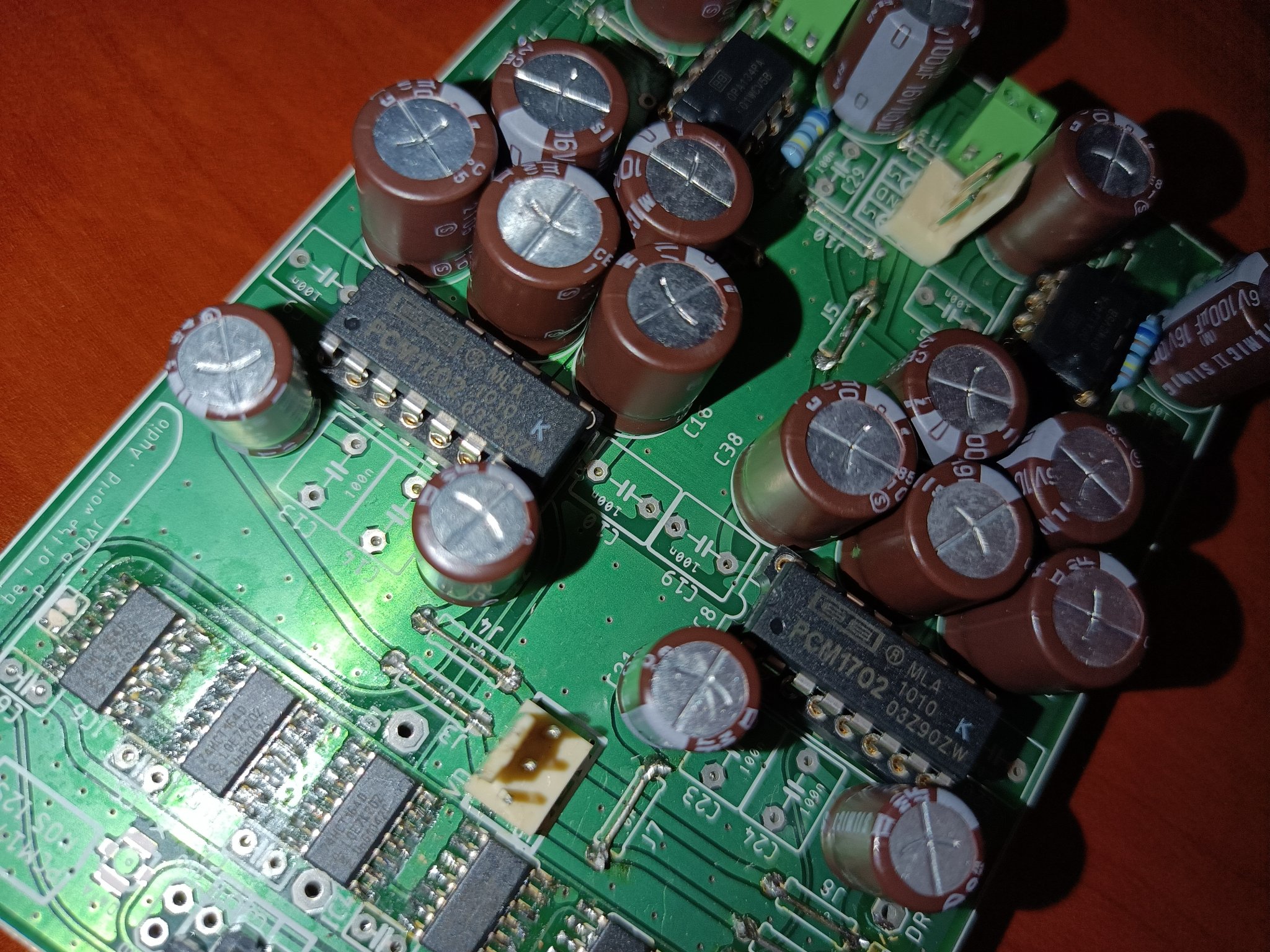

Track back through the inputs and outputs and you will find the problem. Check that all chips are aligned correctly (I've made that mistake)There is a problem with shift registers. I already check them with points (DL, DR and ground) - signal is not coming from them. Maybe one on them is defective?

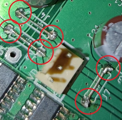

Its hard to see on your photo, but it looks like the two jumpers for DL and DR are open - but maybe its just that the photo isn't very clear. I think these were JP1 and JP2 on the older boards.There is a problem with shift registers. I already check them with points (DL, DR and ground) - signal is not coming from them. Maybe one on them is defective?

A good angle.Its hard to see on your photo, but it looks like the two jumpers for DL and DR are open - but maybe its just that the photo isn't very clear. I think these were JP1 and JP2 on the older boards.

@chi0001 and @sworder84 Both of you have the same experience? No signal from shift registers? 🤔There is a problem with shift registers. I already check them with points (DL, DR and ground) - signal is not coming from them. Maybe one on them is defective?
Is it the same without DAC chips (when the PCM1702 is pulled out from PCB)?

Yes, i also took out the chips and made the measurements without. The result is same - no signal from 74HCT164D.@chi0001 and @sworder84 Both of you have the same experience? No signal from shift registers? 🤔
Guys, what solder wire are you using? This doesn't look very good, it's probably not SnPb solder, if it's only Sn then you should go with a higher soldering iron temperature. Any solder joint like this could be a potential problem and could have easily destroyed both PCM1702s.A good angle.
It would be best if you first test the power supply, shift registers and op. amps and then insert the PCM1702.

No, I don't have an osilloscope, only measure voltage on 14 pin and ground of each Nexperia and also DL DR and ground.Did you track back through the inputs and outputs of each shift register?

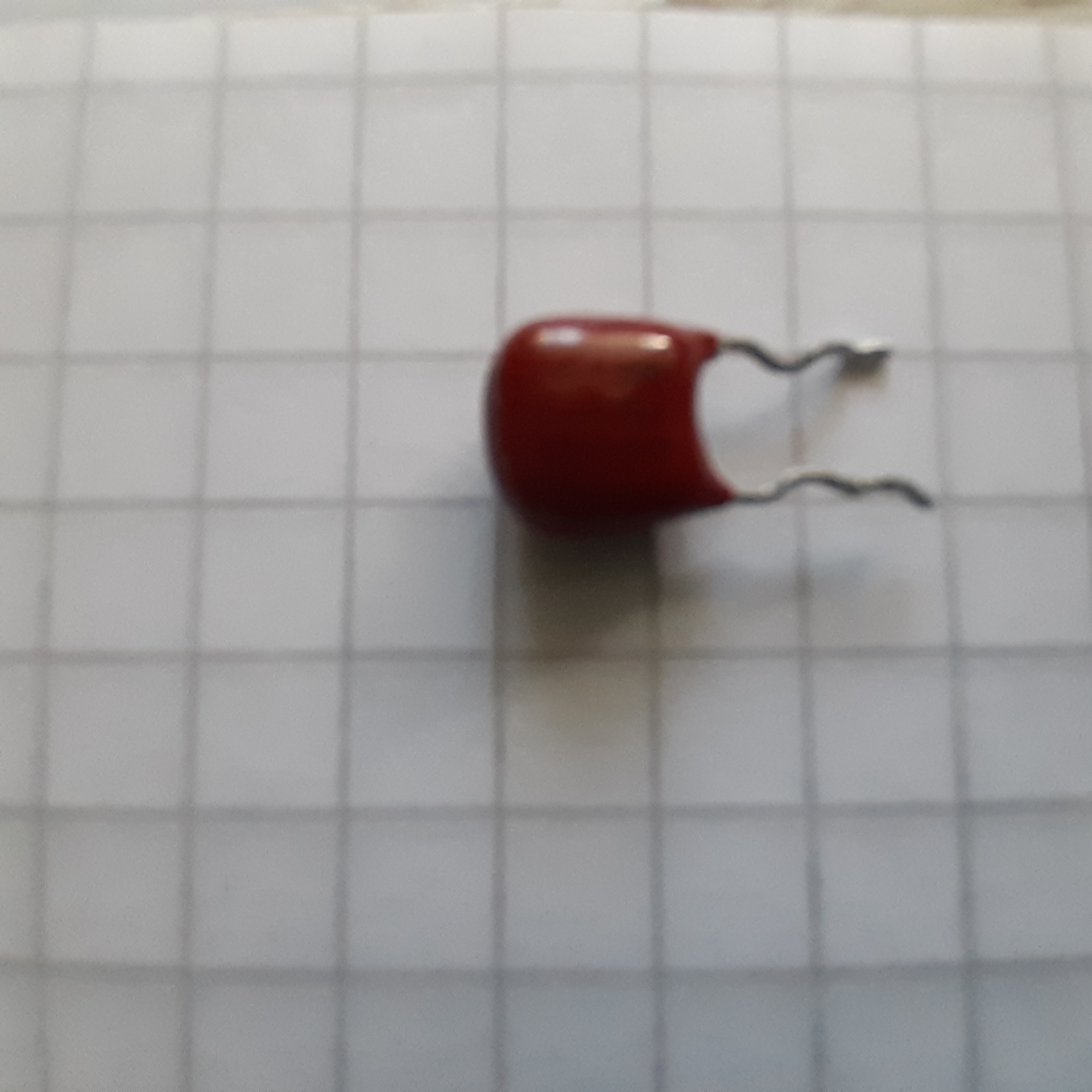

Any idea of what dielectric it is please ? Took from an old Philips.
Seems to me mylar but maybe ceramic class 2 ? But not the same than military radial ceramic class 2 in squared plastic case for instance...

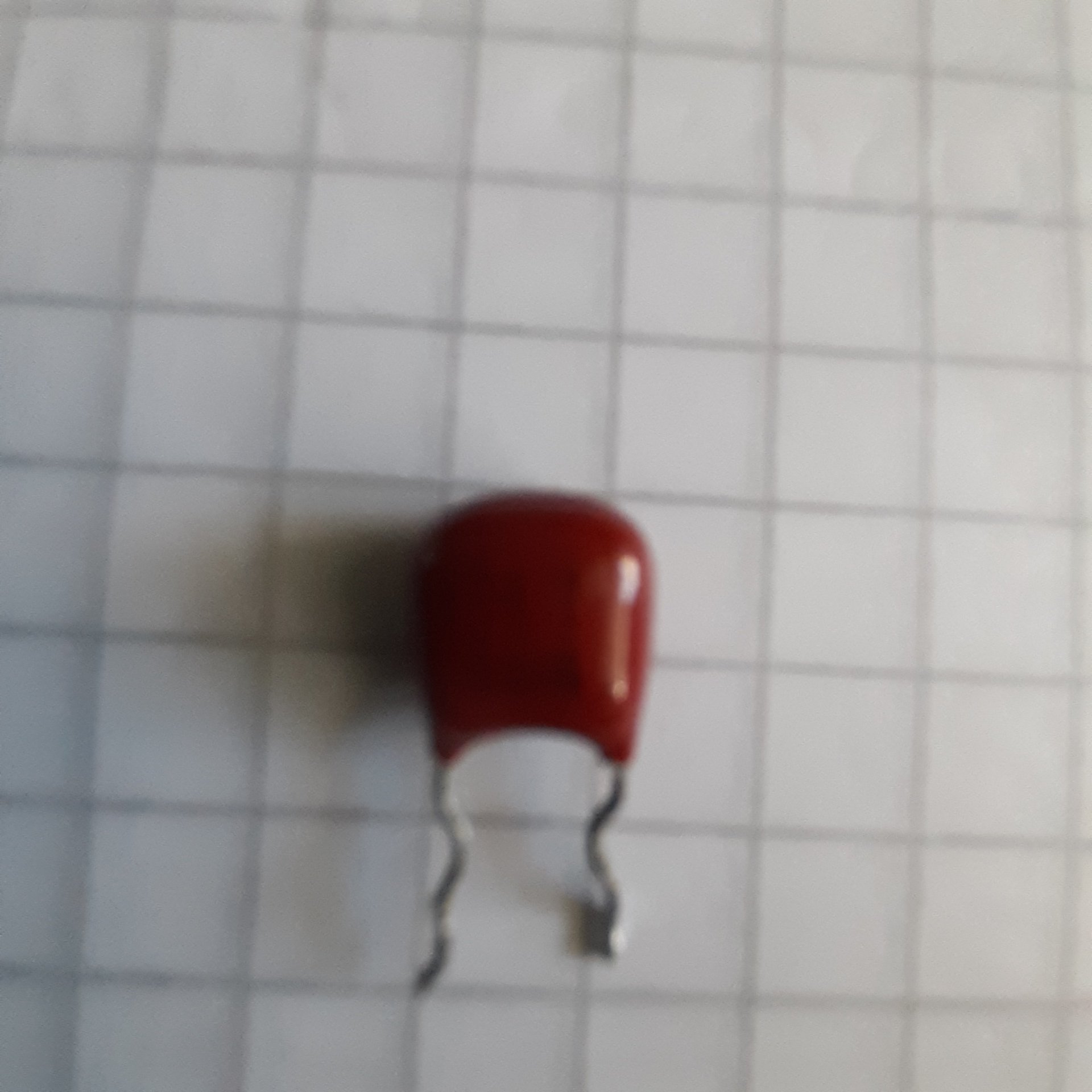

You don't need a scope - just set your multimeter to DC and measure. The high frequency of the signal fools the meter into thinking that its DC. Expect somewhere between 0.7 and 1.6V or so - but you will only have data when something is playing.No, I don't have an osilloscope, only measure voltage on 14 pin and ground of each Nexperia and also DL DR and ground.
Look, I gotta say - your soldering on all of those ICs doesn't look great, IC4 in particular. If this was in front of me, I would be using a magnifying loupe, I would flood the area with flux, and then with a clean tip I'd touch each pin with the iron. Then, I would use a meter on continuity mode and sharp point tips and check for continuity between each track and each leg of each chip just where it enters the body of the chip. I'd also check you don't have shorts between pins too.
Something else you could do - check for Data at the input, and see where the signal stops as it passes through the shift registers.
Lose that silver solder and use some regular flux cored solder. Having a good connection that lasts really well beats the hell out of the difficulty of running silver bearing solder.@grunf now I have a Tchernov audio solder with silver (SFS/AG). This is a good solder. Unfortunately I was soldering with old iron tip and that's why the result a little poor quality)
@sworder84, I know how you feel using an old iron tip. It is tough. But I tell you, once I used a temperature controlled Hakko soldering station at work, I realized I could never go back. I bought a Hakko 951 station for myself. Those rough solder joints on your smd chips are likely hiding some problems. The good news is that you can easily and quickly redo all those smd solder joints. Like several Youtube videos on soldering smd parts show, apply flux from a tube onto one row and drag a small tip across that row. I think you will make beautiful looking solder joints, and I think your shift register problem goes away.
