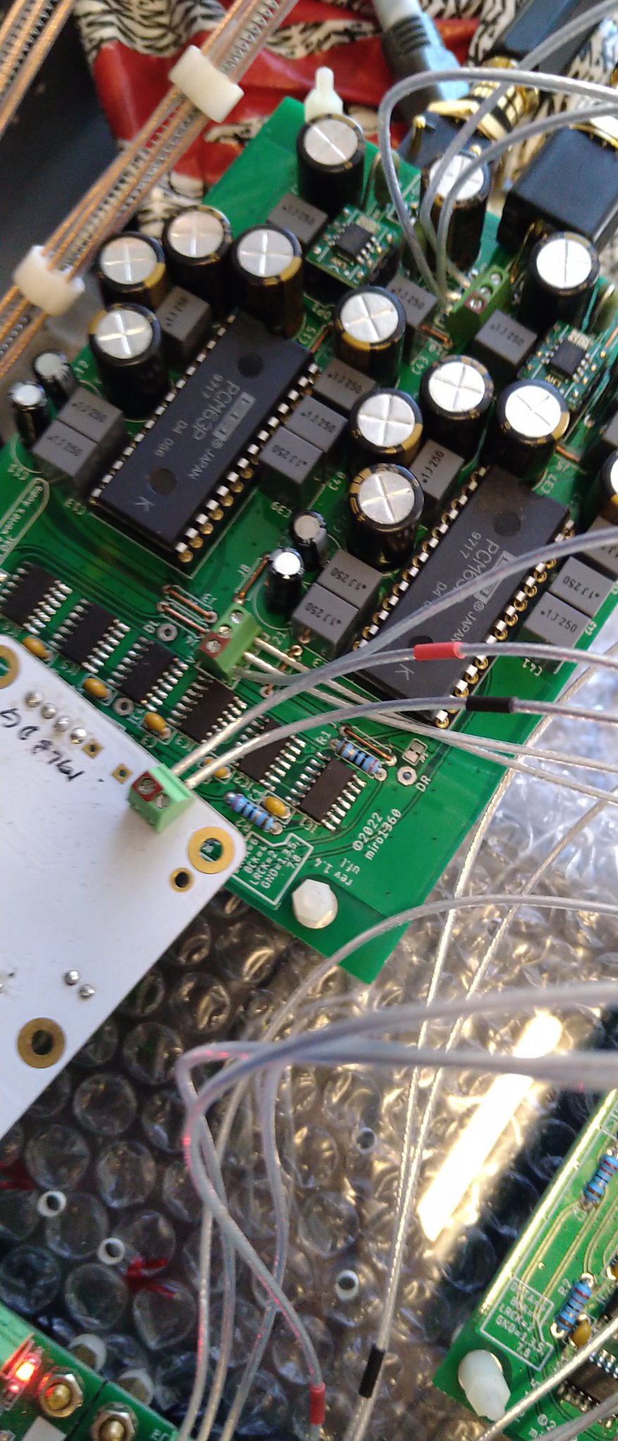

Guys, I start today DAC 1702, I already checked PSU voltage, all connecting but no sound only silence. What I should do?
I don't populate smd's C31/36. I install OPA134PA.
@sworder84 You are first who completed this PCB, I hope there is no mistake on the PCB or schematic 🤔 I already double checked the design and it looks good (only pin 8 in the I2S header is not connected to the GND, but you are not using it, this pin can be soldered together with pin 7 if someone needs GND on pin 8).
Resolder all solder joints on your PCB: #4354 -- zoom it and you will see how many "potentially" cold joints there are. Heat the pins on the PCB well with your solder iron. The same problem may be on shift registers 😉
There is a problem with shift registers. I already check them with points (DL, DR and ground) - signal is not coming from them. Maybe one on them is defective?
