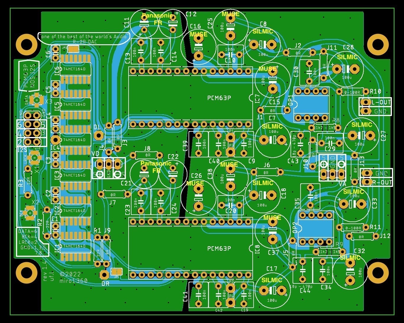

Here is my caps plan
R8 and R9 - that's where Dale MIL CMF goes (Very low noise (-40 dB)) 0.1% - 50ppm 😀

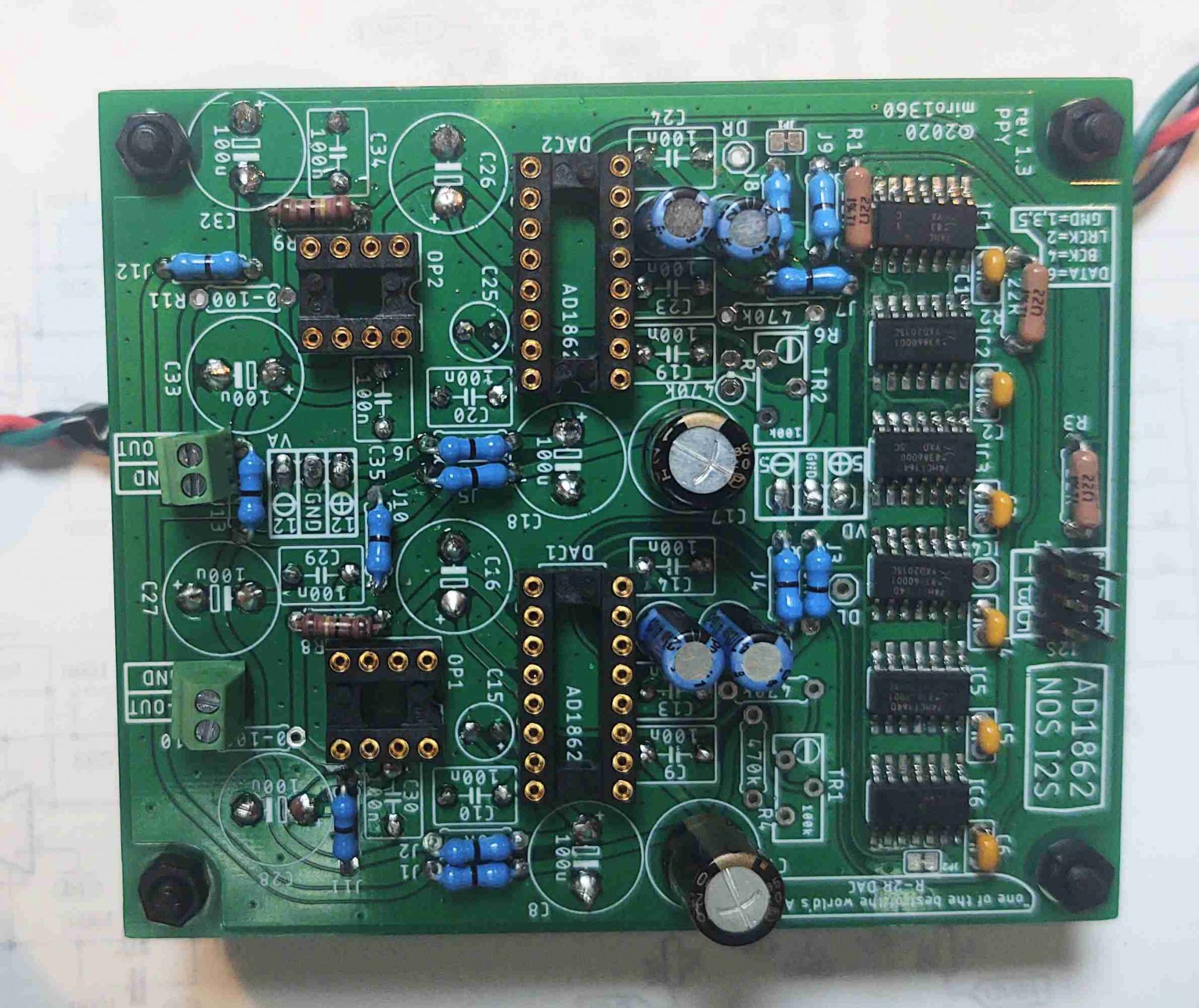

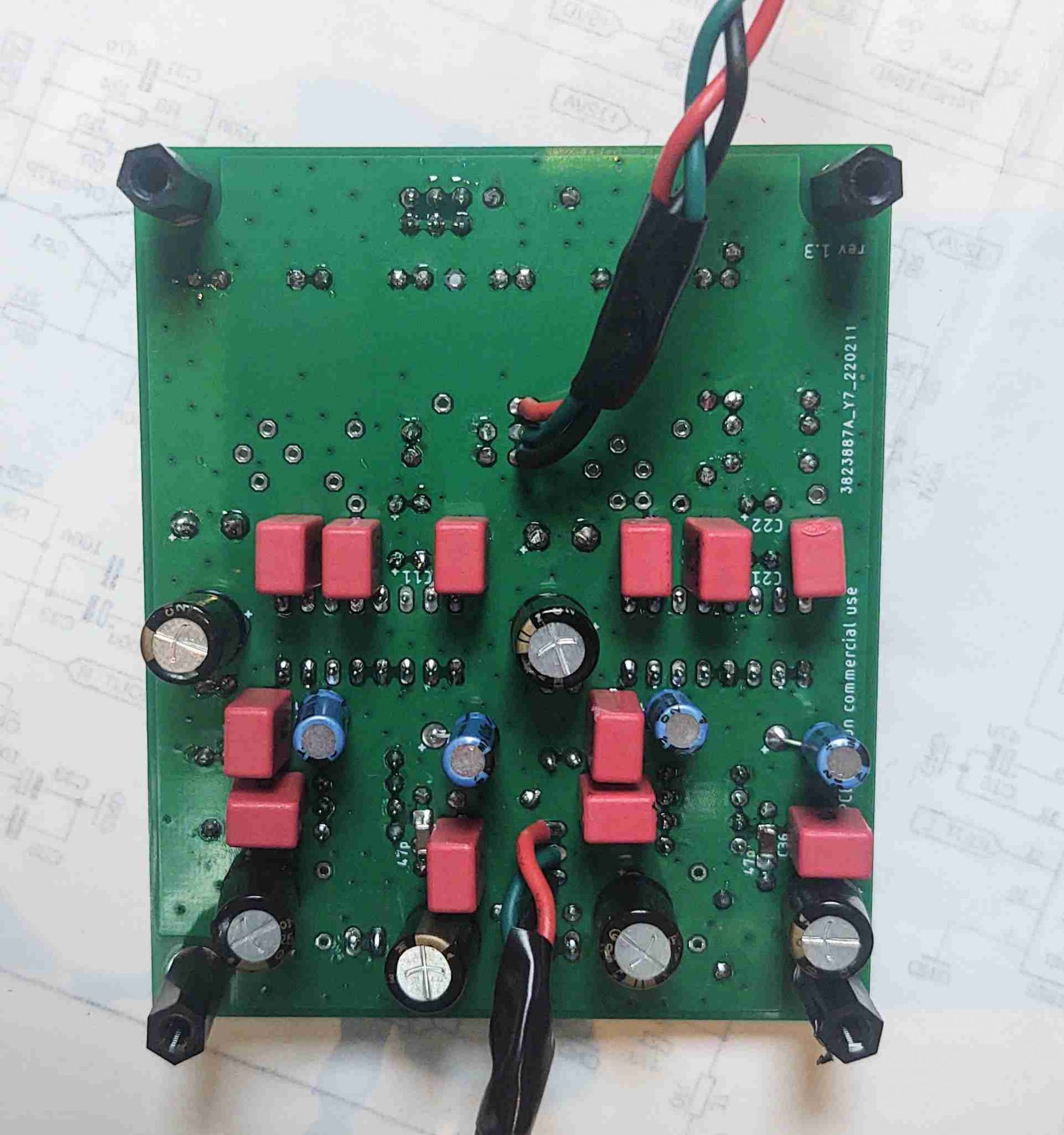

Some progress to report. I finally got all of the required parts in and was able to stuff the board. I took Vunce's esteemed advice and conserved real estate on the top of the board near the opamps and DAC chips by relocating stuff on the bottom of the board. I used the revised BOM that was posted in this thread for my guide in doing this build, but I do have a question. It states that the RC filter which uses C37 and C38 can be omitted. On the rev 1.3 board that I'm using I can't find any C37 or C38. I'm guessing that C27 and C33 may be the new labeling for these caps on this board because of the proximity to R10 and R11. Is this the case? if it is I have two choices, remove C27/33 or add R10/11. I'm guessing that less is better, so is removing C27/33 might be the better move.
Anyway, here are some pics , if you see any errors please shout out to me, I've gotten really good at screwing things up.
next I'm going to turn my efforts to installing the three PSUs (2for DAC, 1 for waveIO) that I'll be using on my project board and make sure that they're all working correctly next. Once that's all done I hook everything up without the dac chips or opamps installed and do a power up test to see if there are any problems. I'm looking forward to hearing this DAC play.

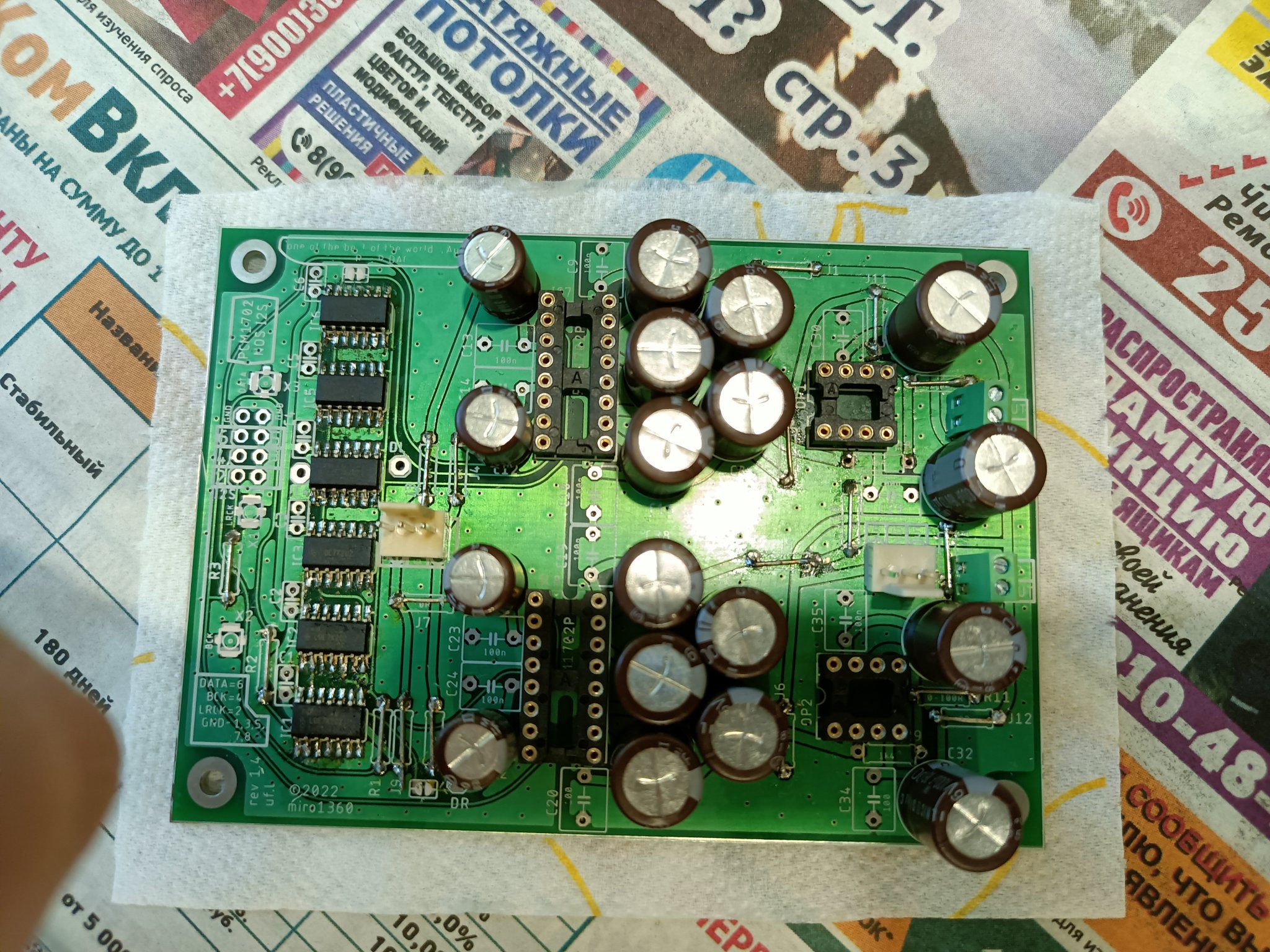

Today almost finished the Dac board. PSU still in progress. Instead Wima and Cemet - NP0 Murata 0.1/50 1206. Opamps will be OPA134PA.
I also install jumpers instead resistors. I waiting only two resistors 1k4.
@grunf what kind PSU I need look for top sound? I have also LM6171 and later a will be looking more expensive.
I don't have Black gate - it's rare items.
rev 1.3 has no RC filter on the output (that is why the C37/C38 are missing).
C27 and C33 (100u - 330u) are for opamps power supply, you need these on the PCB !!!
C31 and C36 (47p) are for the I/V, better to let it empty because some CFA opamps hate this capacitor.
... so for you: Remove the C31/36 from the PCB ... but the C27/C33 must stay on the PCB 😉
1k4 value is not critical, you can install also 1k5 (the output volume will be "higher") or 1k2 (the output volume will be "lower") ... this resistor sets only the output volume from DAC ... this resistor is optional based on your output voltage (volume) request 😊
