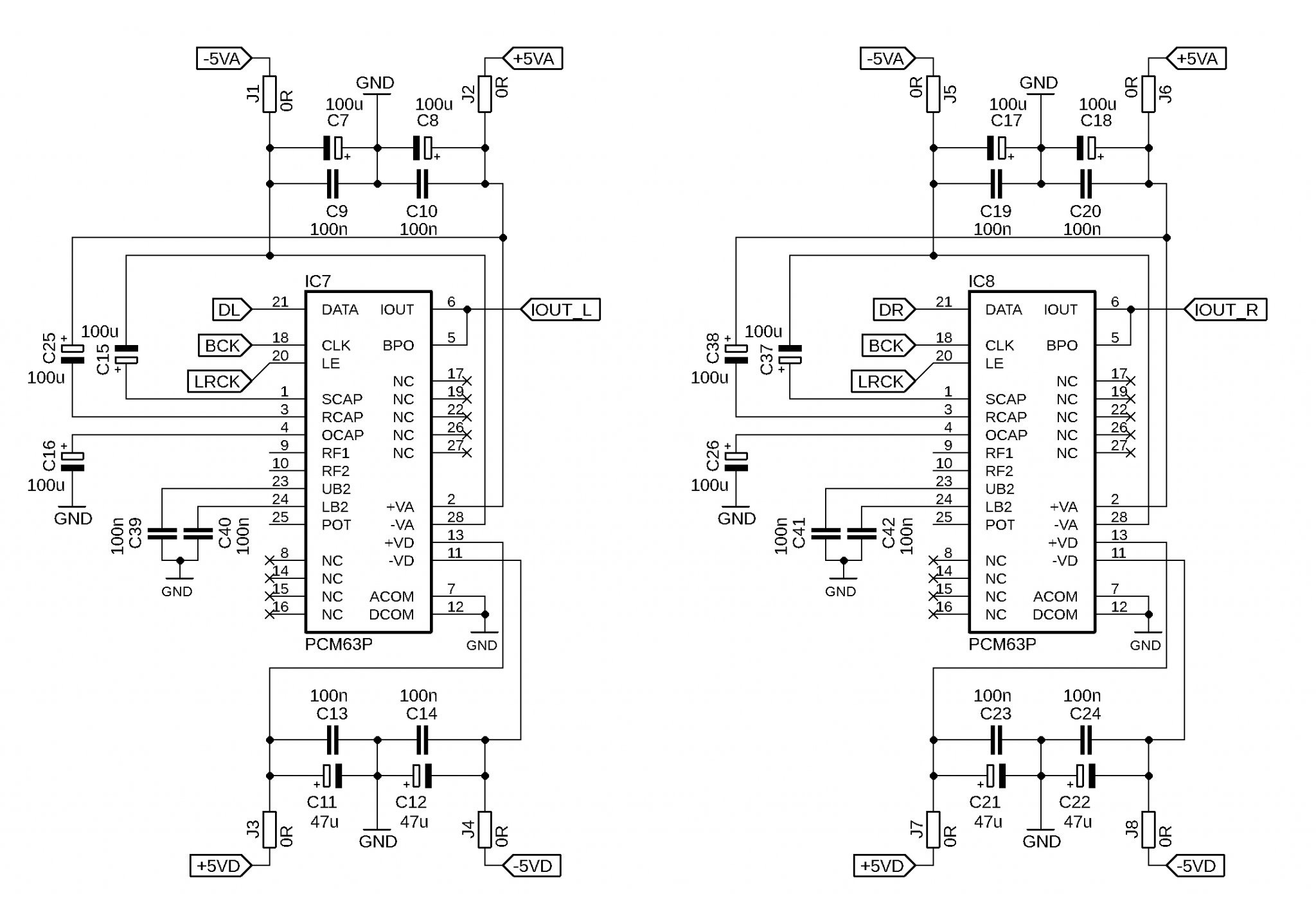

v2 PS - C7,C8,C27,C28,C32,C33 shoud be 100uF/25V or 330uF/25v?Recap:
v1. - 1 PSU board (+5, 0, -5 and +12, 0, -12)
v2. - 1 PSU board (+5, 0, -5 and +12, 0, -12) + 1 PSU board (+5, 0)
miro1360 please confirm.
I already ordered a new board for 1702 and looking the components. LM6171 I definitely don't want to use (already have with 1862) maybe opa134.

Unfortunately no 1702 in my drawer. Anybody an idea about a possible difference in sound? Cheers!
Have the 1701, further iteration not through hole but pins compatible iirc. Below the AD1862, TDA1541A, TDA1540, AD1865, PCM56/58... subjective of course and as far not tested in iso layout, who knows ?
1862 and 63 are the best dac in audio. Also there is D20400 (ultra analog). 1702/04 going after them. That's all the multibit Dac. As for multibit delta sigma - maybe AK4497/90 and of course PCM1794/92 is best.Have the 1701, further iteration not through hole but pins compatible iirc. Below the AD1862, TDA1541A, TDA1540, AD1865, PCM56/58... subjective of course and as far not tested in iso layout, who knows ?

I do prefer ad1862 to pcm63 but thanks to miro you can test both at very near iso conf (near pcbs) using same parts and supply but the dac chip...
