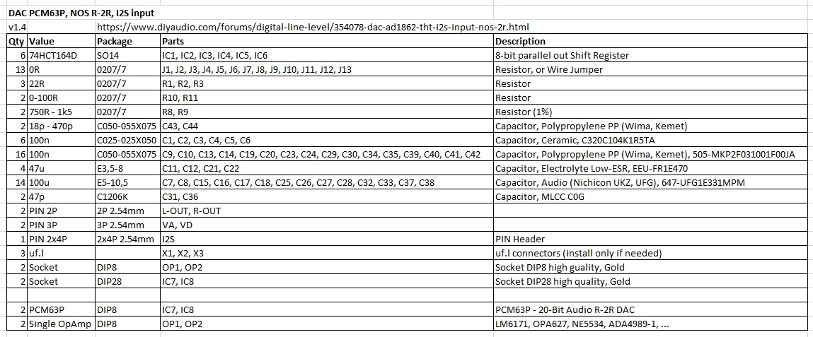

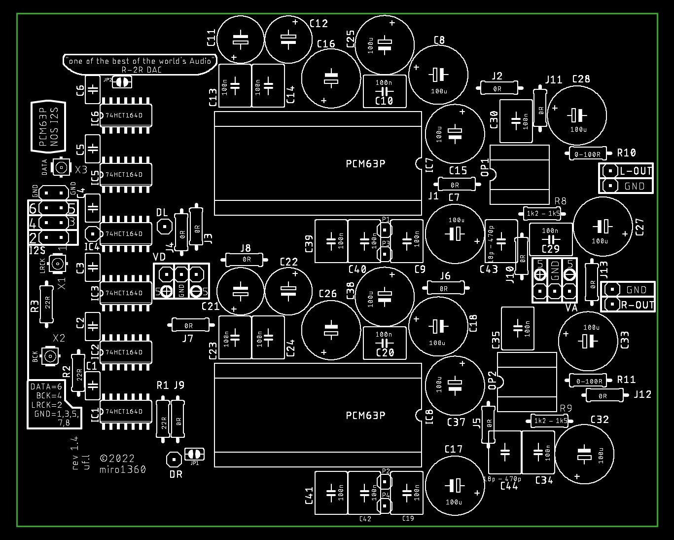

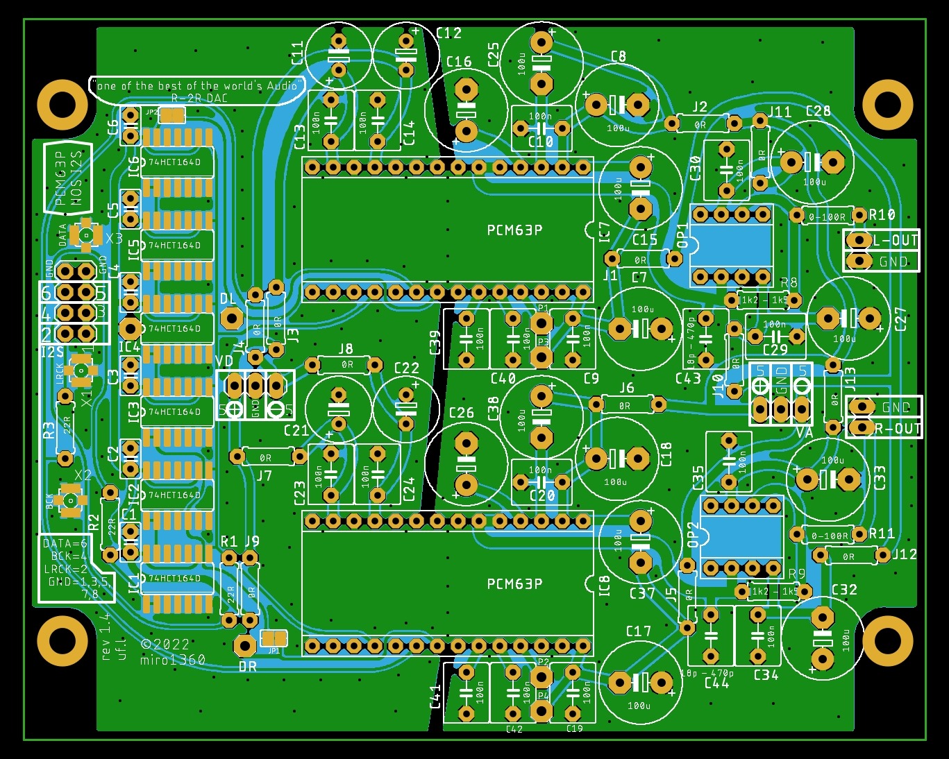

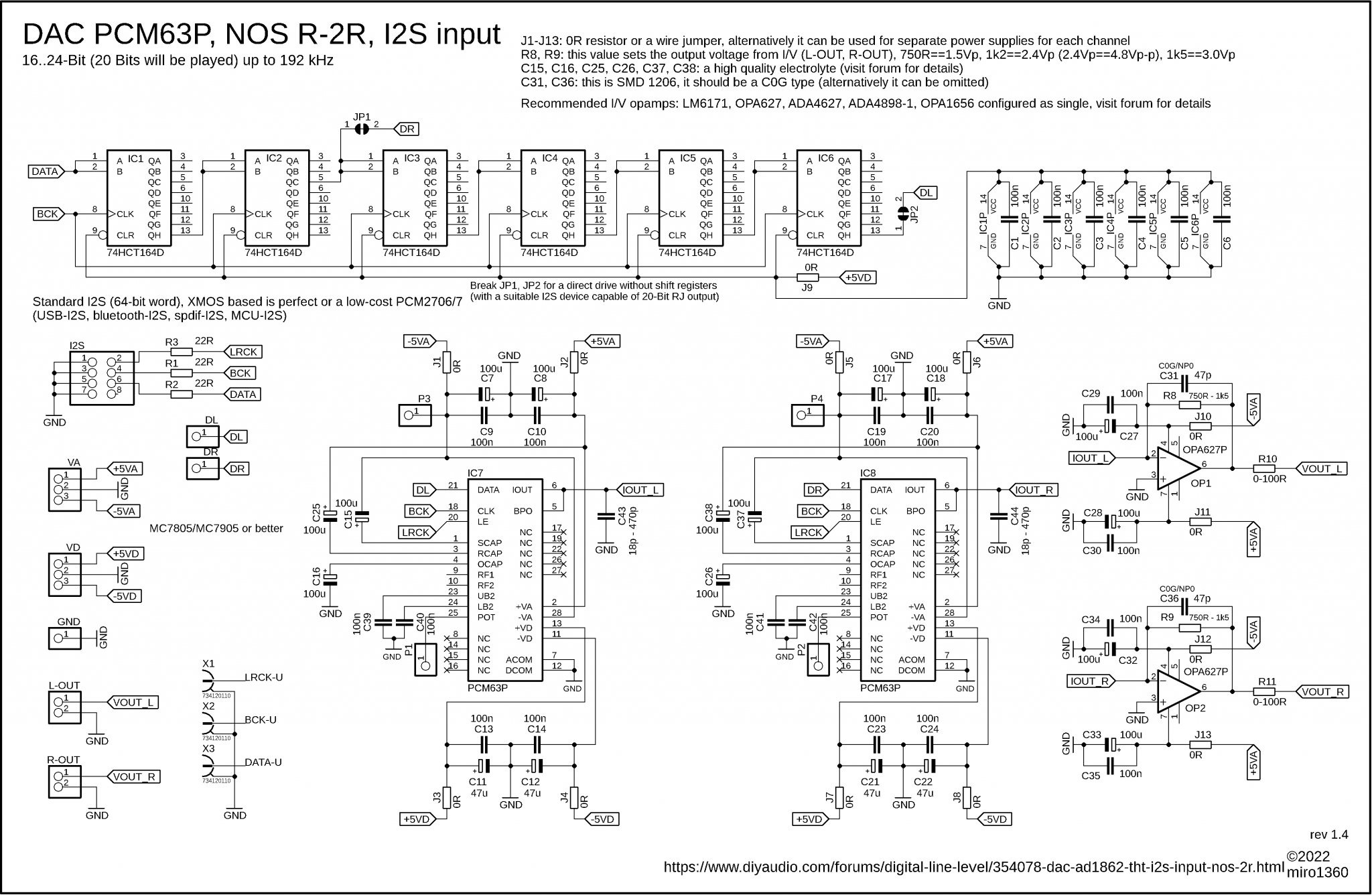

Ok guys, here it is 😎
The output current is 4mA (+-2mA) ==> I/V resistor is the half of the AD1862 for the same output voltage range.
Output capacitor C43 + C44 is optional (it can fight against potentional glitches - first try the sound without this capacitor) 🤔
Capacitors C7, C8, C17, C18, C27, C28, C32, C33 can be 100uF-330uF UFG or UKZ, or another high quality audio capacitors.
Capacitors C15, C16, C25, C26, C37, C38 also a high quality audio capacitors, can be larger value as in datasheet (you can do some experiment with different values, also you can install parallel some 0805 SMD C0G 47nF MLCC from the bottom (like C0805C473J8GACAUTO)) ... Try 47uF UKZ or UFG.
PCB contains pins for optional MSB adjustment circuitry, in that case C39 - C42 will not be installed, or can be? (datasheet page 8) -- I did not place parts on the PCB for this circuitry - hard to recommend this procedure bacause of adjustment difficulty.
BOM example: https://www.mouser.com/ProjectManager/ProjectDetail.aspx?AccessID=b640758624
Note: Very experimental PCB, it may not work at all (sorry for any errors) ... it is also difficult to get the PCM63P for testing, the same situation as with the TDA1541A 🤣

Please check the schematic and PCB for any mistake before ordering and building 😊

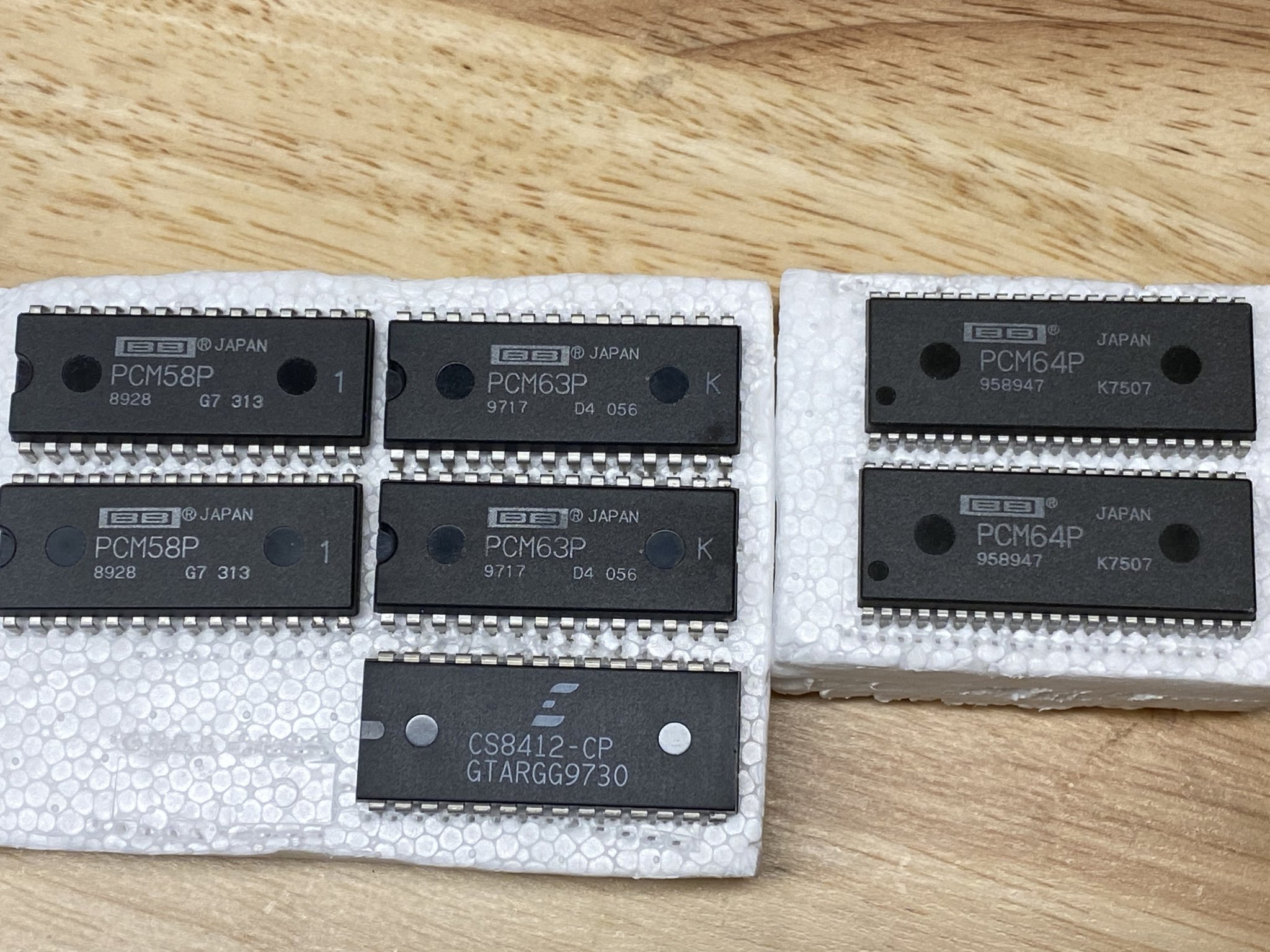

You too need a Dac therapist ? ... I know a good one for caps detox cure, should work for dac chips too...
…..Tell me about it!
And that list doesn’t include the TDA154A’s standing by, LOL!
There could be TDA1540 and TDA1541A right after 🤣 But first I need test the input logic for these chips 🤔Thanks again Miro! The week is not over yet, another surprise hiding up your sleeve? 🤣
