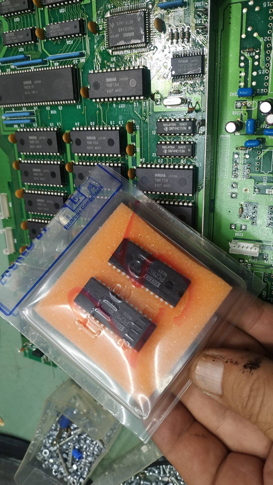

You don't believe me? - I got a two dead chips - one is my and other - from AliExpress. I made a refund!

I really do not understand how you can break two chips, this is feasible but it asks some efforts ! A bad contact of one leg of an operational amplifier is more likely to happen. It could be also one of the shift register perhaps but I do not believe it is. try to check the continuity with a DVM with the buzzing sounding option. Check all the caps polarity of the dac chip on the faulty channel.
@diyiggy, one of the chips from Paddy is alive! He's normal working without artefacts. But I was recently buyed a pair (N-J grade) and install them both. All working perfect! Chip from ali also silent - I tried to swapped him from left to right channel - he's dead definitely also. I don't throw away them - maybe give them to someone for check also. Maybe chips have a protection from shortcut? I don't know. In my town there is no possibility for check!

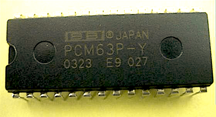

Try PCM63P-Y and let me know if you have changed your mind.I do prefer ad1862 to pcm63 but thanks to miro you can test both at very near iso conf (near pcbs) using same parts and supply but the dac chip...

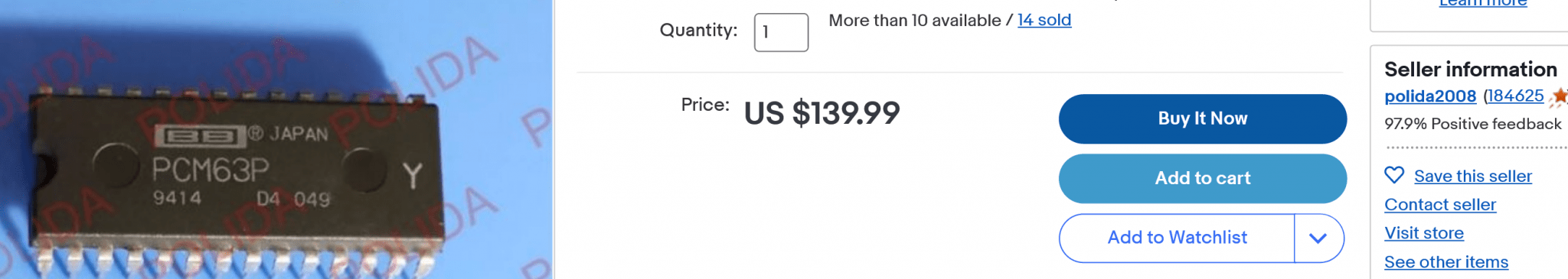

https://www.ebay.com/itm/273089900796
Wow, this would mean sending 280$ to a seller with lower than 98% pos. feedback. :headscratch:

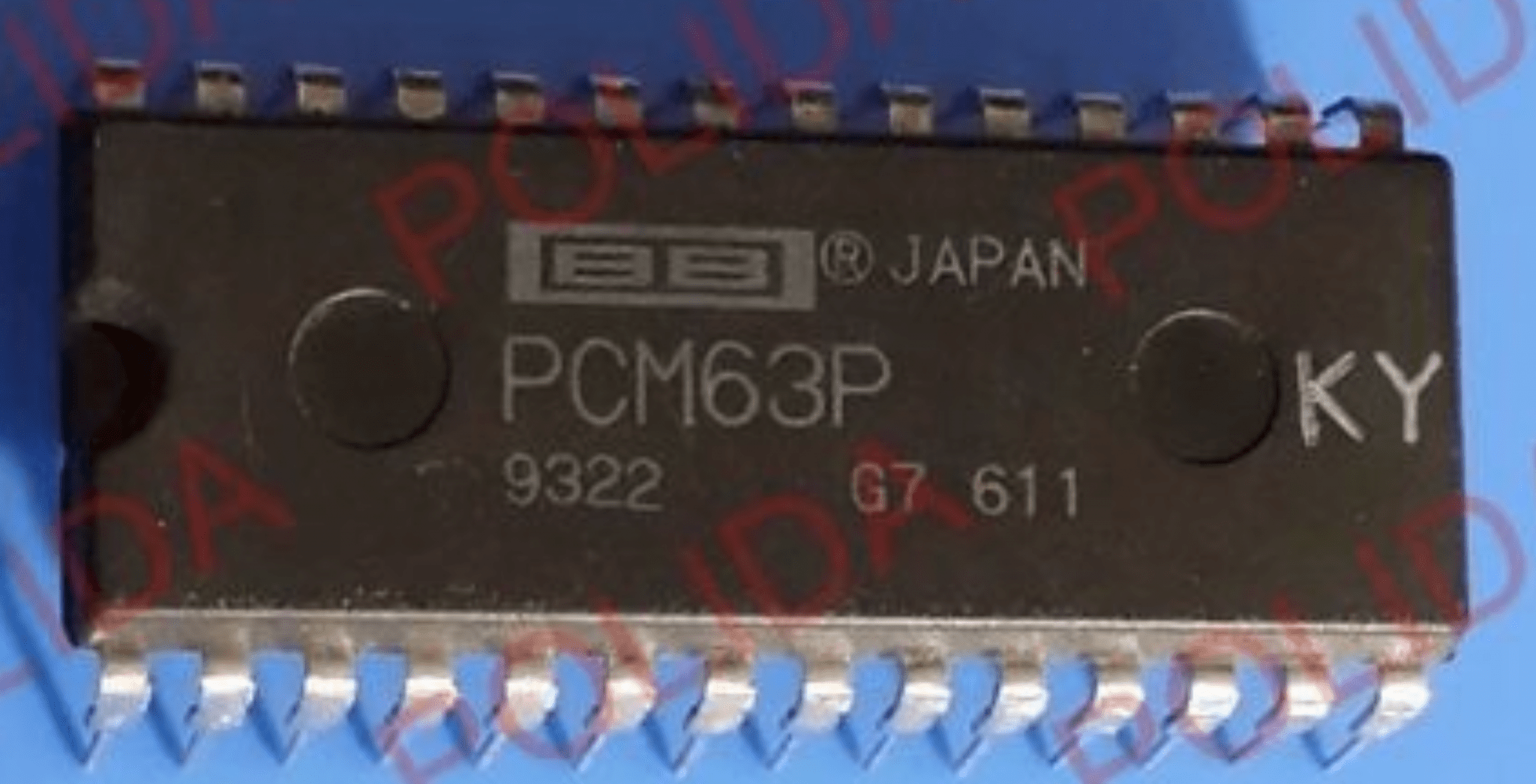

That ebay seller is infamous:
https://www.diyaudio.com/community/threads/polida2008-a-real-thi-ef-on-ebay-fake-mosfets.268431/
Who would?
Who would? Apparently some eager to pay for a "Y" as there are "14 sold" !

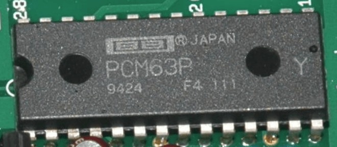

They could have at least printed the lettering to look more convincing:
The standard of forgeries is so disappointing sometimes. Theres really no excuse when DIYaudio members even show them the real thing to forge:
