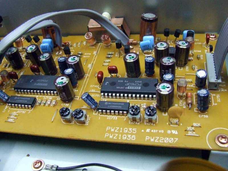

Yeah....smoking Pioneer PD-8500 CD player 🤣+_VccL that goes to +_12V?!
I smell profume of smoke

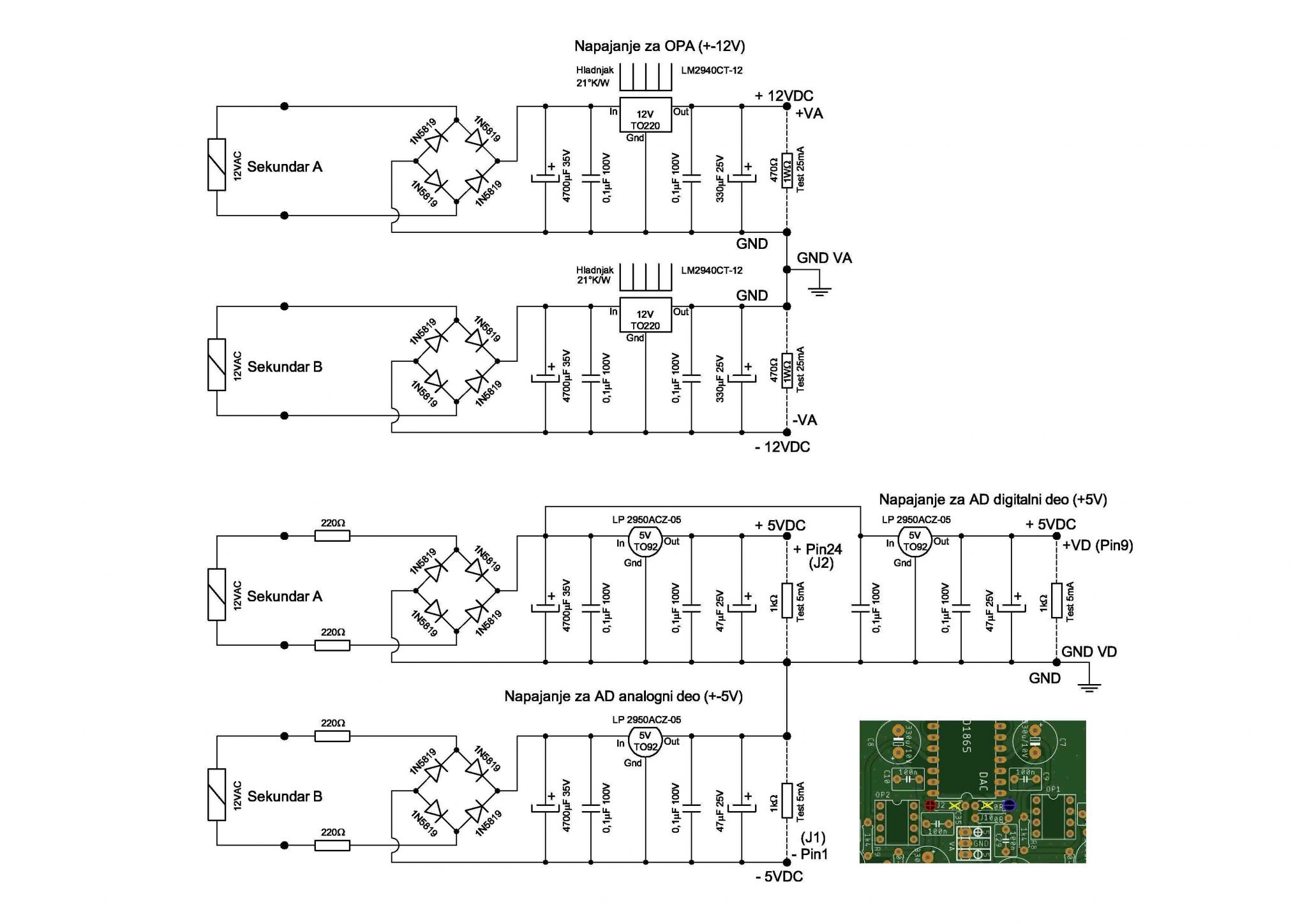

I am interested in how much current the DAC consumes (with AD1865), primarily the digital part with shift registers (+ 5V). At the moment it is very difficult to get adjustable version of the LT1963/3015 so I have to make an alternative power supply. For + 5V. That’s until I get LT regulators. I plan LP2950ACZ-5.0, (TO92 100mA), for +5V digital part. The analog part with OPA will be + -12V with LM2940 CT-12 regulators. OPA is Sparkos SS3601. The analog part of the AD1865 will be + -5V with LP2950ACZ-5.0 regulators. The transformer has two 12VAC secondaries, 16VA.

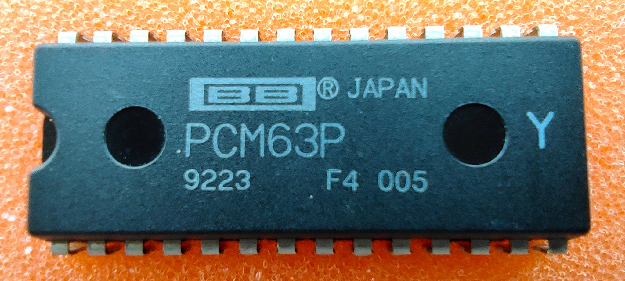

I only saw one man do this with PCM63P - Orronoco at blogspot point to point, but he didn't have JLSound or WaveIO, that means a lot. 😎This is first version which I see for all my experience) It's very interesting the final result!

AD1865 is power friendly, very low current consumption.
25mA for digital part with shift registers is enough 😉 ... analog part +-30mA.
