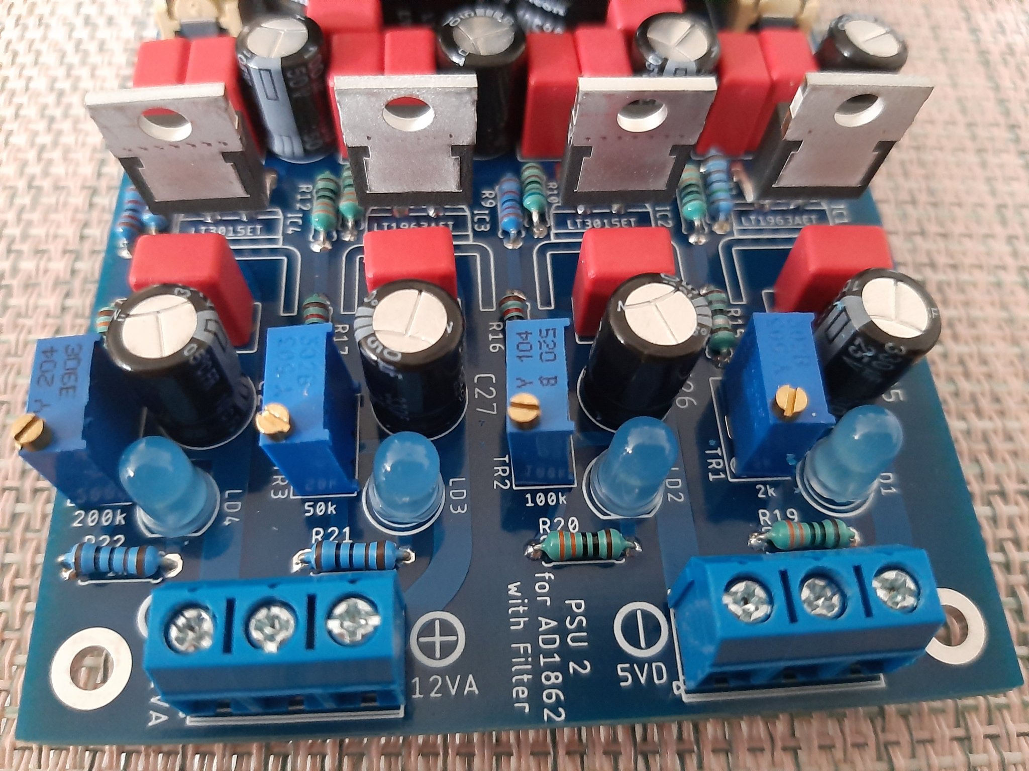

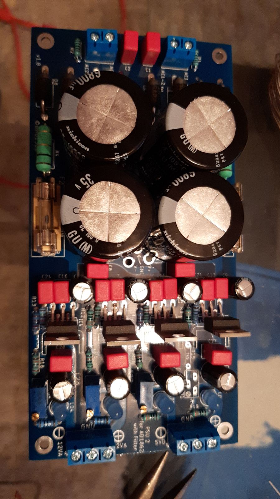

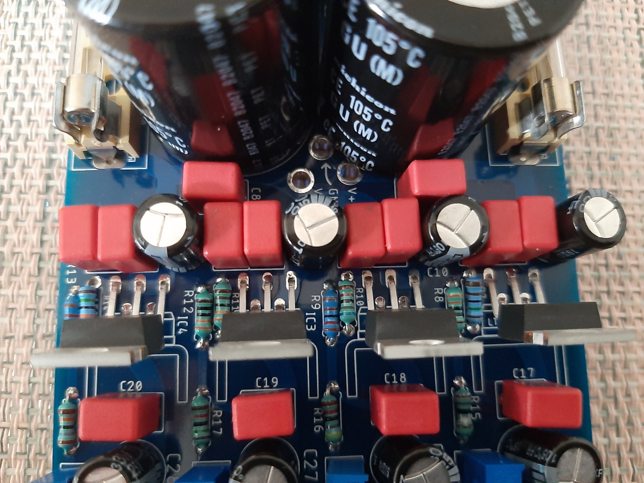

My PSU2 board is not working. On all 4 outputs I get 18V. Can capacitors C25 to C28 be a problem. They are Panasonic EEUFR1E3313 30uF low esr capacitors.

Post a few detailed photos of your PSU2 🙂My PSU2 board is not working. On all 4 outputs I get 18V. Can capacitors C25 to C28 be a problem. They are Panasonic EEUFR1E3313 30uF low esr capacitors.

@ Zarkstic : check the code color rings of the resistors story to see if you made not an error there.
Check LDOs - whether they are cold or hot. If they are cold as ice - mouser again.😢I've measured each resistor and put them in their place. the only difference is R15, I don't have 2k5 but 2k7.
It can not be the caps. If you had checked twice the pots and resistor values and have not inversed two resistors, then indeed one reg ic maybe damaged...

A friend got it for me. From Farnell I think.@skrstic Where did you buy the LDO regulators? 🙂
It should not be the output capacitor, but try to remove the electrolyt from the output and measure the voltage only with foil capacitor. Otherwise the components seems be installed good.
I don't have an oscilloscope. I'll give it to a friend who has an oscilloscope and he'll see what happens to the power supply.
