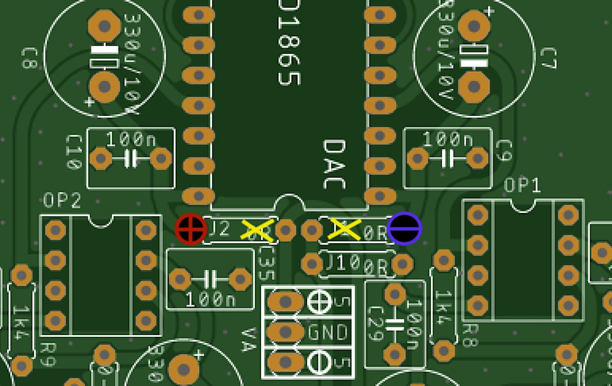

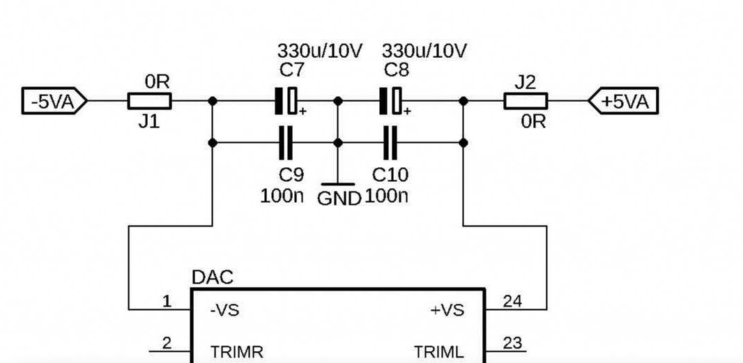

I think there is another cheaper solutionI/V opamps can be powered separately. Don't install J10, J11, J12 and J13. Use these pins for the +-12V PSU:
(+-5V still be needed for the AD1865)
Don't install J1 and J2. Use these pins for the +-5V PSU
Below the connector where it says VA becomes + 12 / -12V
Capacitors C27, C28, C32, C33 change to be 100uF / 16V

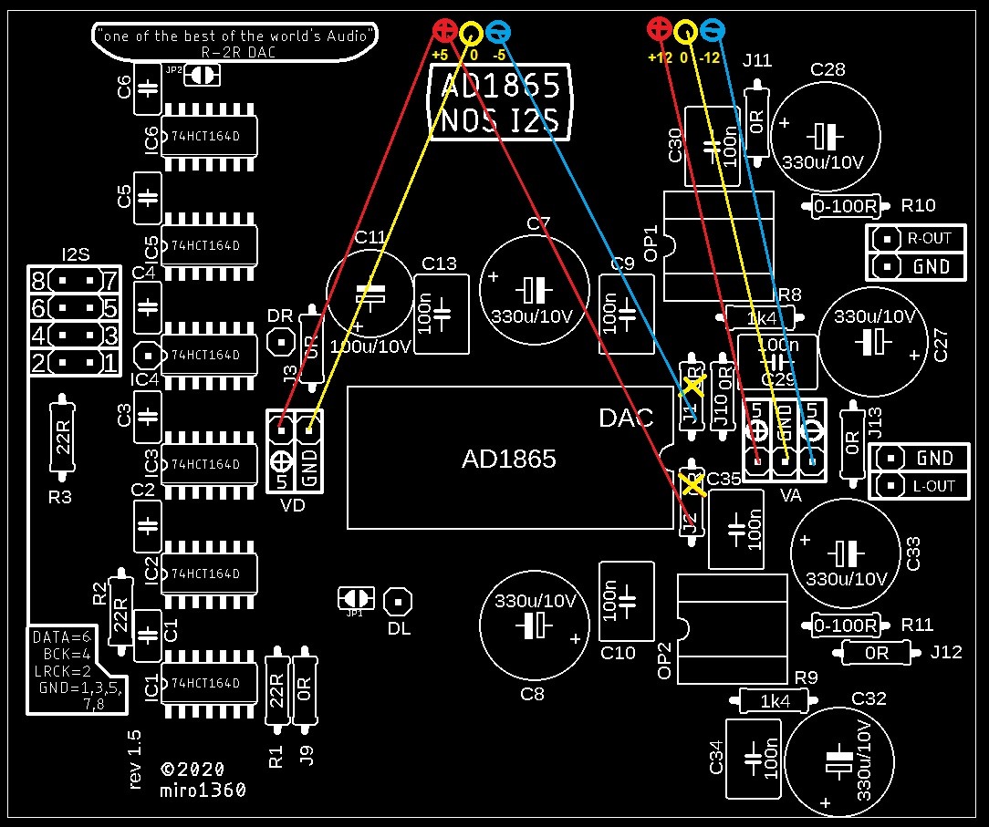

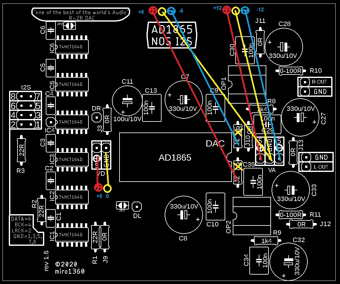

Recap:
v1. - 1 PSU board (+5, 0, -5 and +12, 0, -12)
v2. - 1 PSU board (+5, 0, -5 and +12, 0, -12) + 1 PSU board (+5, 0)
miro1360 please confirm.

Use v2 😉Recap:

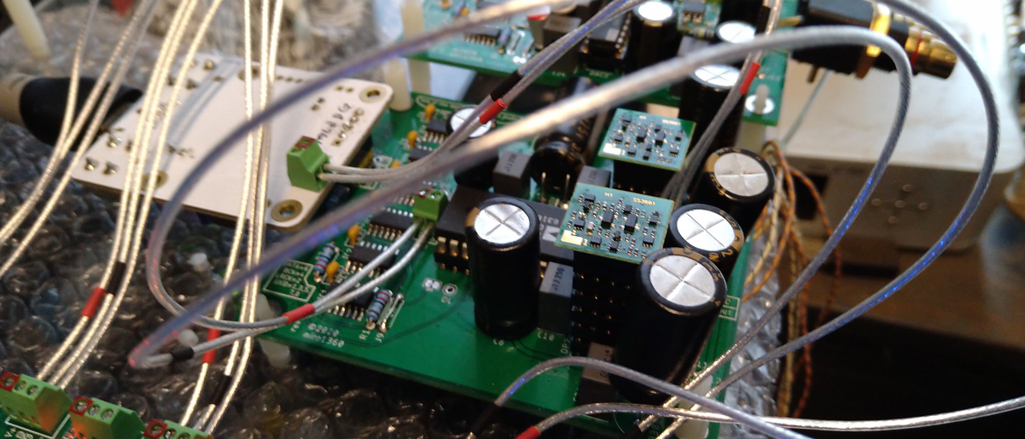

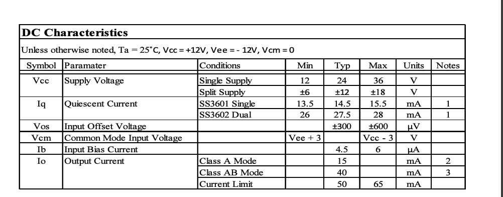

it works with +/-5v, sound beautiful, dont want to put it out, i will try +/-12v later.And Sparkos voltage is minimum +-6V
So whoever tried Sparkos at AD1865 PCB - didn't hear how Sparkos really works ...![]()
what discrete op amp modules are these?it works with +/-5v, sound beautiful, dont want to put it out, i will try +/-12v later. View attachment 1063103
I have to go at least +-10V - since I listen them directly to headphones. Although +-9V is the optimum for Sparkos from datasheet.ss3601.
I've never tried it with + -12, I don't know how much it will heat up.
