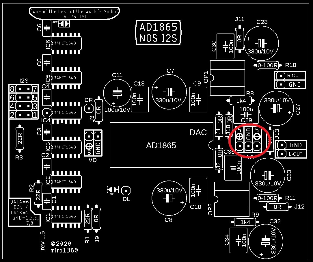

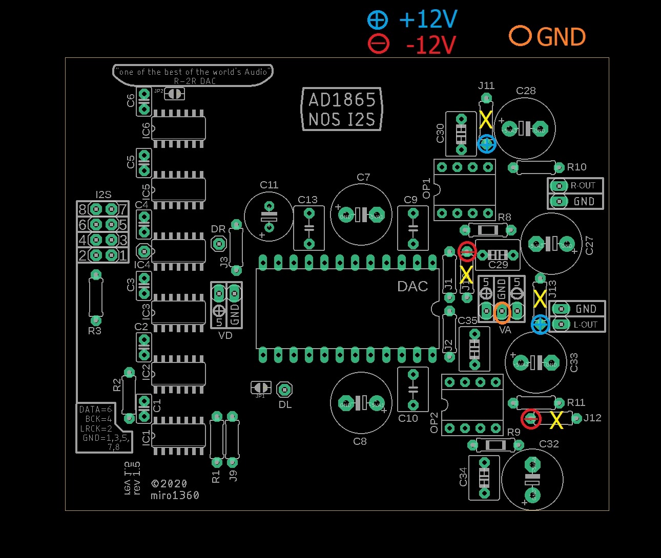

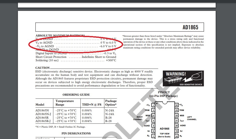

Hi, on this board the DAC chip AND the opamps share the same +-5V psu. The AD1865 analogue part needs the +-5V, so you can't just raise it to +-12V. If you want to supply the opamps with +-12V, you need to supply it separately and then you need 3 psus. You just have to remove two of the jumpers (probably J10 and J11) and apply the third supply there.

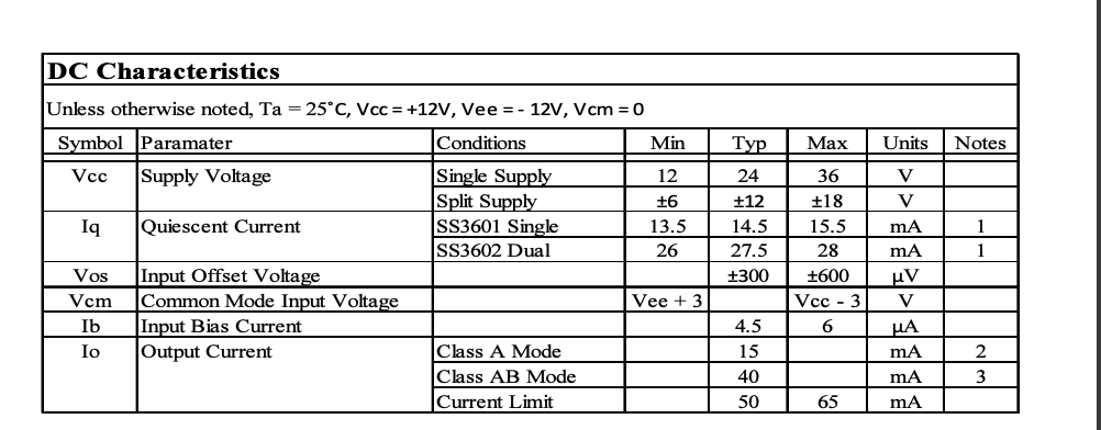

And Sparkos voltage is minimum +-6VI wasn't sure that they share 5V. Thanks.
So whoever tried Sparkos at AD1865 PCB - didn't hear how Sparkos really works ...
I got it.Anyone have a AD1862 chip to sell to me?
I only need 1.
5v limits the choice of OP amps.

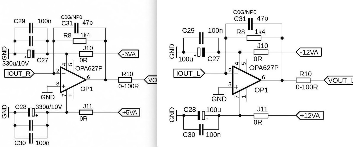

I/V opamps can be powered separately. Don't install J10, J11, J12 and J13. Use these pins for the +-12V PSU:
(+-5V still be needed for the AD1865)

We need a whole PSU2 just for opamps.Thanks miro160. Can i use +5 and -5 pins and 0 of VA? 0 common for 12V?
Then another PSU2 with + 5V / -5V for DAC
+ 5V for shifters and JLS output
And the third in my case Studer900 LPSU board for XMOS JLS (I want only D+ and D- from PC)
It's real overkill. But who cares😎
I assume that if the power supply of the opamp is from + -5V and higher, there will be no difference for the ears, but the measuring device can detect lower THD 🤓Miro, would you expect a noticable sq benefit.
