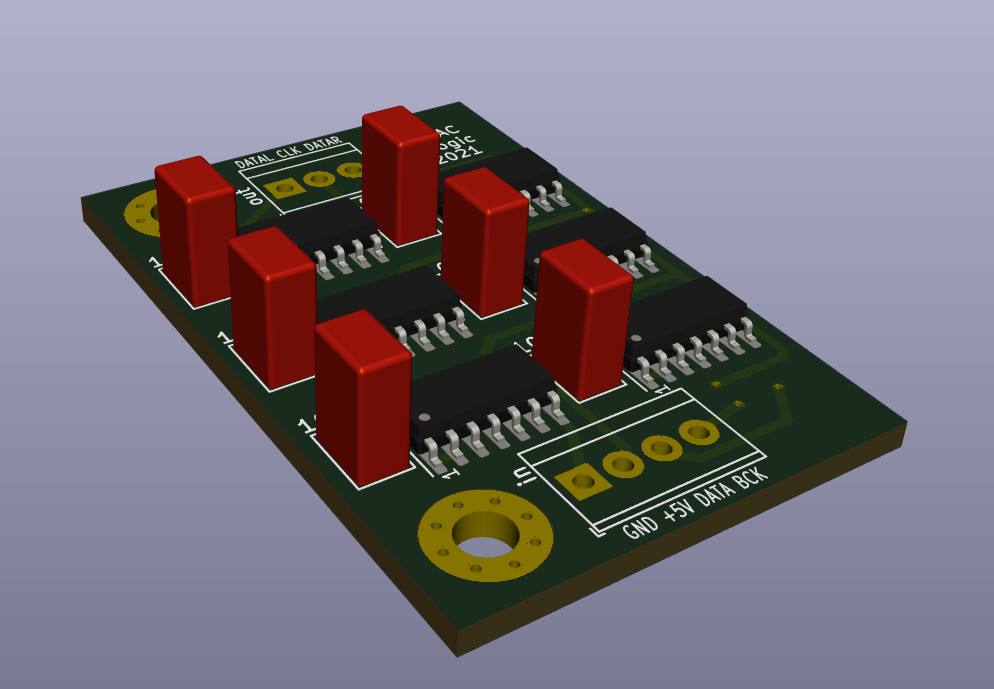

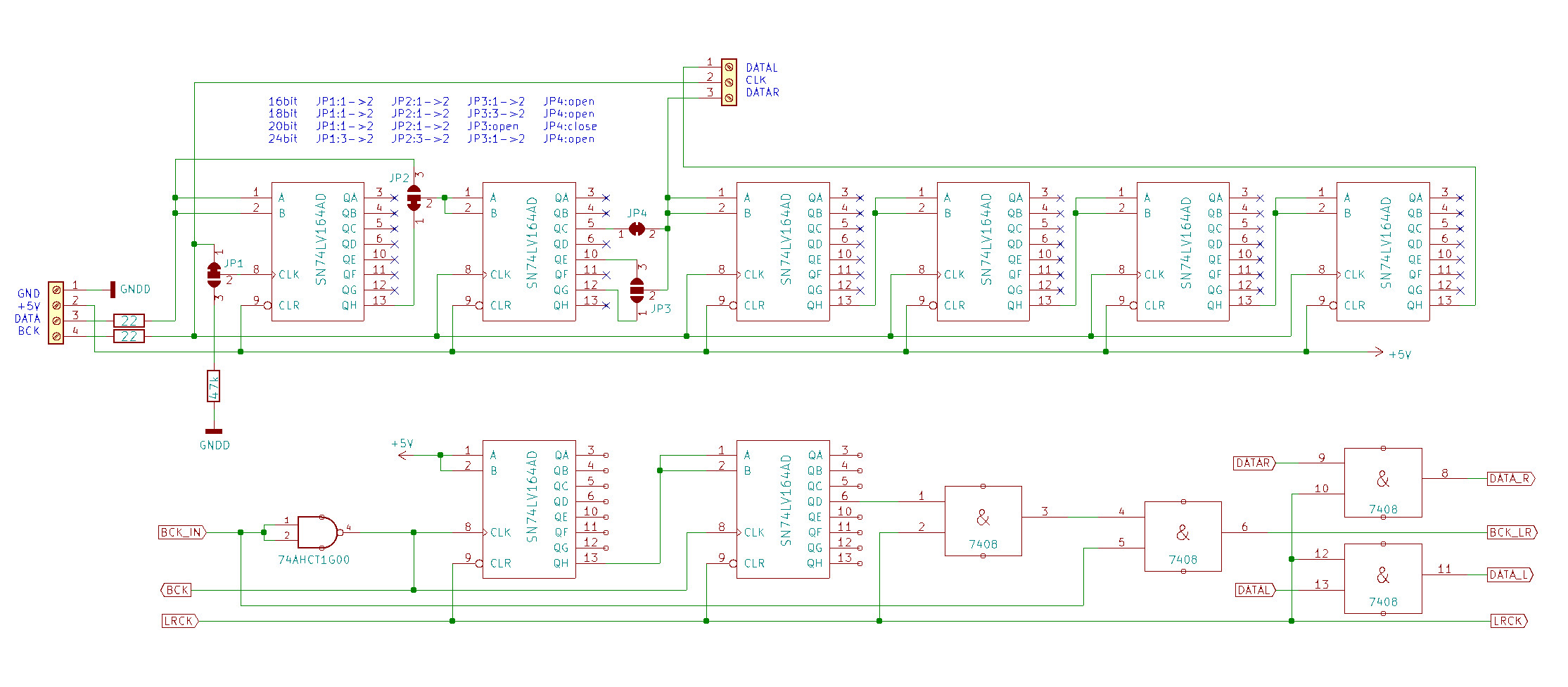

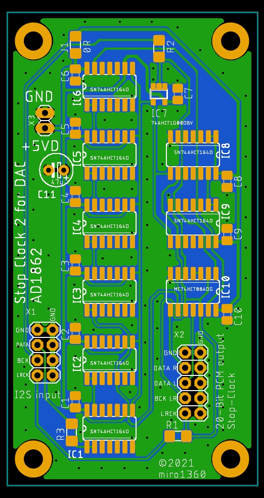

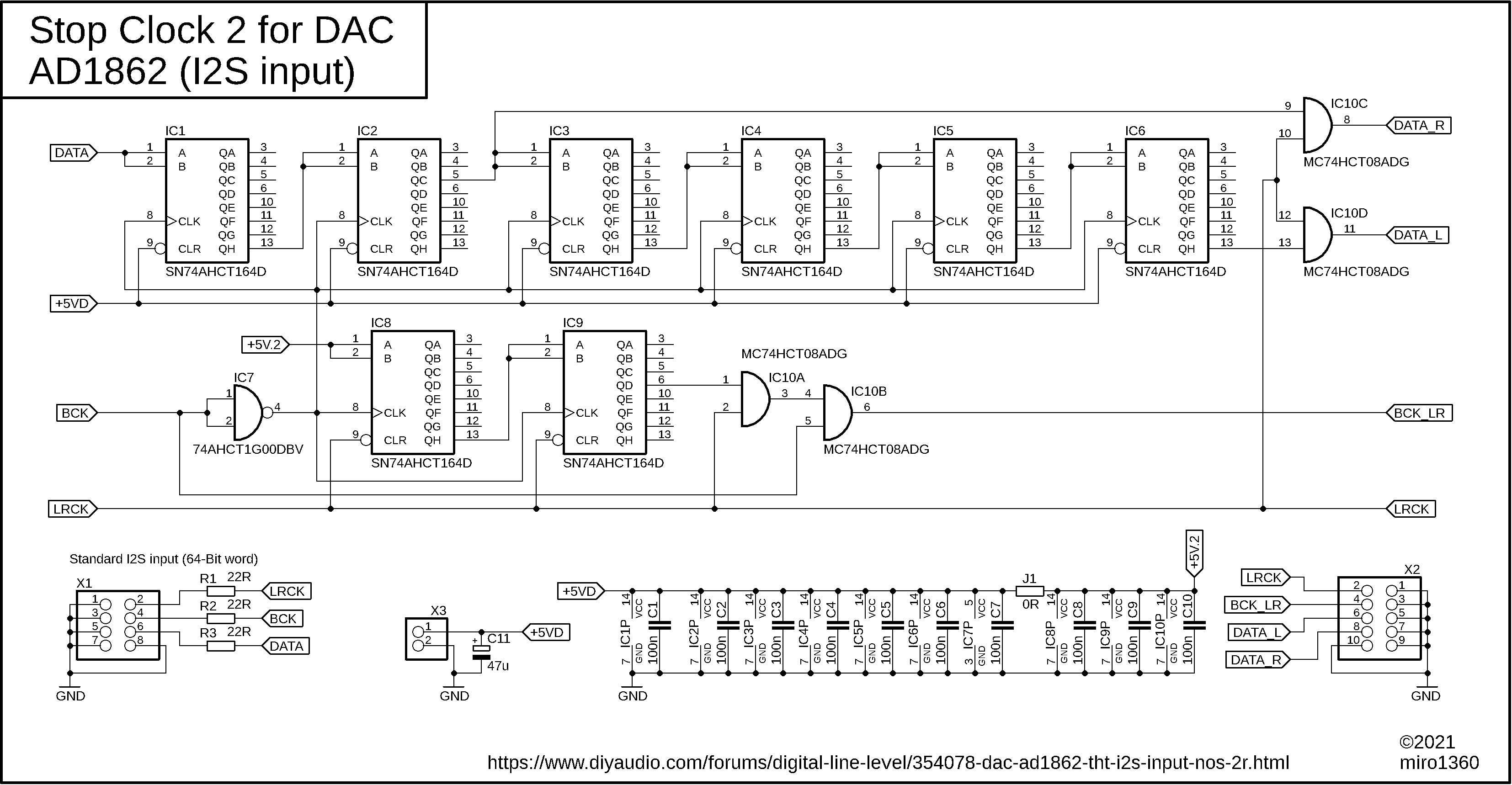

Stop Clock 2 for DAC AD1862 - PCB
Stop clock 2 for AD1862 #2832 - untested 😀
If someone confirms that it works, I will create a DAC PCB with this logic.

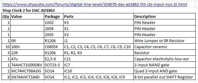

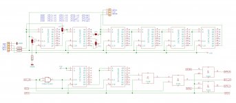

I don't have the parts for the stopped clock logic, but I have a populated gluelogic board which can be used to test the stopped clock circuit:
attachment.php
Here is the schematic:
attachment.php
The upper part is on the PCB, the lower part is Miros additional circuit: just wire it together with my pcb as shown and it should be possible to see if everything works. If anybody wants to do this I am happy to provide the pcb. I would be particularly interested to see if both channels benefit from stopped clock as timing seems to be slightly different!

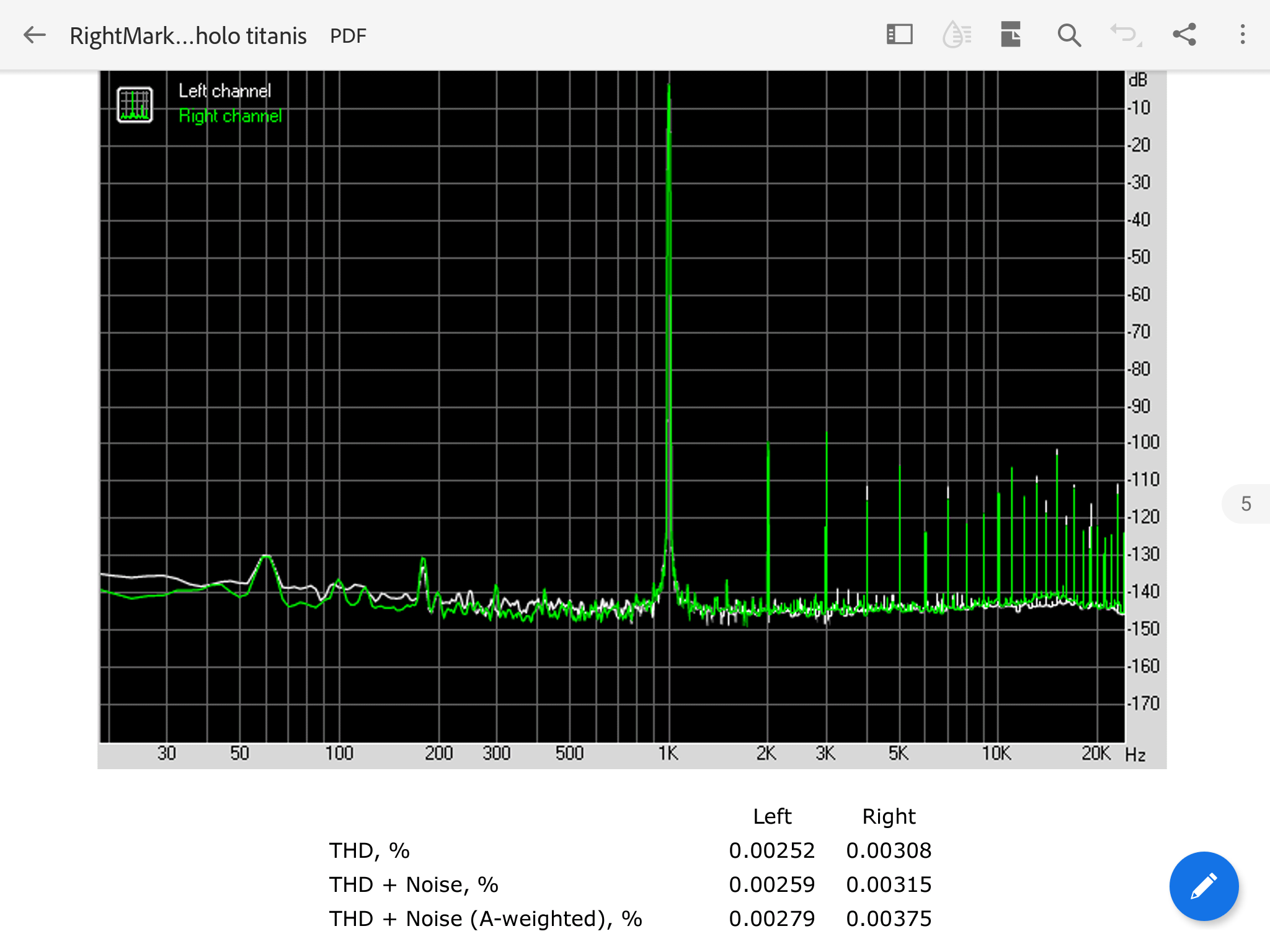

I didn't notice any drastic differences in the distortion spectrums of different opamps. They all look quite clean except for the harmonics. Here is an example.
My experience is that THD measurement is a very effective way to catch any ringing or oscillations, that have an effect on the audio band, without a scope. Whenever my opamps run into oscillations, the THD measurements go wild.
This was how I probed the dac with my scope: first, I connected the dac line out to my headphone amp line in, then I paralleled my scope probes to the same dac out put, probe to positive output, ground to output ground. I set probe to 1x to be more accurate.
I didn't take a scopeshot because I didn't see anything interesting or weird. There were just +-8mv voltages noises when the dac was on standby. There were no regular waves or patterns of oscillation. Once the dac started playing, the voltage started to jump up and down, with a peek to peek voltage of 3V with a 1k5 feedback resistor, which looked quite normal.

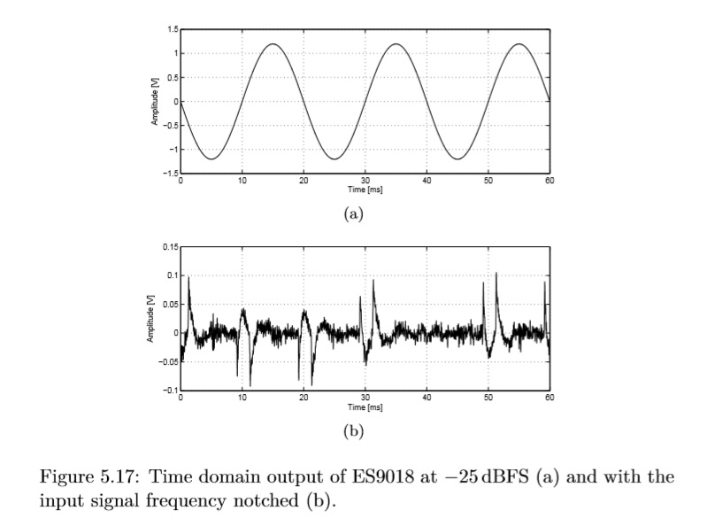

Those harmonics look quite audible, to me at least. That's a problem then. A lot of the spurs could simply be related to insufficient filtering of a zero-order-hold dac output. May take some work to figure out and fix all the underlying causes.
Sometimes people will choose not to filter a dac output because they don't like the filtered sound. To me it means there is something wrong somewhere, maybe multiple things. Could be there is a problem with filter implementation. Could be other problems are making the dac sound muffled and the distortion is sort of helping to cut through the mud to produce a sound that seems more balanced and clear. Hard to say for sure without hearing it on good, very low distortion speakers (electrostats). Short of having reference grade speakers, a good headphone amp and good headphones can help make it easier to hear what is really going on with the sound of an audio device.
Guess I will say here the same as sometimes advised to others: it may be worth building your own Pass HPA-1, since there is a forum thread on it with a schematic attached to one of the posts. Stereophile uses it as their reference HPA to compare the sound of all headphones in reviews. There is no better HPA for that purpose at this time, at least not that I know of. One thing to be aware of is that HPA-1 is not the same as Whammy. Two very different designs.
Once one has reference grade reproduction equipment then tracking down and fixing problems in dac designs by ear becomes much more practical. IMHO distortion measurements are good too, but they don't tell the whole story about SQ. For example, clock jitter can affect SQ but it tends to look like noise on an FFT. May or may not sound like noise to a human though, again this is just IMHO.
EDIT: Regarding looking at dac distortion with a scope, unless the distortion is really severe it will be hard to see on a scope. The way to see it in the time domain is to use a notch filter and some makeup gain after the filter to show a "notched-out time-domain filter-residual." Example pic attached below.
