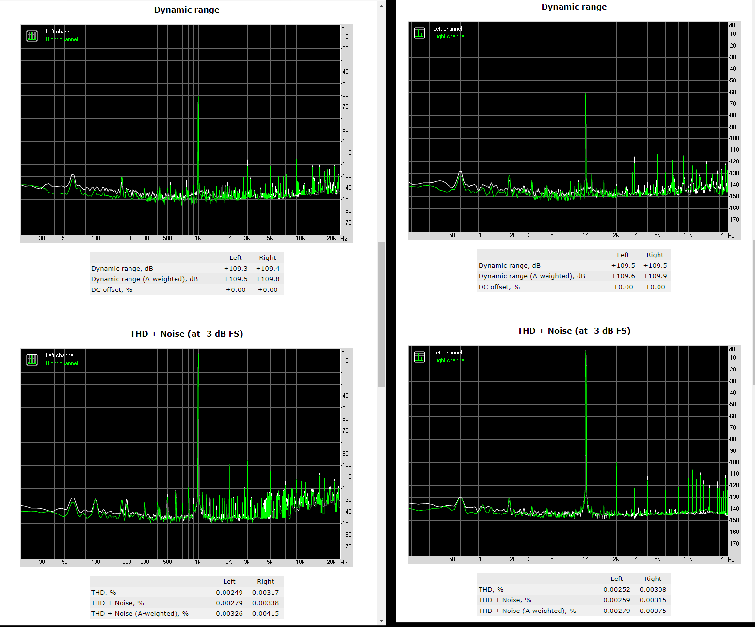

I ran pink noises for a whole night and I measured again. This time the left and right channels performed identical. It turns out that there is nothing wrong with the PCB layout for either channel. I confirmed the measurement results with both AD797 and Sparkolab SS3601. I have also found that SS3601 performs even better in the test, with THD down to 0.002780%.
View attachment RightMark Audio Analyzer test _ [DirectSound] miro ad1862 SS3601.pdf
Then I tested with Holo Titanis in the usb link. And I was surprised to find that the Titanis actually cleaned up a lot of my computer noises that got into the dac despite that I was using an isolated XMOS board.
Here is a graph to show how clean this dac can be once the usb noises are removed. The left two graphs are without Titanis. The right two, with Titanis.
Here is a complete report with Holo Titanis in the usb link.
View attachment RightMark Audio Analyzer test _ miro ad1862 ss3601 holo titanis.pdf
Cheers!

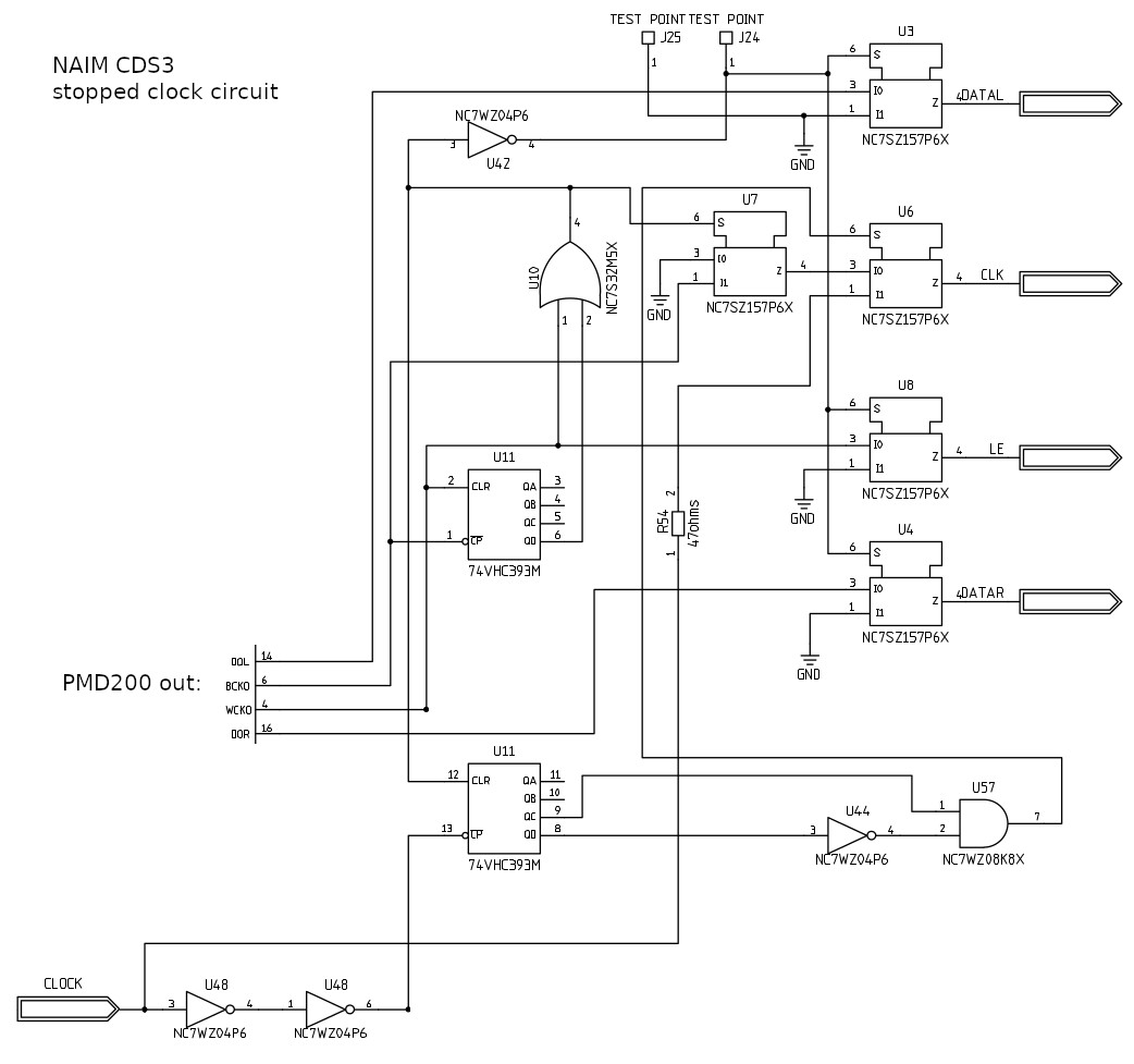

@jpk73 See the main board diagram on the first page (CDS3main_R4.pdf)
There is only one CLK common for both DACs, therefore it cannot be stopped.
PMD200 outputs dataL/R simultaniously to the DAC chips, and they share one clock. This clock comes from the stopped clock circuit. Simulation of the circuit showed that actually it does stop the clock. You don't need 2 clocks for stopped clock operation! PMD100 and other chips also output one stopped clock for both channels.
In the AN207 note stopped clock was designed to make R and L appear in sync. But later it was found that stopped clock improves noise as shown in diyinhks scope shots...

@miro1360: that's what most DF chips do. So it seems stopped clock logic is not needed for aligning channels if used after a DF, but for reducing noise it's still very interesting. Also it could be worth to reclock LE before the DAC chips. But maybe that's a different application than what you had in mind...?
@jpk73 Aligning I2S DATA with stopped clock logic that way needs a lot of glue logic (or CPLD, which only a few can program at home 😀). If I come up with something simple, I'll make a diagram 🙂
Should be doable 😀

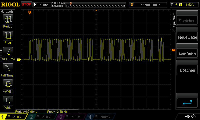

I attach the stopped clock logic and a scope shot I took from my Naim. It shows the stopped clock, taken from pin4@U6: it seems it is only stopped while the output of the DAC gets updated...
BTW the lower part of the original schematic around U51/U52 is a watchdog circuit because the PMD200 sometimes fails to be programmed - see here.

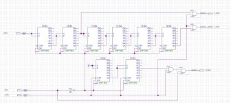

Stop-Clock2 20-Bit AD1862

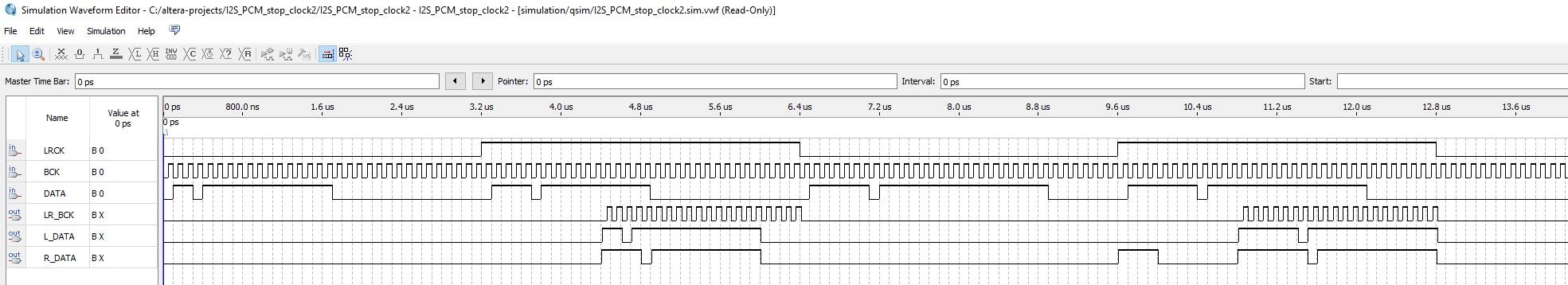

@jpk73
I created it 😀
Stop-Clock2 - both channels are aligned together and with one stopped BCK moved for Left and Right DAC.
Latch (LRCK) is untouched 😎
At least 9 ICs are needed 🙂

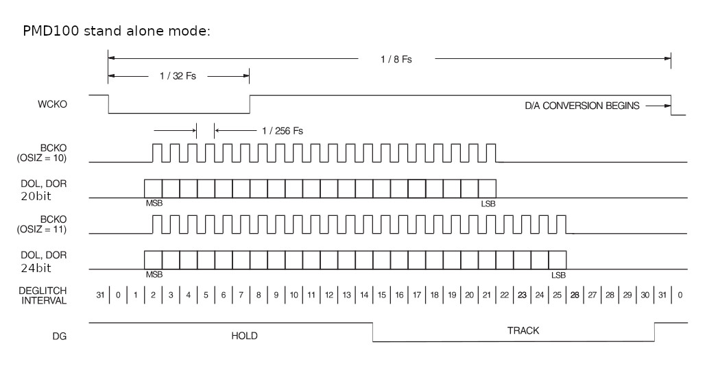

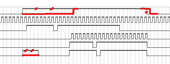

@miro1360, looking a bit closer at your diagram I think it might not work that way. From the PCM1702/4 datasheets: "if BCLK is stopped between input data words, the last 20/24 bits shifted in are not actually transferred from the serial register to the parallel DAC register until WCLK goes LOW. WCLK must remain LOW until after the first BCLK cycle of the next data word to insure proper DAC operation." This is also shown in the PMD100 datasheet, see this screen shot:
attachment.php
An inverted DG also might work as WCKO. Here is what I think how your digram could look like:
attachment.php

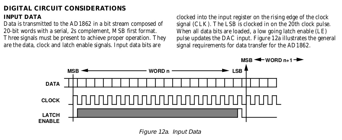

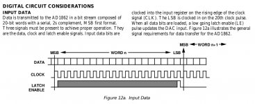

The timing diagram of the AD1862 shows the same requirement: WCKO stays low until after first BCK cycle of DATA transfer, goes high, and goes low again only after last BCK cycle of DATA transfer:
attachment.php
What do you think?

The "unwanted" DATA is not feeded into the DAC because the clock is stopped. Making it total clean adds to the complexity 😀
