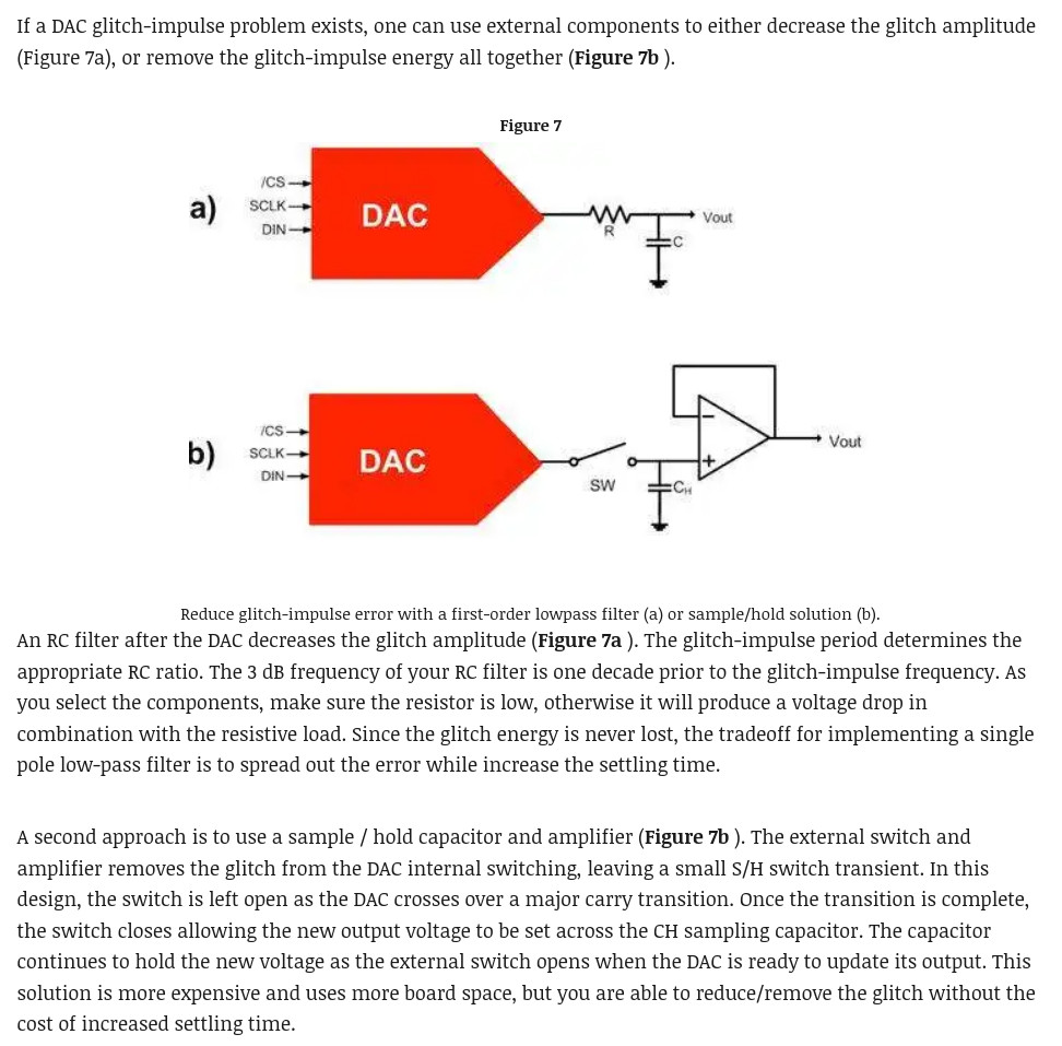

BTW what is the deglitch output signal for, that some digital filters offer?
EDIT: just found a good explanation regarding the last question here.
