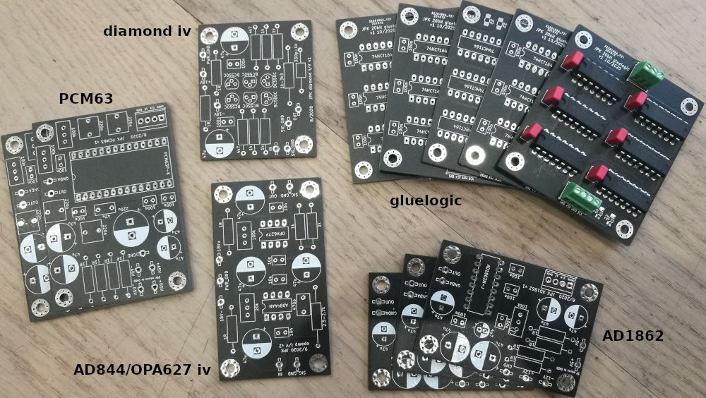

I checked my parts bin and found some left over PCBs from my modular DAC project which could be handy for testing purposes - if anybody is interested drop me a PM. For testing the stopped clock circuit the PCBs for AD1862 and the gluelogic DIP version (one is populated) would be useful as mentioned in this post. The circuits are very similar if not identical to Miros. Also I have iv-stages with opamps and the discrete diamond, each one PCB. And finally PCBs for PCM63. All PCBs are tested and working.

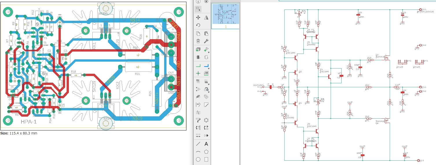

A few days ago I designed testing PCB of this HPA-1 for my friend who has good ears listened to various other devices. Without solid GND plane, but if the basic will sound good, then I will improve it. I wonder what he will say :yes:
Oh, no doubt it can be improved. I would only suggest to build the original design first in order to make sure any mods really are improvements in SQ, not just improvements in measurements. You know what I mean, I think.

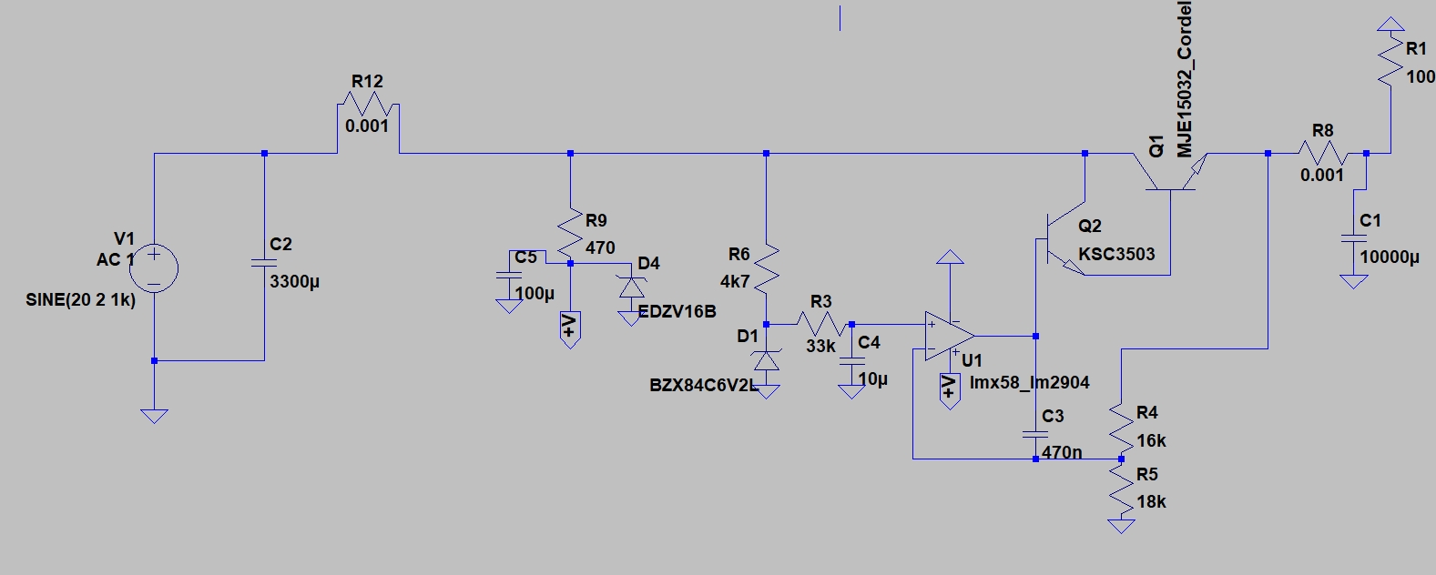

What do you think about this PSU? I created simple LM358 based PSU with an emitter folower stage, which is stable for any capacitance load.
Maybe I would create something from discrete parts with this stage, but I don't know any good schematic or design 🙁

Miro, why not to try to supress the resistor between the base and the output and not to stay for a simple ref or zener stack at the base. Sim will be worse but what about the dynamic ? I would supess the last big resistor for something closer to 0,5 to 2 uF but film cap and divide the first 3300 cap by two of 1200 I can give the reference if you decide to test that way. I like a lot that topology and sometimes we just don't care about better thd number or ultimate stability.
My two cents.
Um... If building HPA-1, it may be best to build it according to the original design first, let it burn-in for at least two weeks, then get used to the sound. At that point might be a good time to do some modding experiments to see if it can be made to sound 'better.' I already know some improvement is possible, but I'm under NDA. Sorry. If someone does figure out how to make it better in A/B tests in particular, then other builders might interested to try it as well. The difficulty of course is not fooling one's self in listening tests. Could be something to talk about more if anyone gets to the point of A/B experimenting on the original design.
Thanks iggy and Mark. I was referring to psus for the dac chip in Miros pcb and also maybe the mirror discrete IV. I have some nice small psus, unregulated as such but healthy capacitance MX. Might try them.

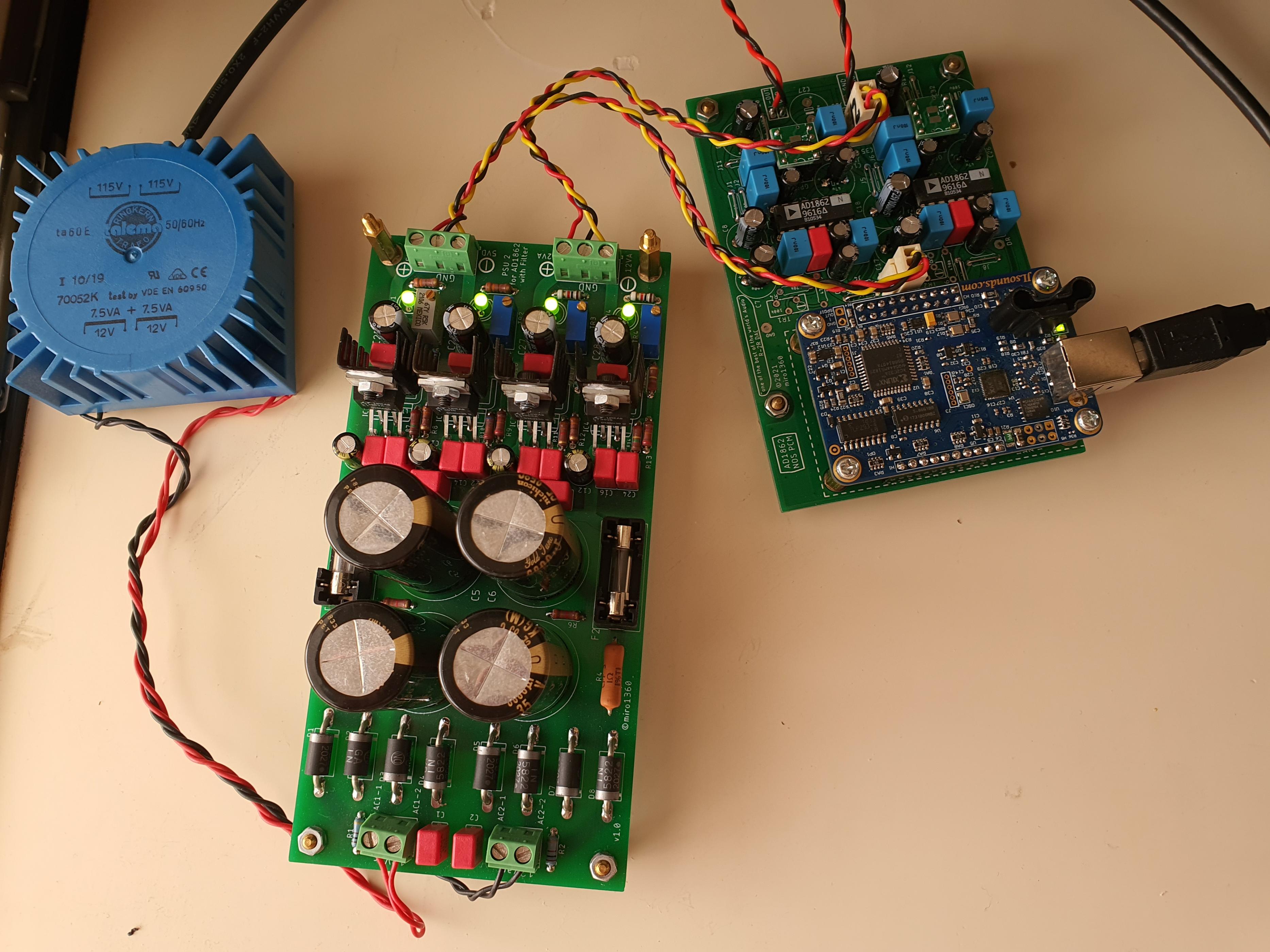

AD1862, I2SoverUSB v.III - not flipped, 20-Bit uf.l connectors
meanie, and others,
I was not able to open your image referenced in the Title and in post #2682, in the format posted in the thread . I think these type of formats become non-responsive after time.
I would really like to see what it looks like, as I may want to venture down this avenue myself.
Meanie, could you post another pic of your setup, or anyone having a pic of meanies setup?
Thanks,
MM
meanie thanks, that is useful for those of us closer to the front end of the learning curve.
Even though the JLS board is attached to the miro board, it looks like we still need to prep that with jumpers as it details in the user manual. Is that correct?
If I understand correctly that's why you've got the jumper on J4 on the top of your USB/I2S board?
