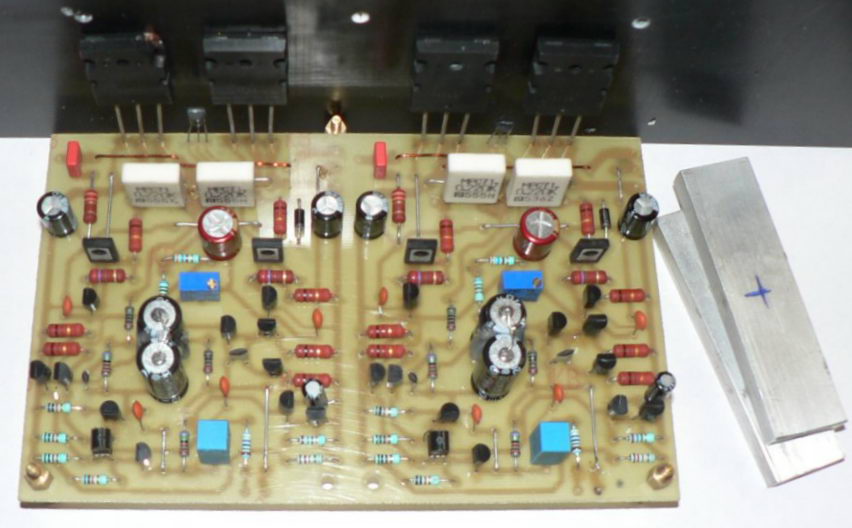

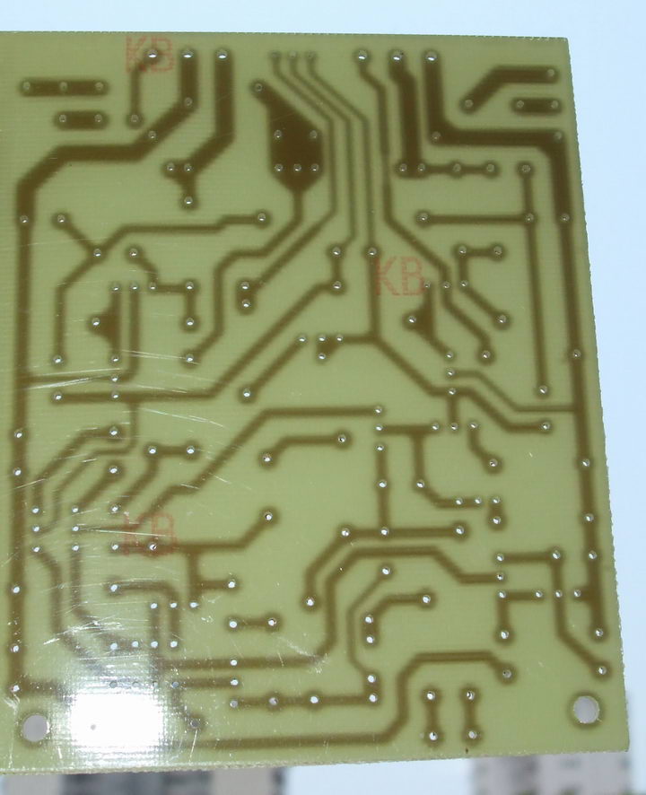

Please folks, do you have the layout to help me to build this Cyrus one
Here is the board.
Some layout with transparence (Ray X) will be interesting...or, position of parts and component values over the board.
Of course i can discover that by myself...but will be a hard work and will waste a lot of time doing that.

I have already found the informations i need.
Thank you folks.
Do not know if clone or not clone.
This board you see was assembled by my friend Klaas Veenstra...do not remember exactly..but i think he has made the board and have sent me.
So... seems to me you do not have the layout...sorry folks.
I already have the layout from Klaas... this was made a long time ago... i forgot.... i am quite sure he has made the layout by himself and ordered boards in Nederland.
regards,
