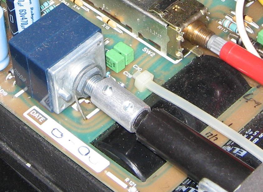

Hello,
I installed an Alps Blue into my latest model Cyrus 2.
It took some careful pin bending but it did work and the results were VERY worthwhile in my case. I suppose that the improvements depend on the condition of the orignal Alps pot. Mine was not scratchy at all but I still found an increased transparency with the new Blue.
I used a kind of coupler that I got from Ebay a while ago but I can't remember the proper name for it. I have seen them in electronics catalogues before. They are aluminium and secured by 2 screws at either end and mate very securely to the Alps Blue. Let me know if you decide to use these and can't find them. I'll look harder or may even have a spare one somewhere.
I didn't extend the existing shaft much but used the original which I cut slightly so that I had the correct diameter hole.
I glued some very stiff black rubber tubing inside the original shaft which then joins to the 'coupler'. The rubber has not been very durable mainly because I am always removing it for mods and repairs to the amp. I would recommend a small piece of metal here for longevity.

hi thanks for the info i would be very greatful if you could search some more to find the shaft you have fitted the pot well tidy
i have fitted mine and it sounds very clean open is this normal for a brand new pot will it its sound change thanks for your help

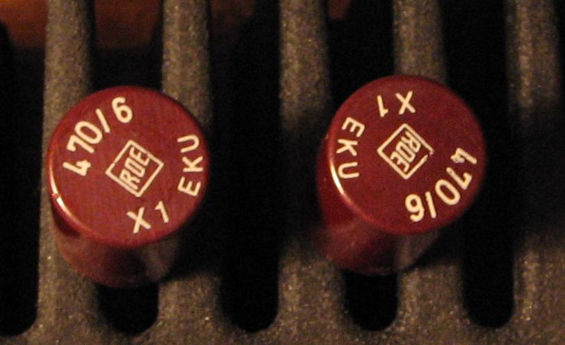

whats gan on said:i have 2 caps in the cyrus 2 i would want to renew they are under the green cable strip they are brown does amny one know what the values are
I think the caps to which you are referring are the bipolar electrolytics in the feedback network. To avoid any confusion, these are the ones that have a diameter of 12.5mm. If we are talking about the same caps then they are 470uF 6.3V non-polarised electrolytics.
If you find a source in the UK of good quality replacements (other than BG) for these caps please let me know as I have been looking, unsuccessfully, for quite some time and have had to resort to using two standard electrolytics back to back.
Those feedback caps are 470uF Bipolar electrolytics. 6 Volts. Other more knowledgeable people have said that single regular polarised caps can be used here because the current is so small but please search other posts to be sure and I think a certain polarity was also mentioned.
I used black gate N type (Bi-polar) here and have bypassed them with a small value polypropylene under the board.
These are in the feedback loop so I didn't mind spending the extra on this occasion.

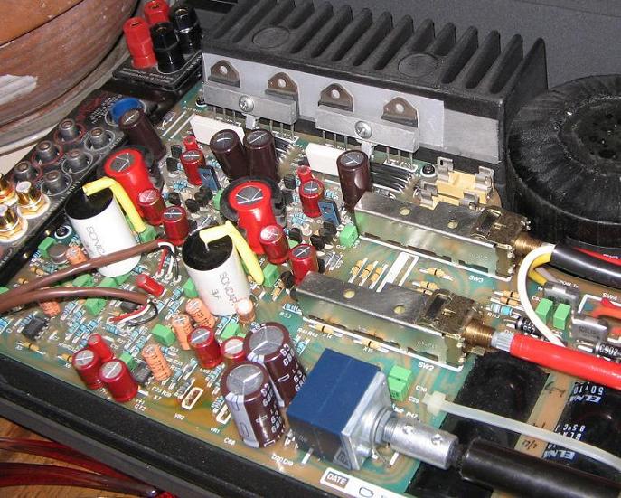

whats gan on said:.........have you any pics of the cap chenges........
Here's a pic of the mostly recapped Cyrus. The only original caps left are the two large smoothing caps (Not used because of PSX) and some in the phono stage.
I replaced the Bipolar electrolytic input cap for a Sonicap. It is definitely too large so I will change it soon.
I have removed the green ribbon cable in favour of silver in teflon wiring under the board. Please excuse the rather idiotic use of Grommets around the 470uF feedback caps. What was I thinking?
