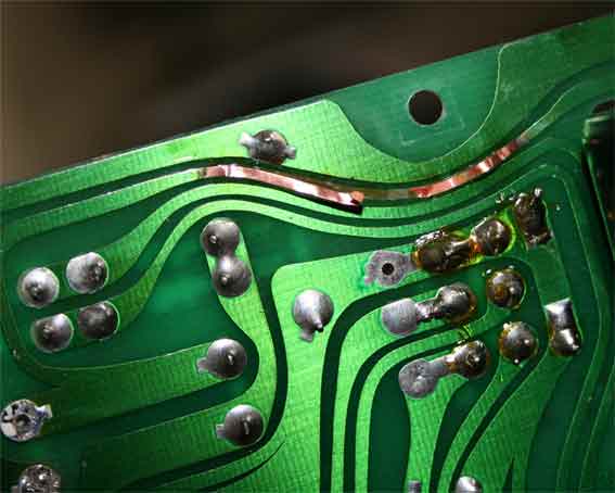

cyrus 2 capacitor
Hi
I desoldered the capacitor but noticed that a track on the circuit board is broken ( see photo )
do you think this was caused by the blown capacitor.
To repair this do i just solder a wire across the break
