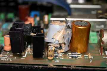

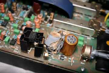

Hi chaps,
I'm hoping someone might be able to help diagnose a problem in a Cyrus II I've just acquired for um, shall we say, sod all. It's an early model, plastic case, push button, 8 output transistors.
The power amp seems fine, I'm sure alot of the caps should really be replaced given their age though.
The preamp section though is fairly knackered. There is a fried op amp in the RIAA-L section, OA5, and a blown cap at C68. The traces are blown between the white supply wire CT and capacitors C63 and C64, and also between X36 and D12.
Sadly this is about as far as my ability to diagnose the problem gets... but if someone could point me in the right direction, I reckon I am in with a fighting chance to get the amp back on form when I can get the parts. Of course chances are that the traces blowing are indicative of further, more serious issues.
I see that the schematic was posted earlier, but it's no longer online. If someone has it handy and could email it to rbphoto (at) gmail . com that would be tremendous!
Any other troubleshooting advice greatly appreciated, this would be only my second amp repair after a quad 303 😀
