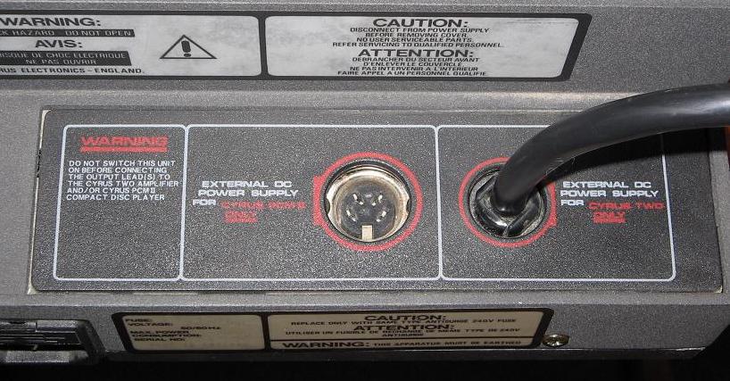

I reckon that PSX go for around £100 - £120 at the moment on Ebay. Prices on early Cyrus stuff has risen alot over the last 12 months. Didn't even fall at Christmas like it usually does. I've seen some CRAZY prices even for Cyrus 1's.
An Isoplat is at £47 + P&P at the moment on the 'Bay!!
The Cyrus amps were never really supposed to be for loads under 8 Ohms. Your Tannoys are 6 Ohms and a bigger supply would help with the extra current draw. The PSX puts out +/- 40V. The PSX transformer is 500VA with 60,000uF Slit foil caps.
For more details of the PSX,with pics, see this thread: http://www.diyaudio.com/forums/showthread.php?postid=1108437#post1108437
In my opinion, the PSX does not make a huge difference at normal listening levels. The bass does have more 'body' to it but it doesn't change the tonal balance of the amp in my system.
Imagine the difference between a Cyrus One and a Two. It just makes it a bit more like a Cyrus 'Two and a Half'. 😀

The PSX supply for the Cyrus Two is NOT regulated. It is basically a very simple design but with a huge transformer and lots of quality capacitance.
The left hand side of the PSX board is a regulated +/-18V supply intended for the Mission (Cyrus) PCMII CD player.
You could probably omit this section for your needs.
I would be happy to answer any further questions in this thread:Cyrus PSX Thread
Martin.
