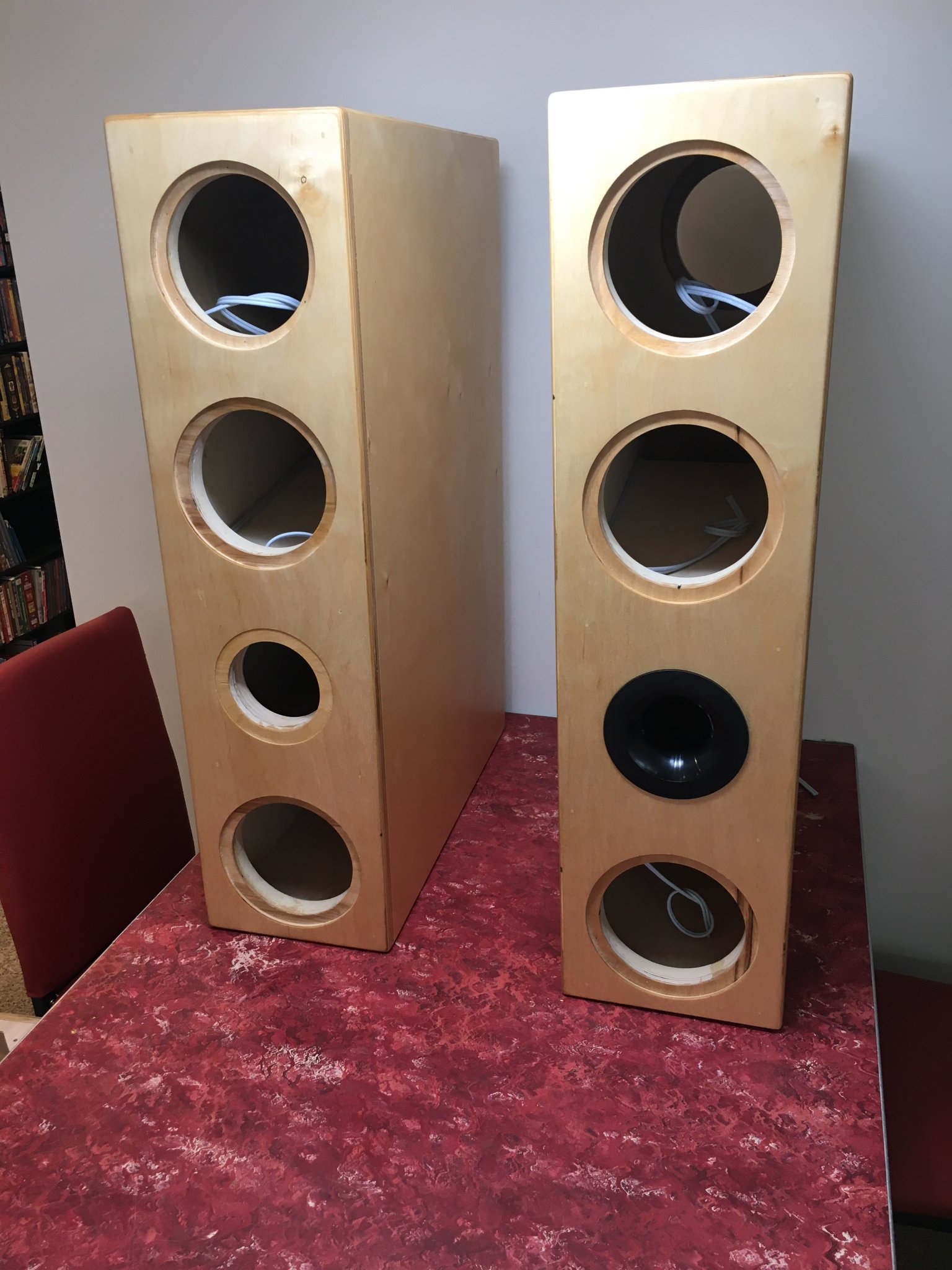

They have arrived at home. Here is what they look like with the wood epoxy fill on the interior baffle (to fix the reverse mounting, whoops!) So they have a tung oil finish on them. Next is wiring up the cables, teasing and installing the stuffing, putting the foam in the full-range tube, and mounting the drivers, making up the external crossover cables (with speakon's) and firing them up. Wow, what a process. I may have to put in some PTO at work to get them finished.

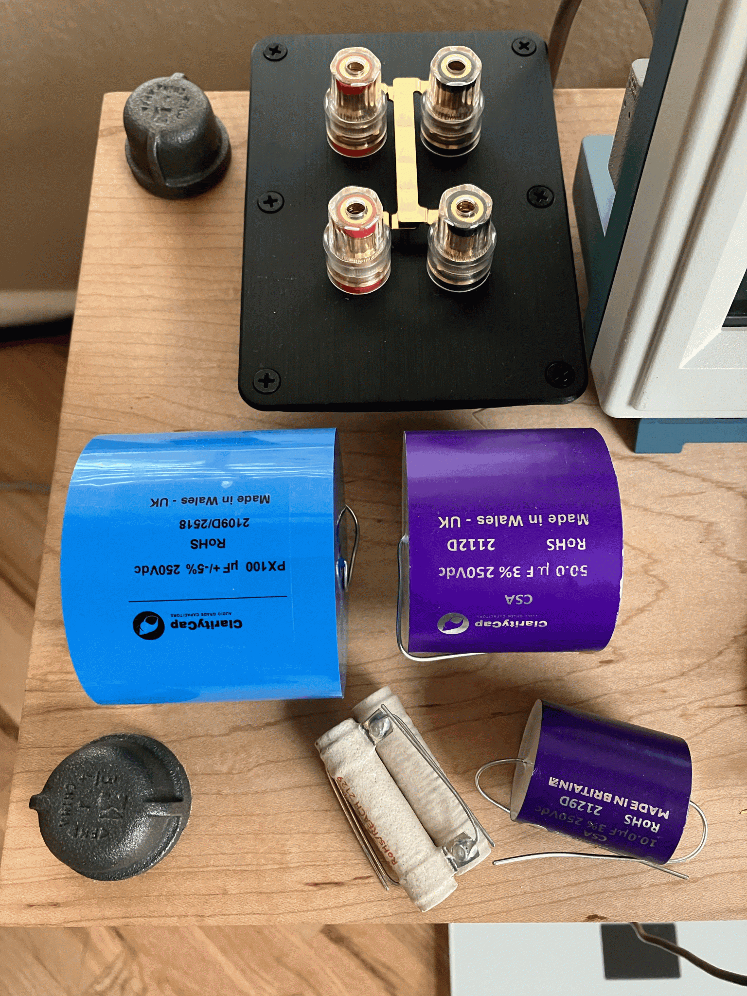

I'm looking at upgrading the x-overs. I've got all resistors and caps. Looking at the inductors but Solen is out of stock on the 8AWG and 10AWG inductors that have an equivalent DCR (0.15 Ohms). How much will the 12AWG (DCR = 0.22 Ohms) inductor throw things off. I'm unsure what the net result would be, if it would just be the Alpair10P gaining some output or
https://www.solen.ca/en/products/solen-perfect-lay-air-core-inductors-s122_0-2mh-12awg-inductor
Reaching out to Solen to see if they have an ETA but would like to use this as an opportunity to learn a little more about the interplay between crossovers and drivers.

Have you done any simulations that indicate a higher gauge wire inductor will give you the desired output increase from the Alpair 10P?

No simulations. Was harkening back to this post from Curt:
https://www.diyaudio.com/community/...lcyon-build-thread.349255/page-9#post-6381475
As well as from a (possibly ill-formed) understanding of circuits that a higher DCR in the coil to ground would enable more electron flow across the woofers. But then again, series x-overs are a bit of magic to me because it starts to treat the whole speaker (drivers + RLC's) as a whole circuit, taking a bit more analysis power (akin to some of my old homework problems with Kirchhoff's Law). Parallel makes it a bit easier due to a more reductionist approach.
I'll have to see what's out there to play with understand more.
