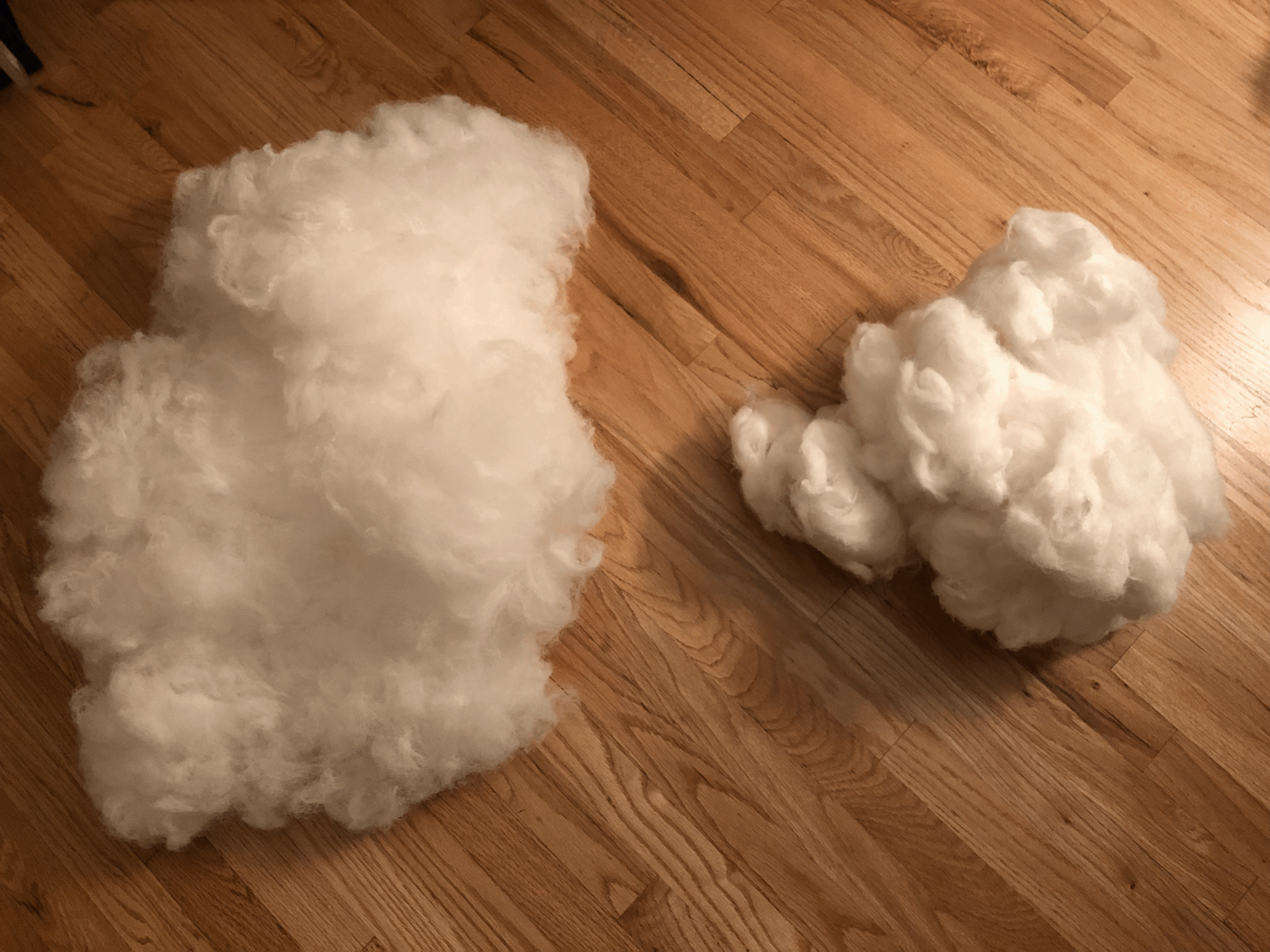

Revisiting my Halcyons to see what more I can squeeze out of them. Re-read everything here and decided the easiest was revisiting the stuffing as I didn't spend much time teasing it. Here's the after/before picture. 12 oz. in each pile but the left is the post-teasing and the right is the pre-teasing. I've got one speaker done and planning to finish the other speaker tomorrow.

possibly. I decided to revisit the stuffing in an attempt to experiment and find improvement. Re-reading the thread, dave pointed out that acoustuff needs some work to behave like polyfil (the fill utilized by Mr. Campbell). As cheap as polyfil is, I didn't feel like wasting what I had on hand so I pulled it and teased it.
I added another 6 oz. to the main chamber on the left speaker and still need to mirror on the right speaker. I've got a weird resonance on double bass in one recording that I'm attempting to determine if it is the tuning or a problem with the recording.
But, yes, after teasing, I've removed a couple of pounds and have found the bass to still have goodness.

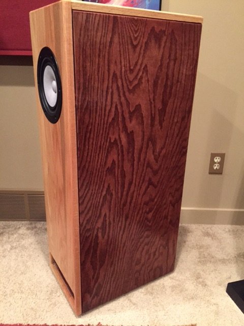

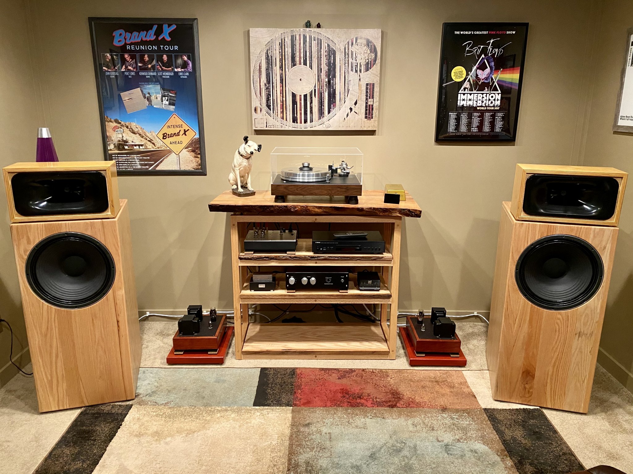

Good day, everyone ... new to this thread, so I hope you all don't mind me jumping in. After reading all I could find about this design, I've decided to build a pair. I am planning to build the cabinets myself, and not use a flat pack. I have built 4 sets of speakers so far, all from scratch. The first build were Frugelhorns, the second was a pair of Super Pensils (see attachment), the third was a pair of Decware ZOBs (didn't like them at all) and the fourth (and my current speakers) are a pair of big *** folded open baffles, with 15" drivers and SEOS horns with Radian drivers (101dB and they are awesome). Pic below (the horn cabs were built after the bottom cabinets ... they started out as a coaxial design):

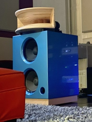

I see that the Mark Audio 10p drivers are backordered until April, so I thought I'd at least get started on the cabinets and get those all done in advance. My plan is to paint the cabinets blue and clear coat the base and baffle. I want to emulate the look of the speakers below.
