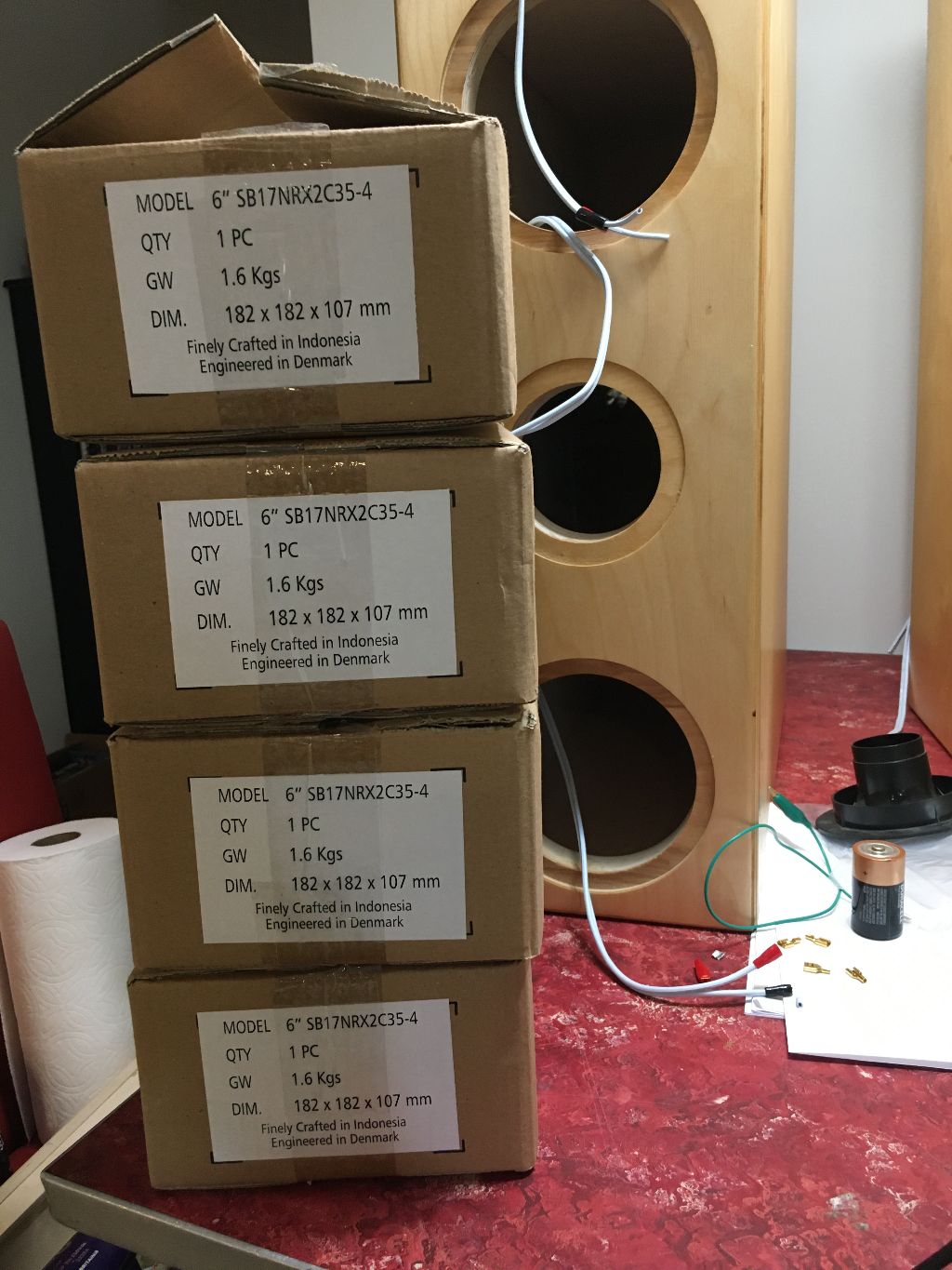

So I planned to do final wiring and perhaps even mounting of drivers today on my cabinets. However, true to the Murphy's law curse that this speaker build project has suffered, I discovered another problem. (Also it is Friday, the 13th!)
Quite by mistake I am sure, I was shipped the wrong woofer's. They are the 4-ohm version, which of course will not work with the crossover design. I have contacted my supplier to see if we can exchange as the woofers have never been mounted or connected to an amp. Some have not been opened. But we will see. So I can make wiring progress today, and perhaps even put in the foam for the A10p sonotube, but that will be it for now.
I am very encouraged by 6sX7's success and cannot wait to hear what these will sound like.
Hopefully I can get the right parts soon!

Well I put in the foam in the A10p sections today, and wired up all the speakon and faston connectors to all cables. So I guess it is on to teasing stuffing now while I wait for two things:
1- T-Nuts to attach the bottom crossover bases to the cabinets. They are due in on Tuesday
2- The correct SB Acoustic woofers. My supplier (Madisound) has been very good about exchanging them for the correct ones. They should also arrive next week.

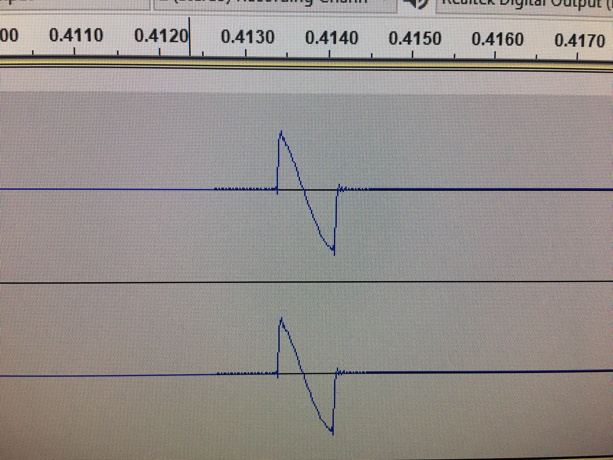

Now, on to the the shoutiness. What is + and what is - on these Alpairs? Since I was experiencing the shoutiness again I decided to revisit the polarity of the Alpairs relative to the woofers since I got confused in the assembly, never getting a confident feeling I got it right. A battery test on the x-over end is useless because, well, big blocking cap. So I swapped the polarity since I was already messing with the stuffing. Voices now seem more natural, the odd shoutiness, hardness has diminished. I'm not sure if I'm deluding myself, given psychoacoustics but something seems to have changed for the better. Would a suck out at 400Hz due to the Alpairs and the woofers being 180 degrees out of phase be the cause?
Image is dead center and very strong so I know the phasing between the Alpairs is correct. Yay me! (one thing right)
And I got plenty of bass so phasing between the woofers is correct. (two things right)
Thoughts on the Alpair polarity?
As as I soldered up my internal wires I tested the drivers with a 1.5 volt battery just to make sure. On my Alpair 10p, applying a positive battery terminal to the Red Terminal caused the speaker cone to move outward.
The same test on the SB woofers found that the larger of the two terminals on the woofers to be the positive one also.
There is also a test that can be done using the AudioTools app on an iPhone. It is called Signal Polarity and puts out an asymmetric waveform which it then reads using the iPhone microphone. It has worked well for me while testing already built speakers for polarity.
It also works well for testing system absolute polarity (a hotly debated topic). On a really good system I can hear the absolute polarity difference on a well recorded trumpet (which also has a asymmetrical waveform) so I always check for that. All my electronic designs guarantee absolute polarity. A positive going signal on the input results in a positive going signal on the output.

It's been referred to as inverse distortion cancellation. When the amp and speaker (or in some cases amp stages) each produce sufficient asymmetrical distortion then their relative polarity matters.
Yes that is one mechanism for sure. However if you listen to a live trumpet the positive peaks of the waveform coming out of the bell of the instrument are much higher in amplitude than the negative peaks. When the polarity is inverted, the opposite is true, and on some systems and ears it can be discerned.It's been referred to as inverse distortion cancellation. When the amp and speaker (or in some cases amp stages) each produce sufficient asymmetrical distortion then their relative polarity matters.
When I am editing vocal recordings, which I do a lot, I can also see this same asymmetry in human voice. It really does sound more natural when absolute polarity is preserved through the entire signal chain.
Thanks Dave BTW. Now that I've got a second on red being + it comes down to having the correct lead wired up to the drive from the x-over. That's where I got confused because I didn't make sure to tag the positive lead. The Madisound supplied wire doesn't make it obvious unless you pay close attention to the barely visible printing on the sheath. Good times.As as I soldered up my internal wires I tested the drivers with a 1.5 volt battery just to make sure. On my Alpair 10p, applying a positive battery terminal to the Red Terminal caused the speaker cone to move outward.
